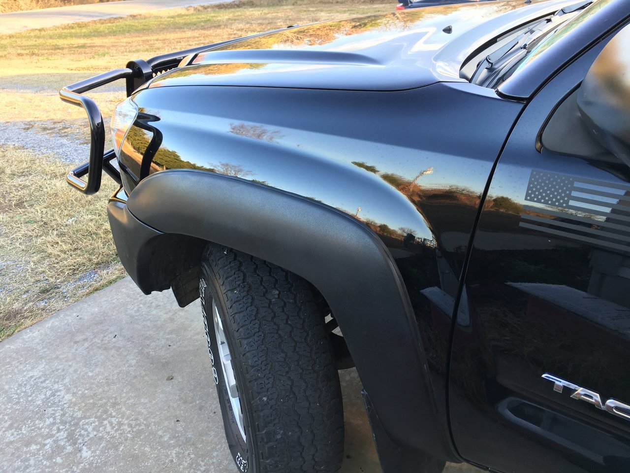

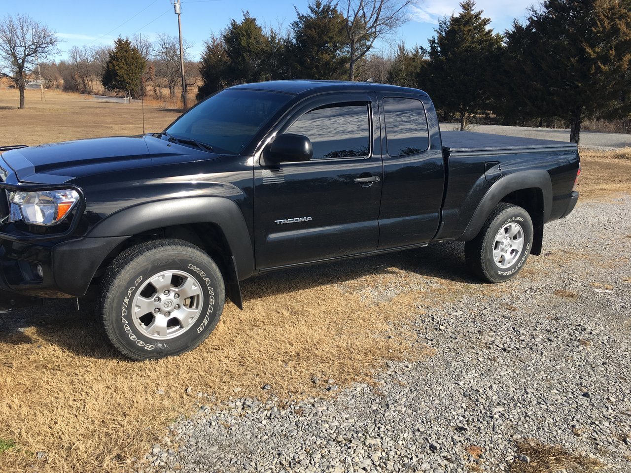

    I did mine using Rustoleum truck bed liner in a rattle can. I scuffed them with sand paper, sprayed them with primer, then a few coats of the liner. These are the only pics I have on my phone, but I can take some more in a bit if you would like.

    I took them off and did it in a weekend. I probably could have finished in a day, but wanted to take my time and get it right. I sprayed the primer and let it dry all day, then sprayed the liner and let it dry overnight and reinstalled on the truck the next afternoon.
    If you remove them, order some replacement clips, you will break most of them.
    NWClips 2005 Toyota Tacoma Fender Flare Clip Kit C44-49x4 https://www.amazon.com/dp/B01N6UNE70/ref=cm_sw_r_cp_api_kDkBAb3SW1PPG
    You can also order the rubber that goes along the edge, but I just glued mine back on.
    Genuine Toyota 53853-04040 Wheel Opening Pad https://www.amazon.com/dp/B00FWPHRBS/ref=cm_sw_r_cp_api_6EkBAb0HZKCZK

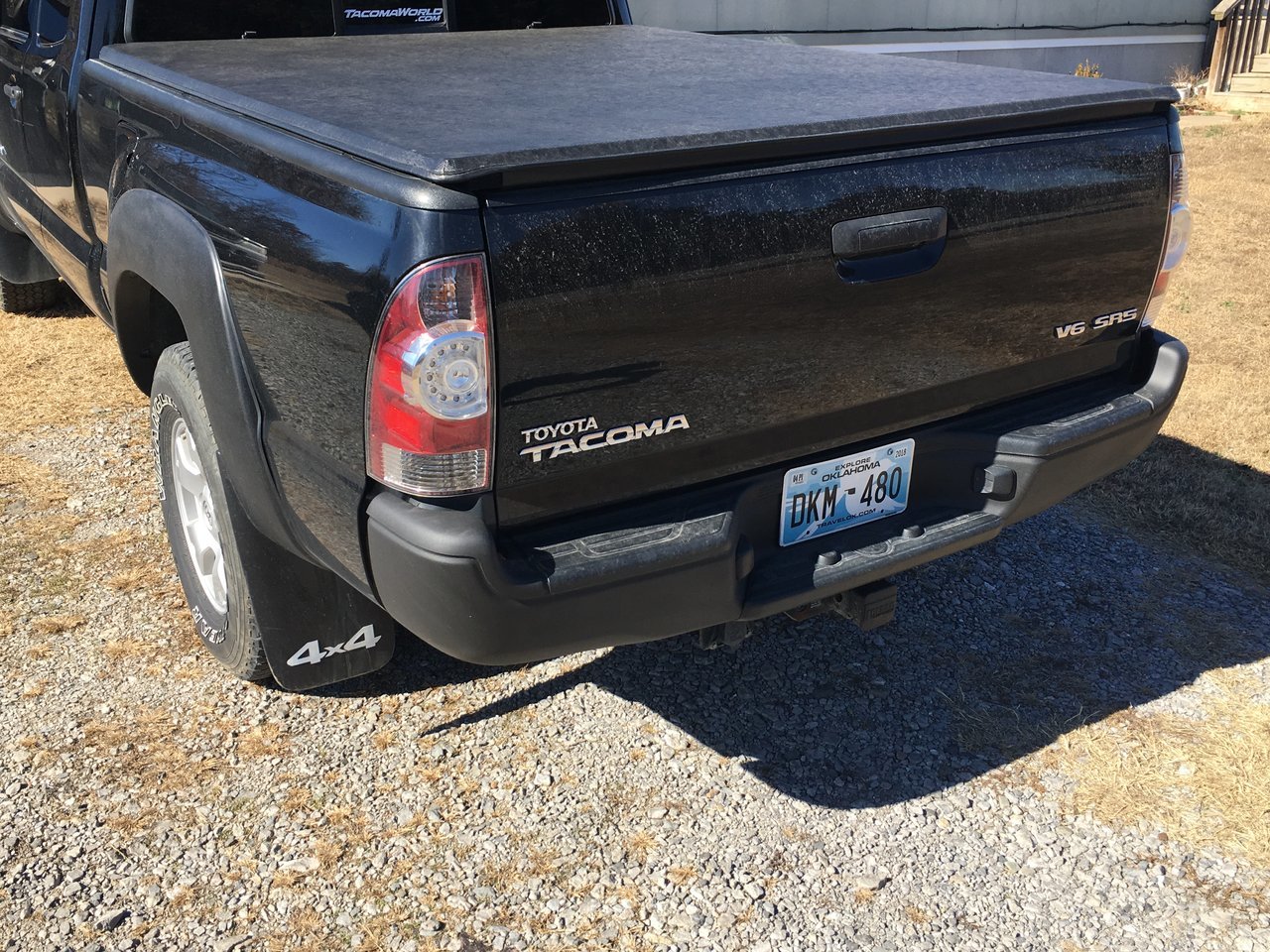

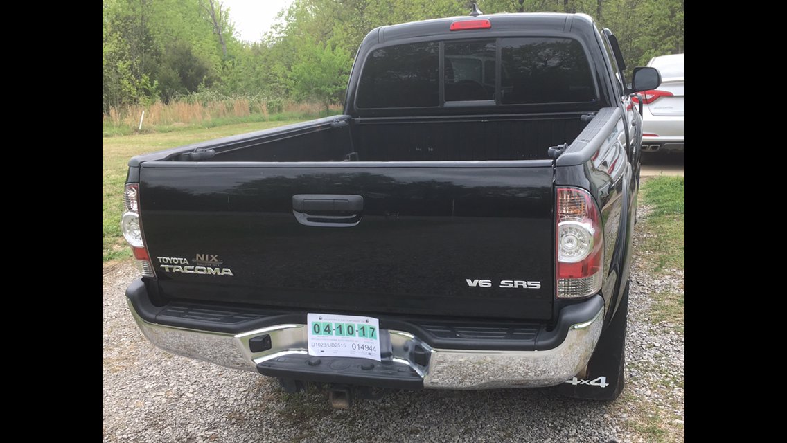

    I did my rear bumper to get rid of the chrome!
    Before:
    And after:

    They are holding up pretty well. There are some rock chips on the lower front edge of the rear ones but other that they still look pretty good
