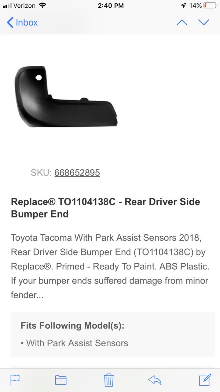

    Hello guys, not sure if theres already a thread about this, if there is please direct me, if not please discuss with me.

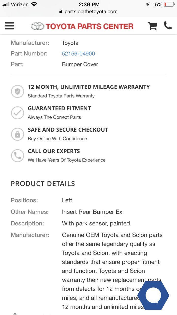

    So Im thinking of getting the replacement bumper cover from CARiD or go genuine with toyota’s. As far as I know, CariD state on their website “Primed” and Toyota sales man told me “I think its ready to paint.”
    My question is, does anyone who may have gone through this process know if I still need to primer it or just straight to painting base and clear after?

    Okay, that’s what i was thinking too. But I was also curious if I should spray adhesive first then prime then base... or just str8 to grey prime then base... But if these are prime and paint ready, I’ll prob go the scuff, prime, base, clear route... thanks btw.
