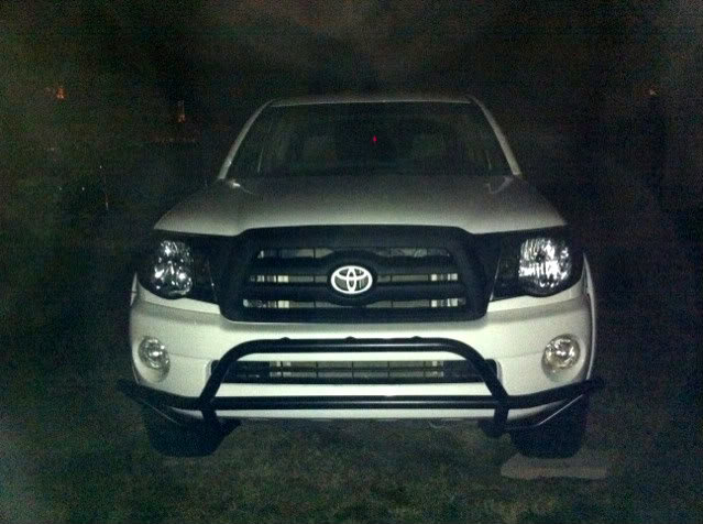

    Well the chrome grill on my 05 tacoma has started to bother me. I want to get it painted black, but do not know whether i should take it to a professional, or give it a go by myself with rattle cans. I have seen alot of people complain about chipping when using regular rattle cans. Have any of you had luck with rattle cans. Using an adhesion promoter, multiple primer coats, then multiple paint coats?
    Also, does the chrome need to come off totally, and what should i use to remove it (i do not have a pressure washer) will aircraft stripper work, or would that ruin the plastic?

    i did this project. i would recomend buying a new unpainted grille from partsgeek.com and the paint supplies from automotivetouchup.com. the paint won't adhere very well to the "chromed" surface even though it is not real chrome. automotive touchup.com has complete directions on what you need.....plastic adhesion promoter, primer, paint, clearcoat and all the other odds and ends sandpaper ect. the grille from parts geek comes in two pieces so you can prep and paint the shell without having to mask anything. when you are done you just mate the two pieces together and melt the tabs in the locked position with a solder iron or something similar.

    yeah, i am oing about it in the cheap and easy way, sanded down the "chrome" coating with 400 grit, did 3 coats of AP, three coats of primer, and waiting for the third coat of the dupli color color match to dry before adding the duplicolor clear coat, i will see how it hold up and if it doesnt i will buy a pre painted one. The worse that could happen is it starts to chip, and if so i can get another grill so far this stuff seems o look really good and match well. Just need to see how well it holds up:pray:
