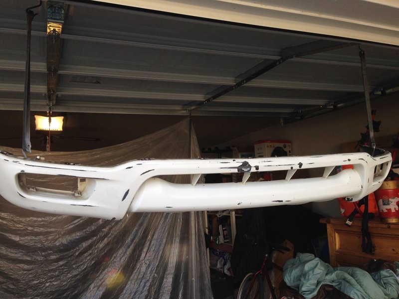

    I am a noob when it come to painting.
    I bought this white 01 bumper and want to color match it to my lunar mist. I just got done sanding it and noticed when I was sanding it paint was chipping off in certain areas (also there were parts chipped off when I bought it). My concerns are:
    1) If I prime, paint, and clear coat, will it flake off because the bottom layer is not adhered?
    2) Should I get all the paint off then sand, paint, and clear?
    Thanks!

    Sand Any chips until smooth with the rest. If you're going to primer it 180 grit is fine. Block primer afterwards then paint and clear it.

    Yeah I was using 220 grit to get the clear and paint off. So I shouldn't be worried about the original paint not adhering to the bumper, it just got chipped?

    No it should be fine unless the original paint is defective and coming up. But more than likely just chipped off from being hit by rocks or something. Just make sure to feather edge and it should be good to go.

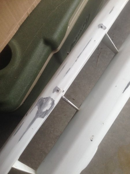

    Alright great thank you! I seems sturdy else where. I'll probably sand it one more time and make sure all chips are smooth.
    With that. Do I have to fill in the chips with something to make it smooth with the paint? I don't feel like 3 coats of primer will make everything smooth

    If you're using a good filler primer that should be enough. You could wipe some putty glaze and block it to make sure everything is smooth if you wanted.

    Paint keeps flicking off when I sand it. Should I just strip it all off?

    Yeah just hit it with some 80 grit then 180 for primer
