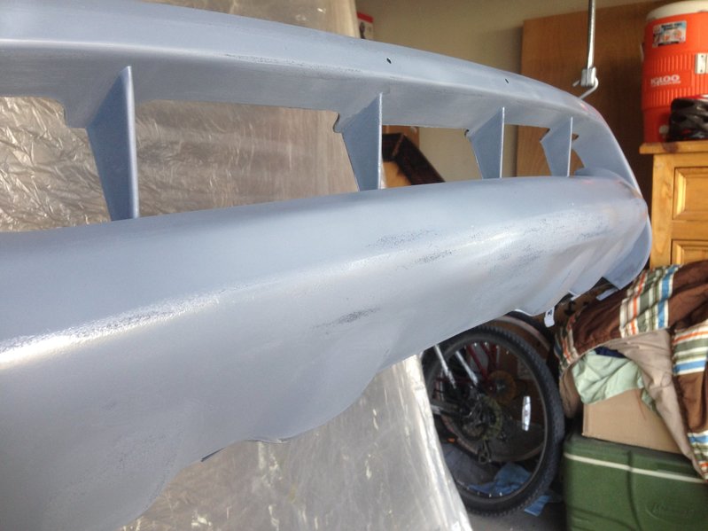

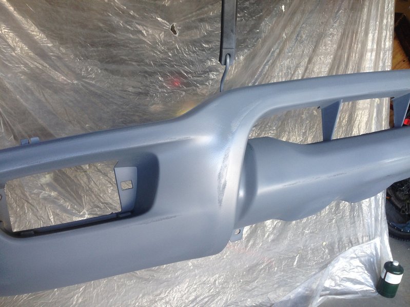

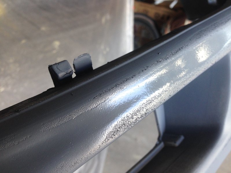

    Well I premiered it. Where I went down to bare plastic you can tell a difference. Should I sand with a larger grit sand paper to make it smooth or what?

  16. Nov 4, 2015 at 3:22 PM
    #36
    T4RFTMFW
    T4RFTMFW Well-Known Member
    Jul 23, 2014
    #134525
    69,755
    It didn't look like that before you primed?
    You need to smooth out those spots. If they're high spots use sandpaper, if they aren't, use filler.

    Here is what it looked like before. The spots showing in with the primer are the black spots below. It felt smooth but I guess the plastic got eaten by the sandpaper. So since they are lower than the accompanying paint, fill it with (what?) or sand down the roughed up bits then fill it?

    Fill with fiberglass body filler or similar flexible filler.
    Weren't you just taking paint off the bumper? Who the hell said to use 80 grit?
