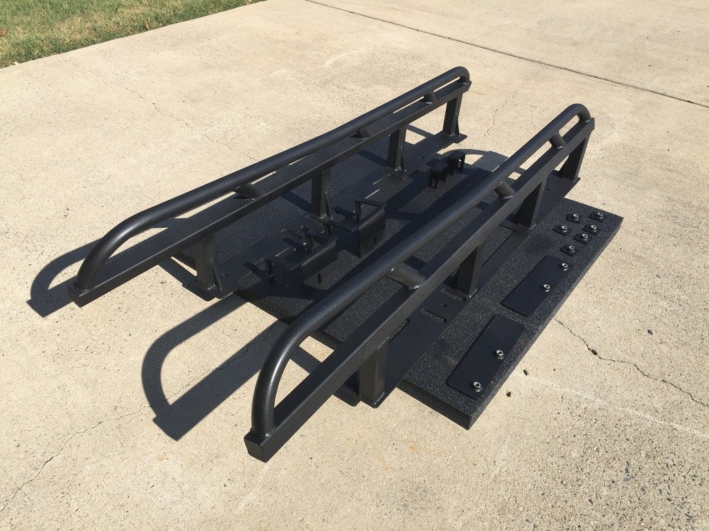

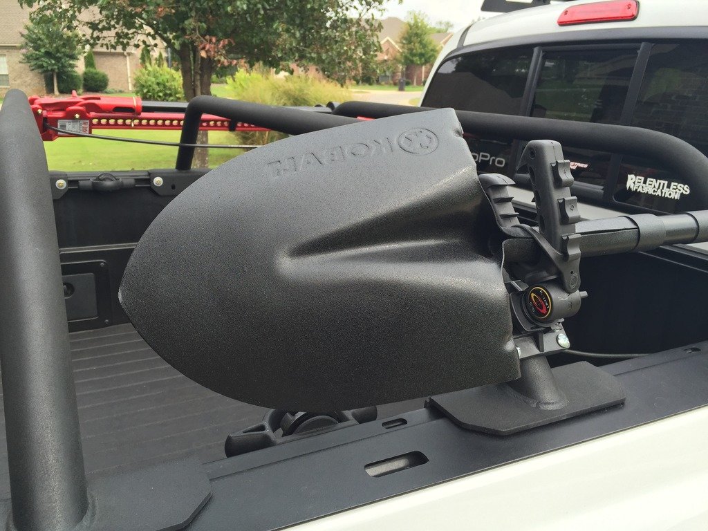

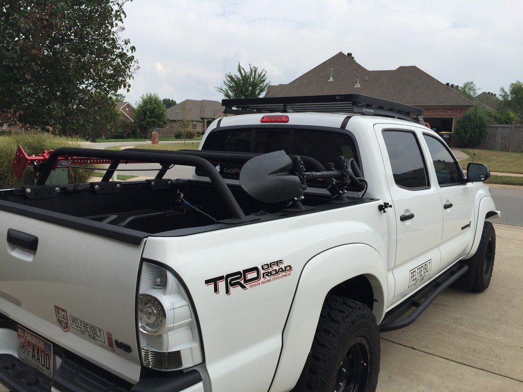

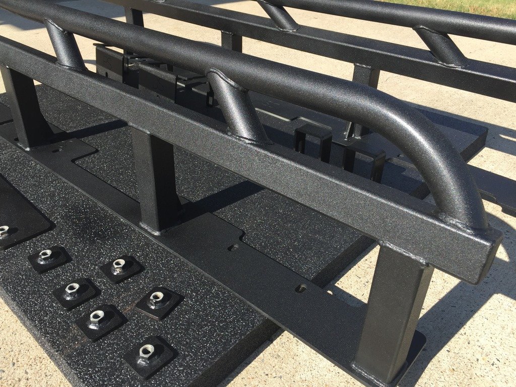

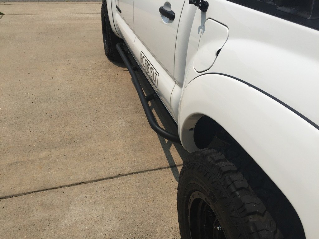

    For my sliders I used a product called Speedliner. This won't help you much since you have to be a distributor to buy it. We bought into the company years back when we were painting. The thing I like about the product is it is "basically" the same a Rhino Liner with the ability to spray it out of a hopper gun (for bed liners) or a HVLP so I can control the texture. The over the counter bedliner stuff you buy at AutoZone generally won't last and is not nearly as durable.
    Here are the end results on my sliders

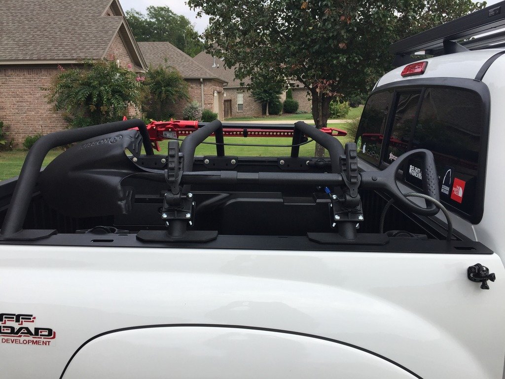

    Did the same for my Relentless Fab bars on the bed
    And even the shovel mounted on the bars

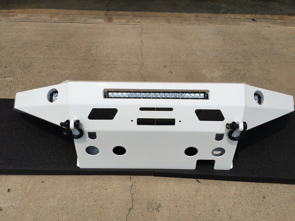

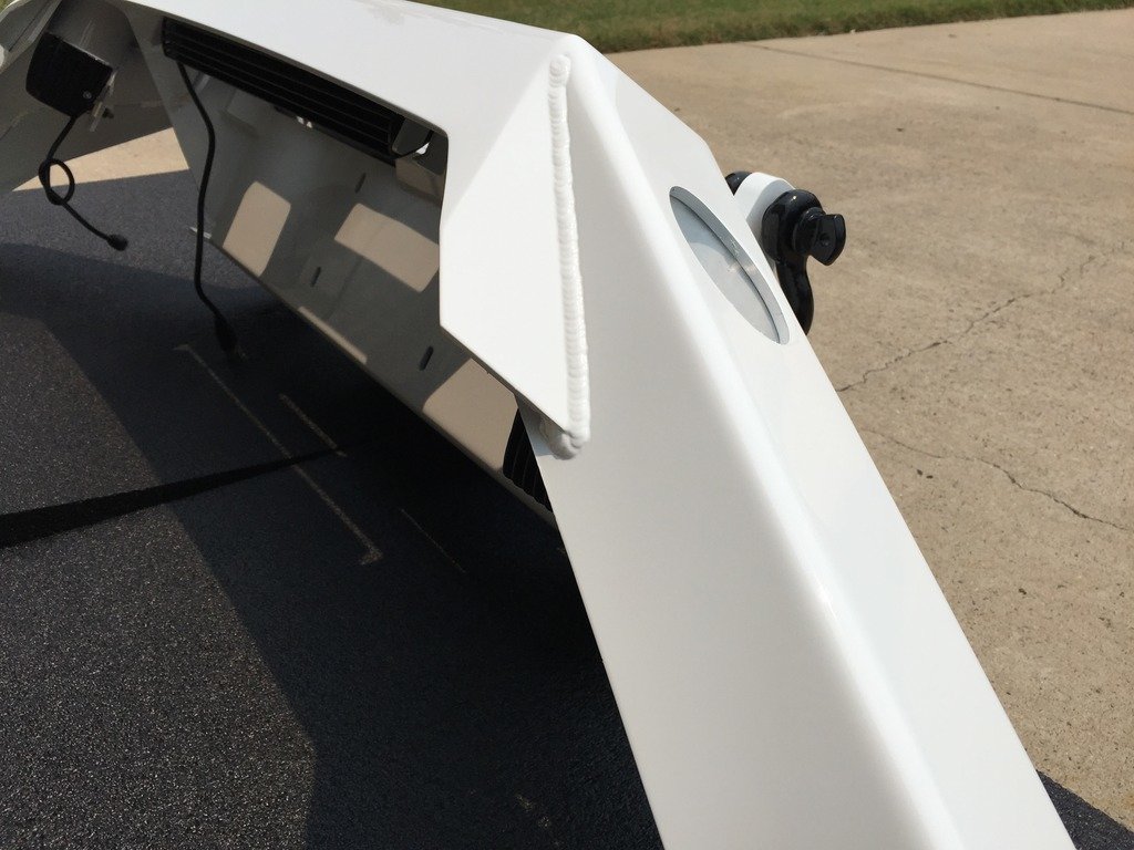

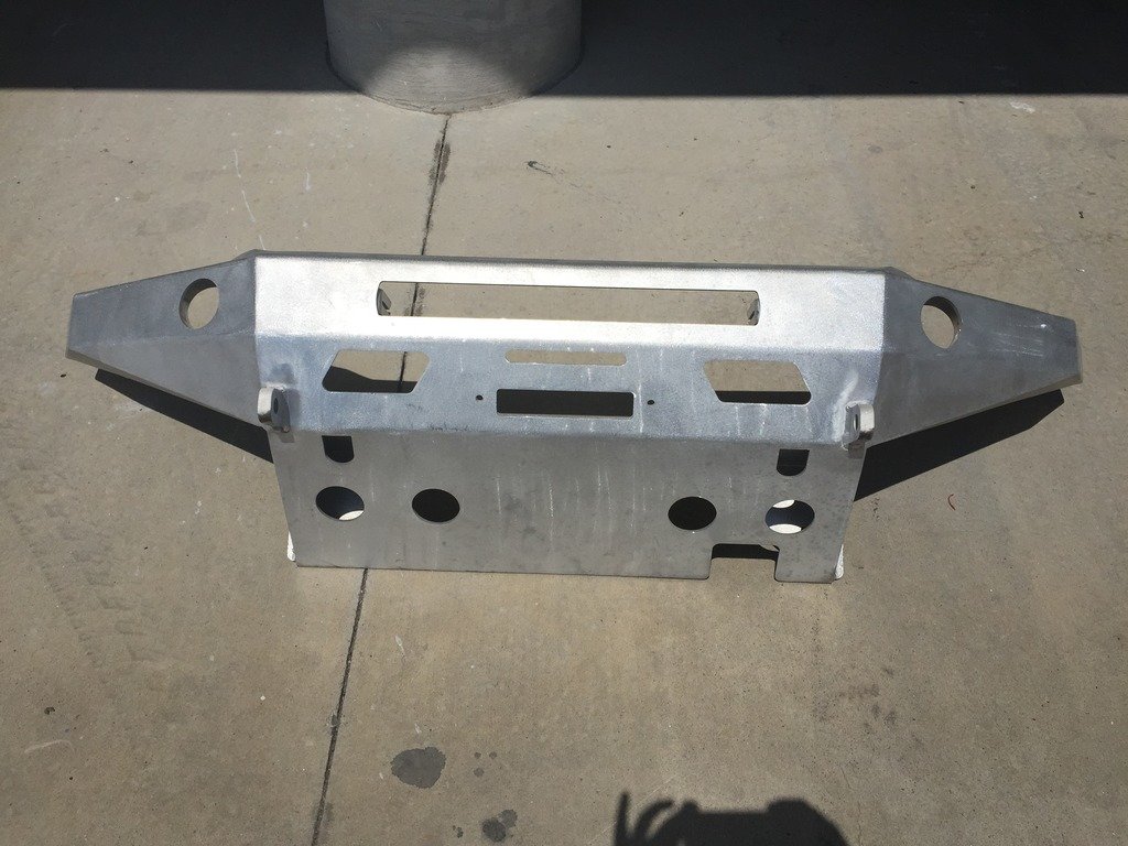

    The front bumper was a different story. I've got too much invested in it so I had it professionally painted.
    Aluminum Pelfreybilt plate bumper
    So really in the end it comes down to how durable you want everything to be. You can rattle can your sliders with flat black and if you get a scuff on them it's easy to touch up. But... it won't have any texture. For the rear bumper a rattle can was fine with me but I also plan on replacing it with a Pelfreybilt rear bumper so that was something I didn't want to spend a lot of money on having it professionally painted. My front bumper on the other hand was a different story. I wanted it to match the truck perfectly and it came out just like I wanted. And thanks to this thread I get to whore out pictures of my truck :woot:
