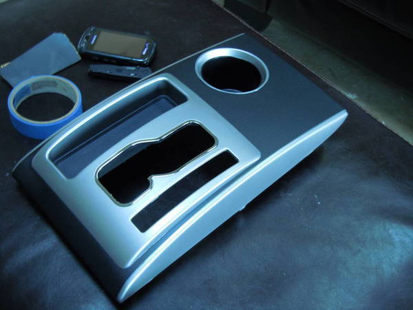

    Just started to paint my siler plastic, Im doing the shifter cover first. Then see how it turns out then ganna do the stereo. But Im using SEM Color COat Satin Black.. and this stuff works great! I got my first coat on, and only prep needed is wash and light sand.... :D
    Im getting pics too.

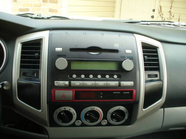

    did mine a little while back and i love it. i did a little bit of red trimming to go along with the TRD theme. it looks pink in the picture but very much red in person. also did the shift console and the chrome trim around the shifter i did red also. something to think consider

    and of course forgot the pic.....

    Finally got it done! been working on it all day! But Im pretty happy with the way it turned out. Theres miner imperfections but not bad....
    The center console cover came out the nicest..
    Let me know what you think..... :)
    Finished it all, and all back together....

    Thanks! yeah it was a PITA taping off everything, theres some imperfections I might fix today, but otherwise it came out pretty good... :)
    Now I just need a ipod Interface, and I will be happy.
