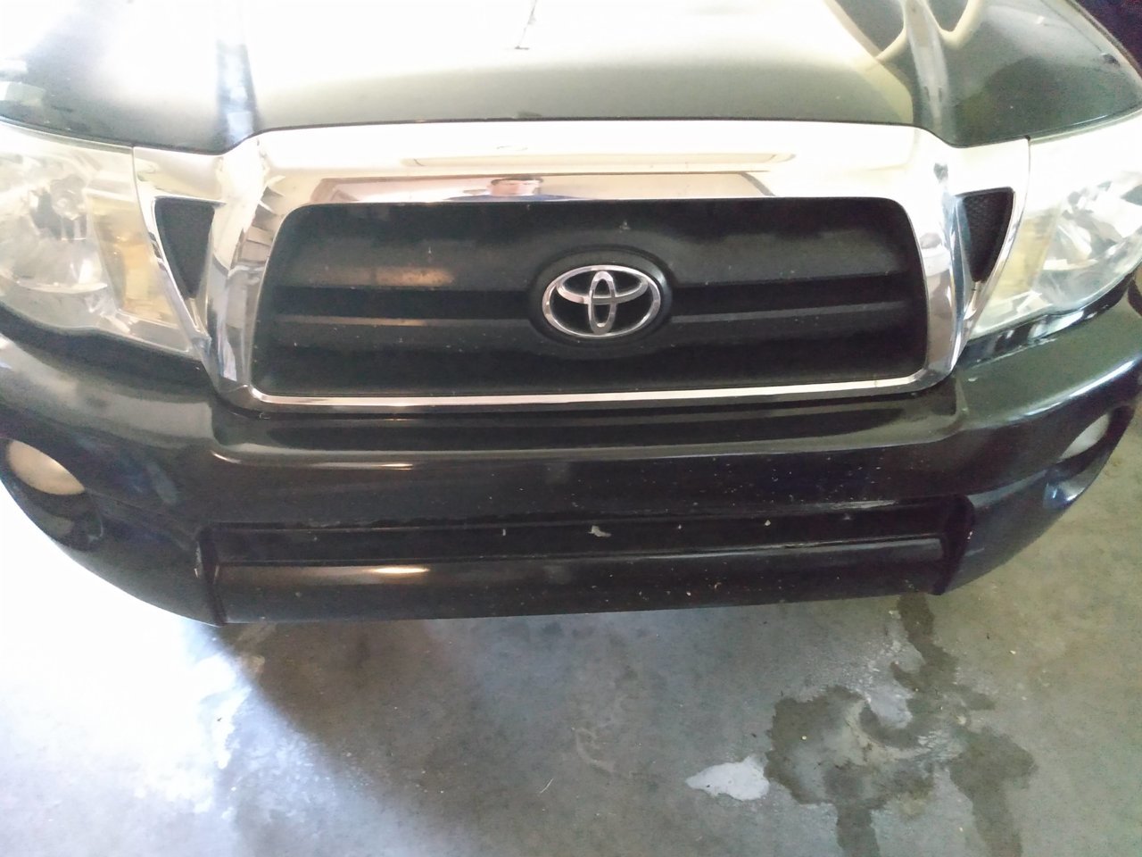

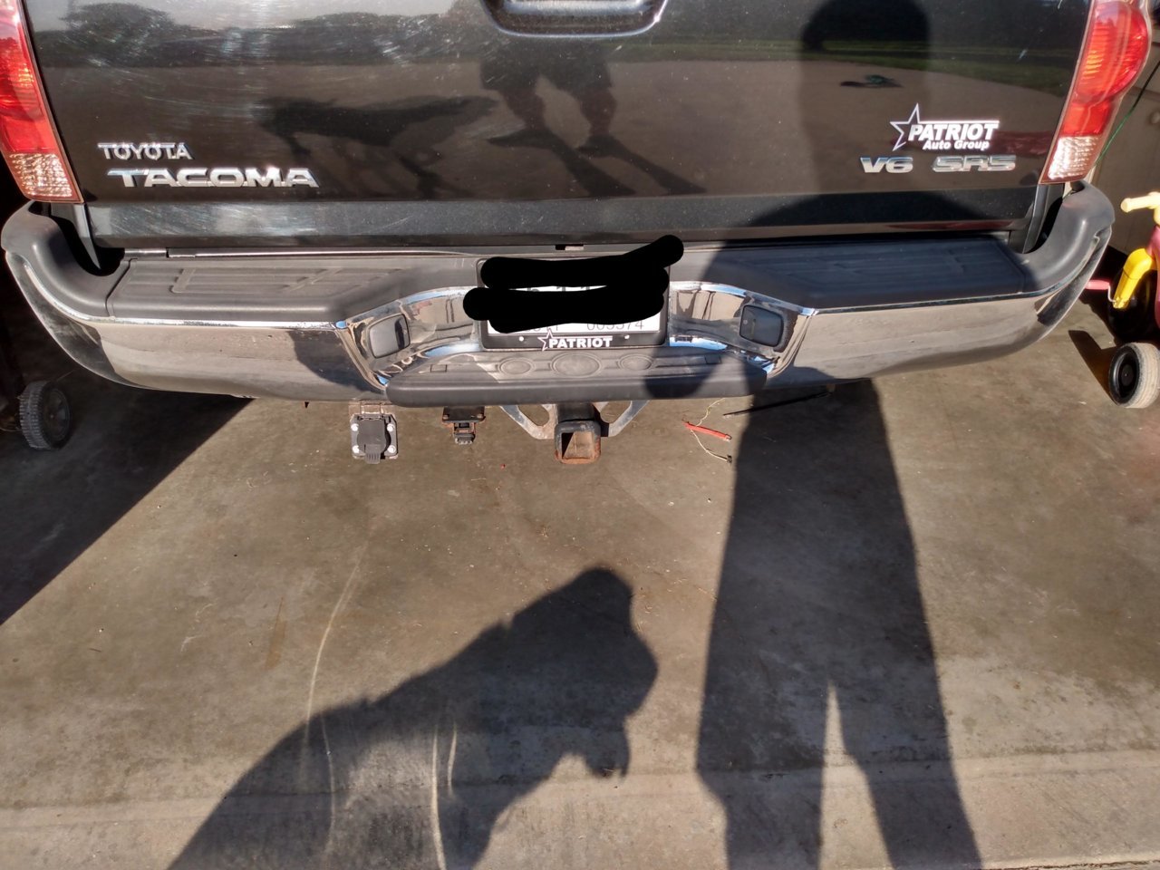

    I have a Chrome Grill and Rear Bumper. I'd trade for the same grill and bumper in BSP.2005 Chrome Grill.jpg 2005 Chrome Bumper.jpg
