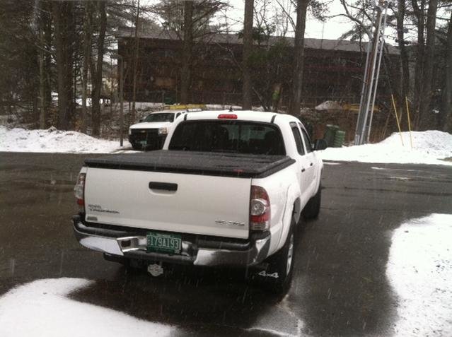

    Its an SR5 with the convenience package. Sorry for crappy pics. Only ones I have on this computer posted to show another member the tonneau
