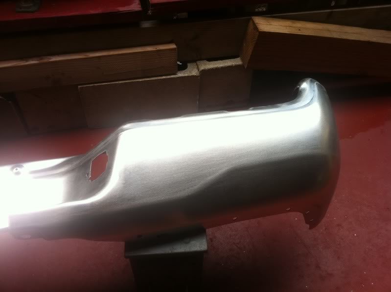

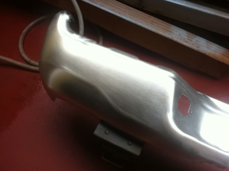

    *UPDATE*
    sanded it down pretty well(I think haha). pics doesn't say much but the bumper is in the dull side. almost a stainless steel sink look. what do you guys think, is this good enough to prep for painting?

    How well is it holding up?

    I finished it 2 weeks ago. ain't no factory paint job, but came out just as I wanted to. little shadow here and there but only noticeble up close. so far holding up strong
