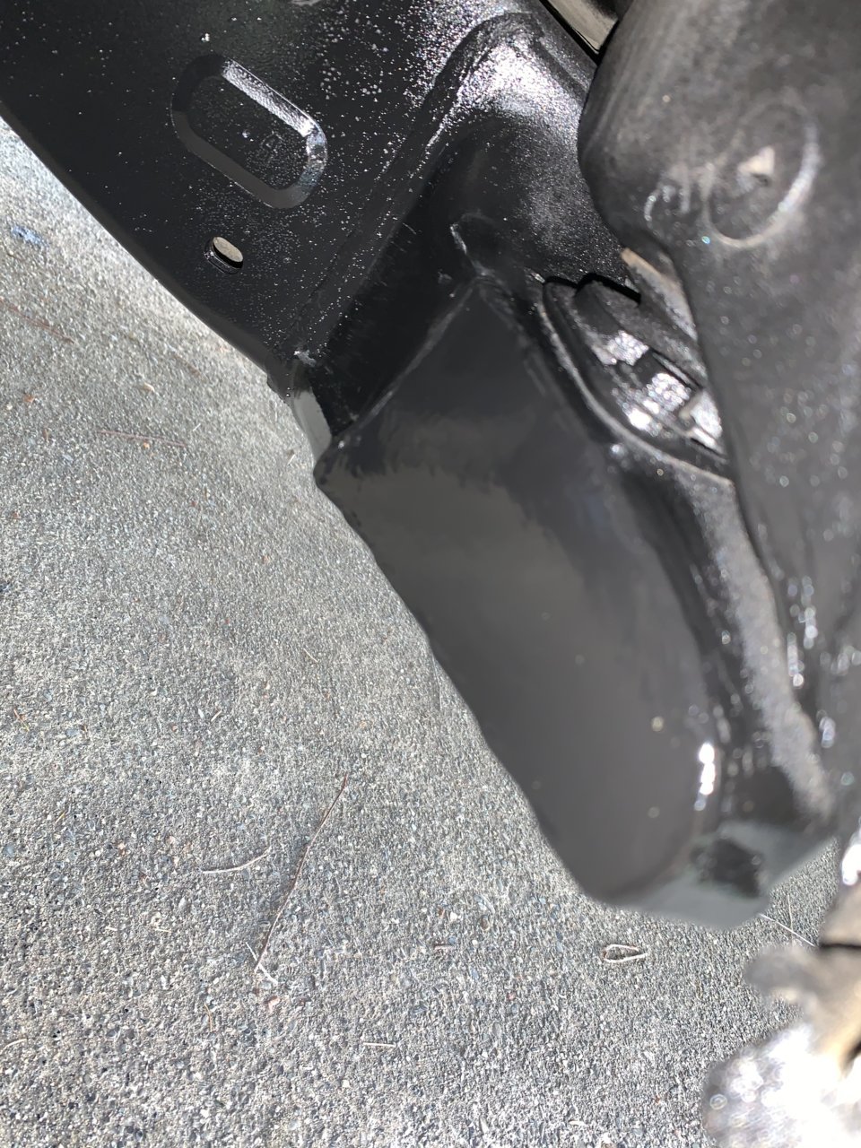

    So I just got My CMC and was wondering what everyone else did to paint the inside of the plate. I ended up just spraying a ton of paint in there to hope it covers all the bare metal, just don’t want to have to re do it due to rust down the road?

    That's what I do to every CMC I've done so far, it's really your only option. You can't paint it beforehand because it'll burn off and/or contaminate the weld. There are usually enough access points/holes in the cab mount to get a fair amount of coverage of the inside. I've redone some CMCs and after cutting off the previous work you can tell they didn't even bother trying. Surface on the inside of the plate will turn into a more serious problem if you don't at least try to mitigate it.

    Yea I took some pictures to be able to see in and it looks like I pretty much covered it. I was just curious what others were doing. No one ever talks about it but seems spraying the life out of it is what everyone else is trying to do.
