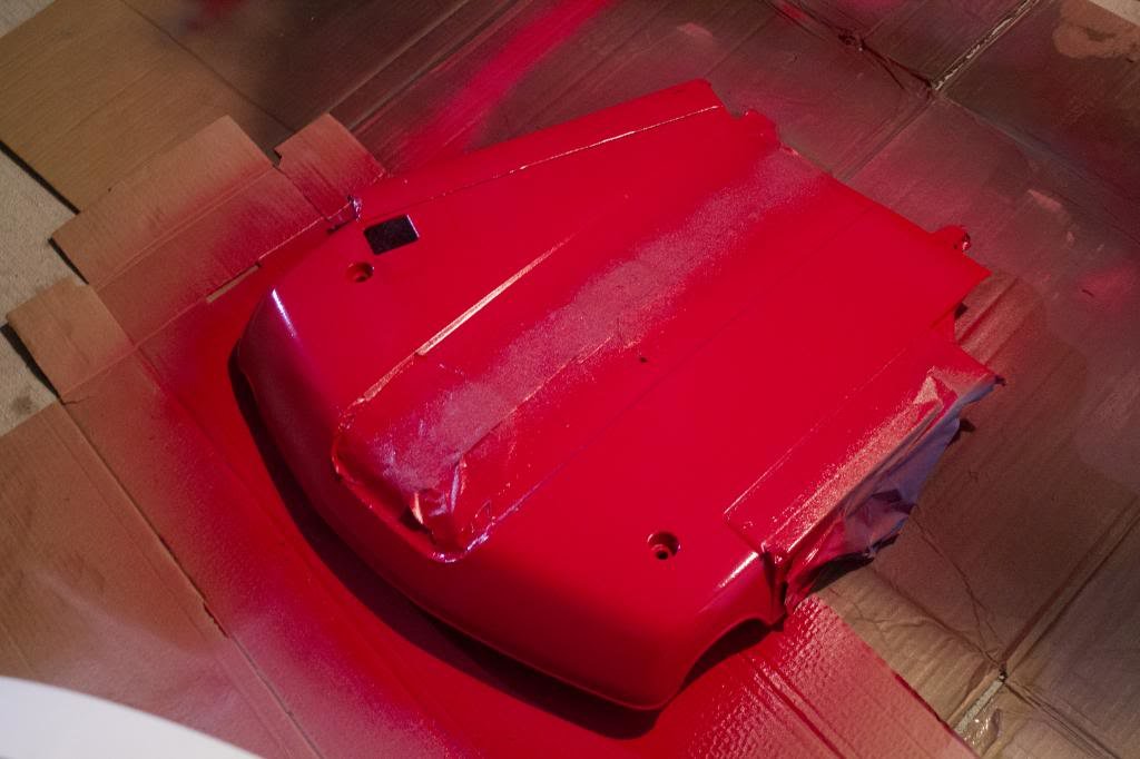

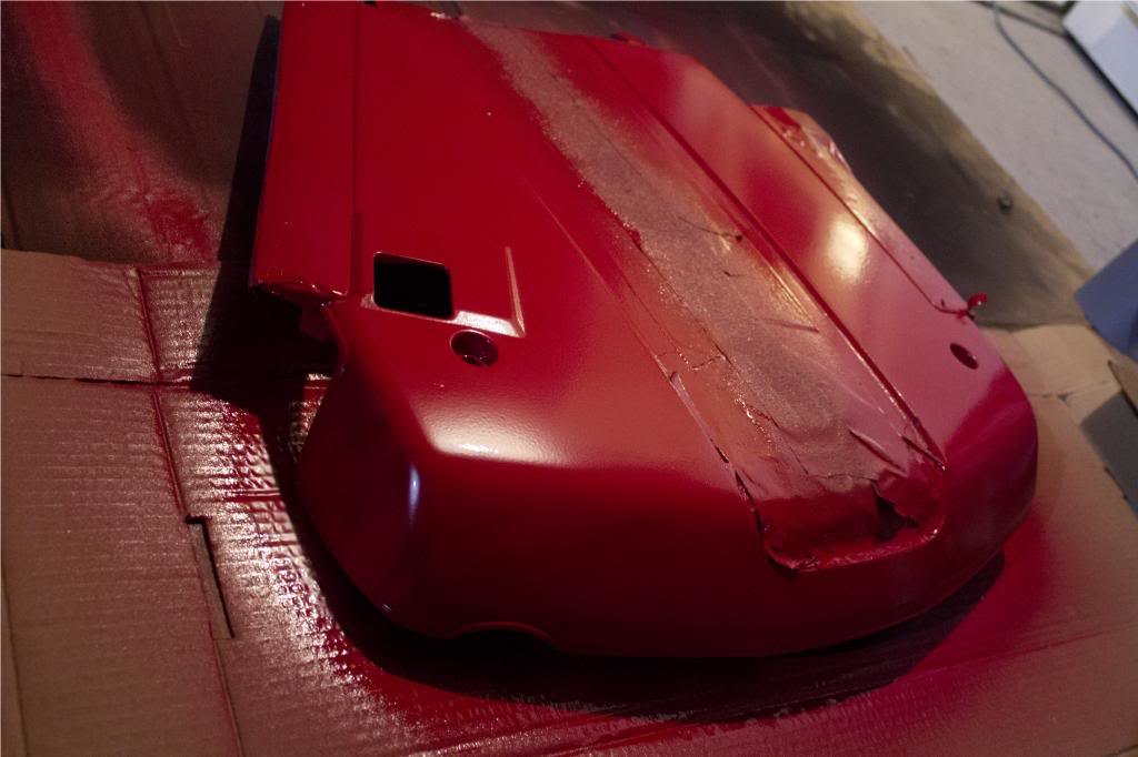

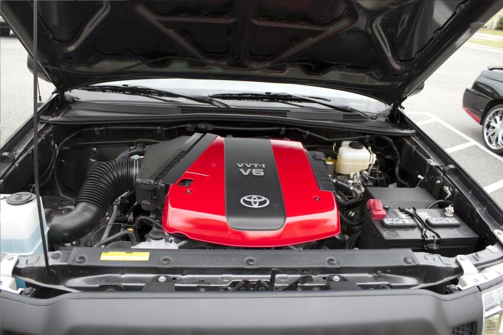

    So, I've seen a few people do this and paint match there trucks. I really like the look, but since my truck is so dark, I Went with red after seeing the same color truck as mine do it with red.

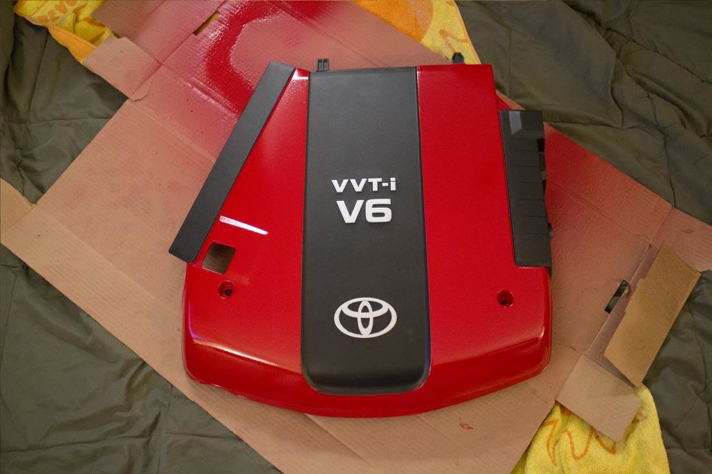

    Time to get started

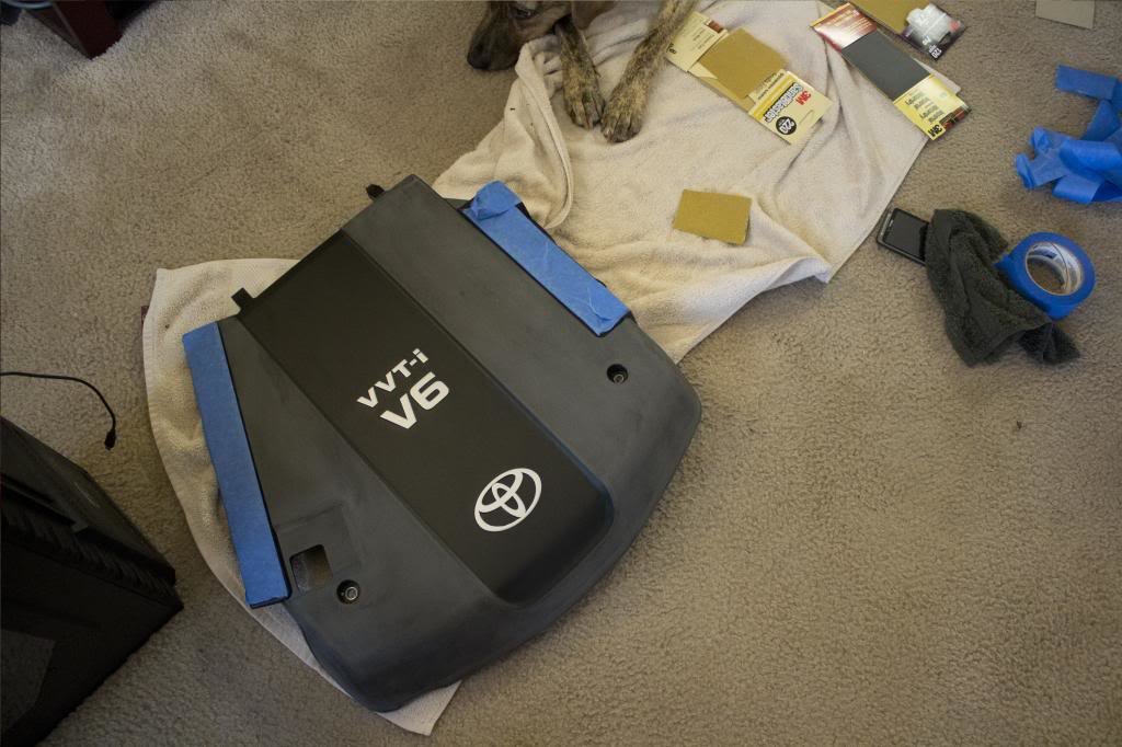

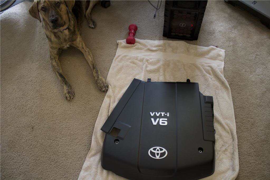

    First I removed the cover, and washed with dish soap and warm water. (as you always should)
    Jax, My dog, decided to help me...

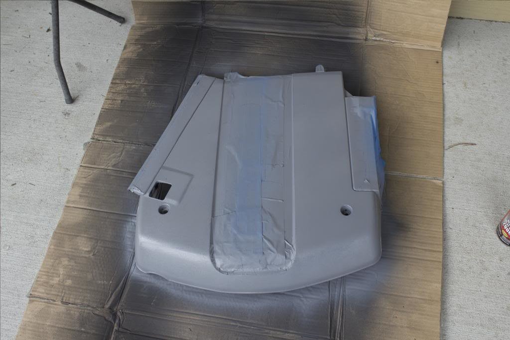

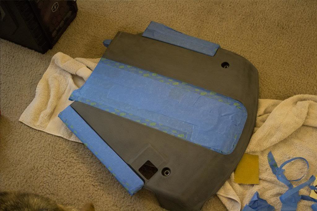

    Taped off the sections I didn't want to sand, and then sanded the rest with 120 grit.
    Finished taping everything and ready for the primer

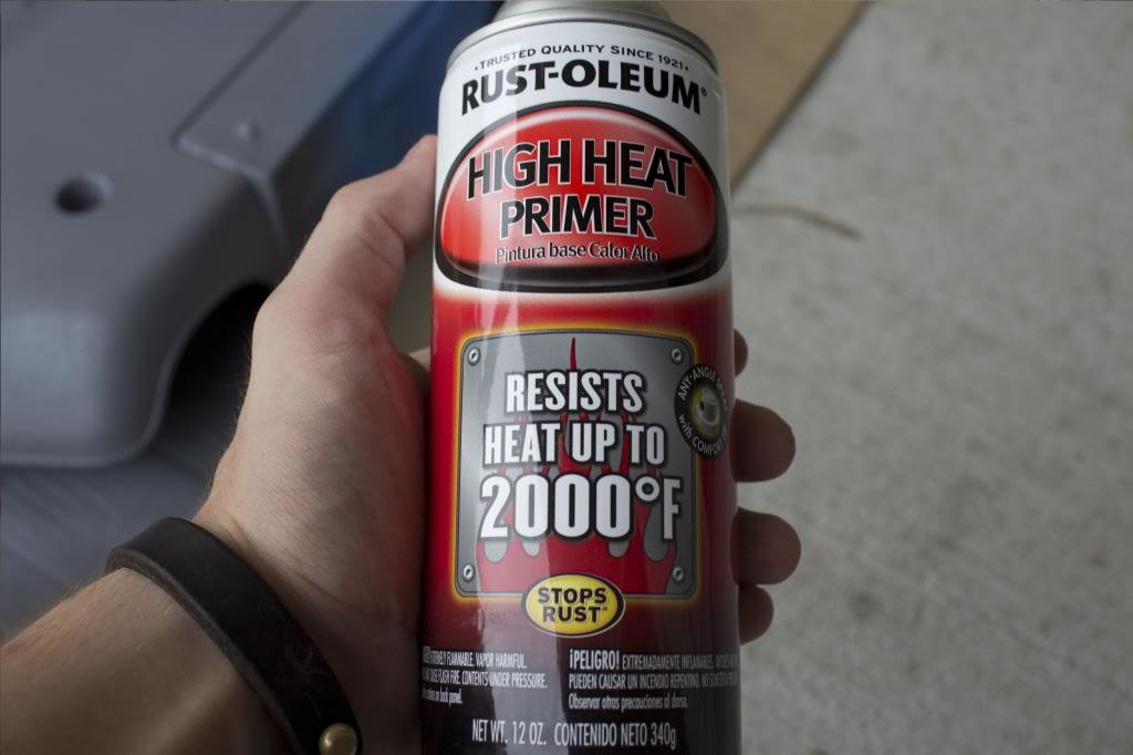

    First coat of primer
    My dog was chewing on my tape

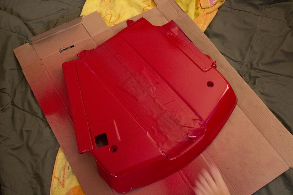

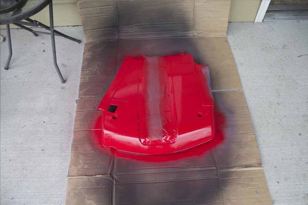

    Started on red!
    Drying
    Time to clean house! Lookin boss!

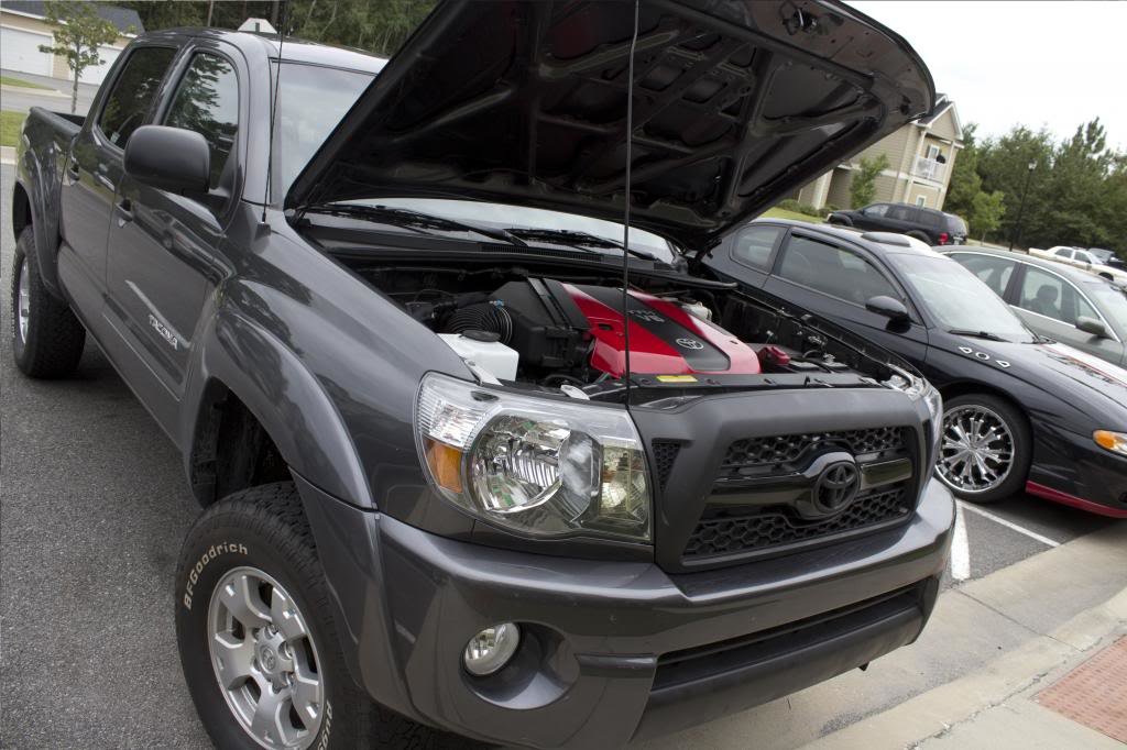

    FINISHED!
    Took me about 2 days with drying times and all. I almost regret sanding due to the rough look I got a few times. In between coats I used 220 grit. Totaly worth the time. 15$ worth of paint and sand paper.

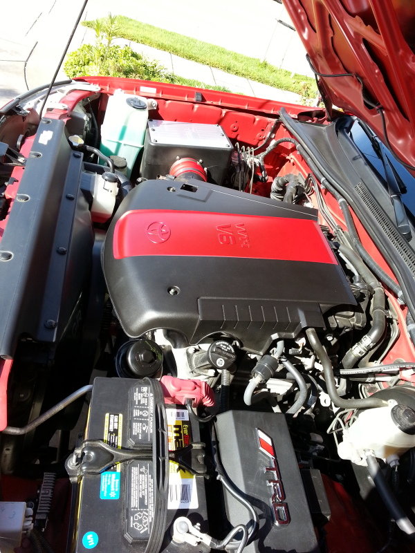

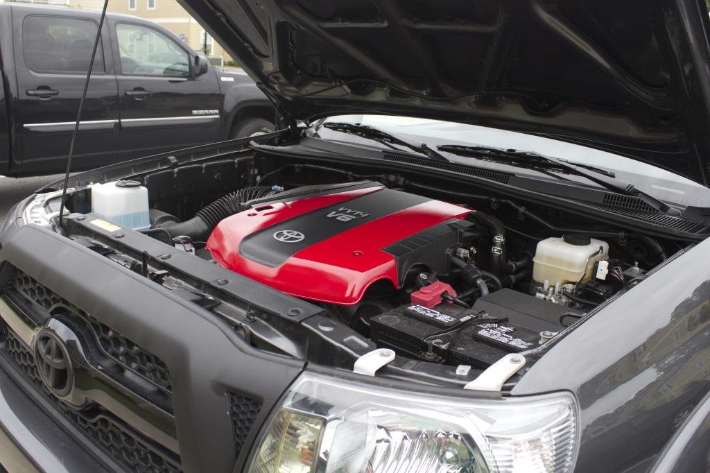

    painted mine today.
    wet sand, primer, chrome, clear and then plasti dip metalizer.
    this is my first crack at it. i think i may go with some different colors later on.

    That does look pretty cool. I really like the red...but I would suggest wet sanding with 1000 grit between coats. You'll get a much smoother final coat

    I painted the center of mine instead of the outside.
    Wish I did more prep work on it though because it's very fragile (easy to scratch)... But I was kinda drunk.

    Man, You did a great paint job on the Grey. I even like that Extra stripe that you've added. The reason I chose red was because, With my truck being the dark Mag Grey, I felt that it really need a high contrast color to set it off (other than chrome) and by adding the red to the Engine Cover, It makes it stand out, but not so "In your Face." To be honest, i feel that the grey makes it too dark. There is no contrast, but never the less, I think it looks good. Also seen some with bright blue, and that looks nice too!

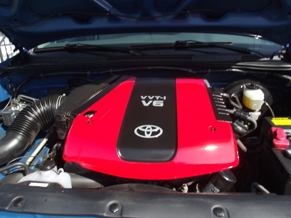

    I liked the red cover so much.....
    They say, imitation is the best form of flattery..... :)
