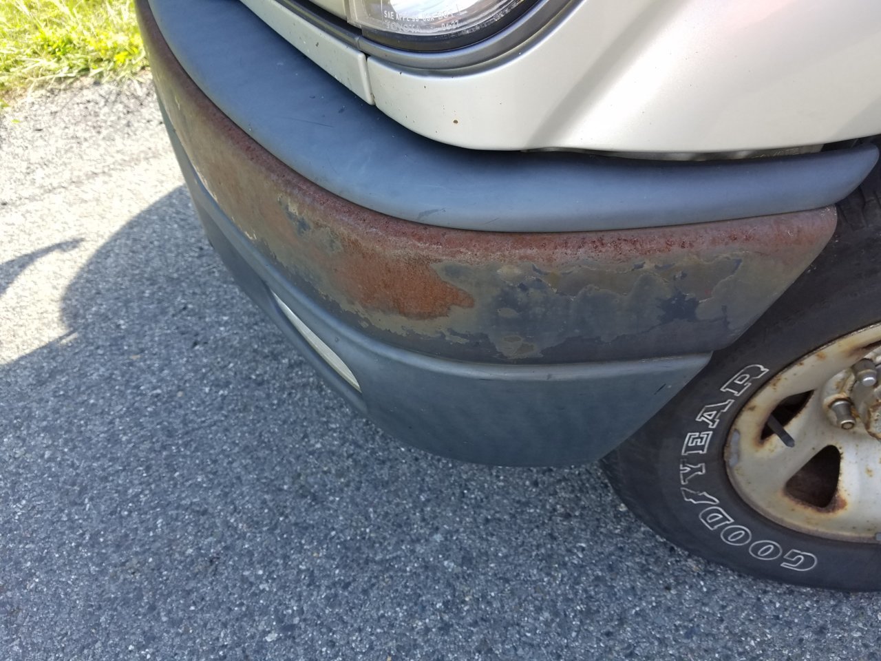

    Going to the hardware store soon too pick up some other stuff I need for my truck, Plastidip, and some Velcro. Considering painting my front and back bumpers black but not sure how to go about it, bed liner them like my grille and 1/3 of my hood or just go with a normal spray paint scuff the bumper before etc?
    Anyone who has done it let me know

    Sounds good. I’ll prob do with bedliner. The color keyed bumper, and the silver flaking off to expose black plastic.

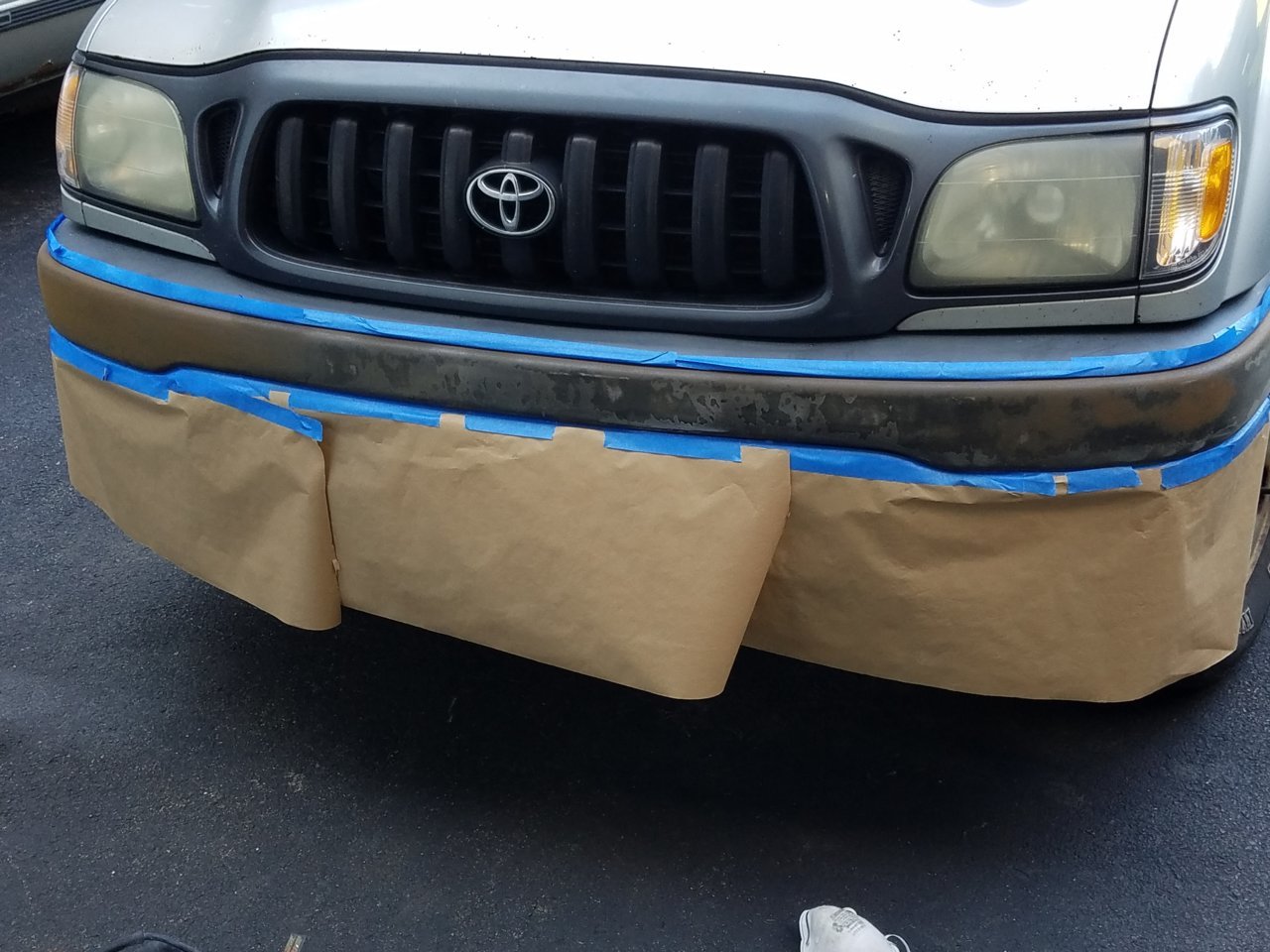

    Over the years they developed surface rust. I scuffed them down with a green scuff pad, taped off the plastic, and painted them with Rustoleum bedliner.
    That bedliner was the best $29 I spent on my truck. When the Rustoleum dried I used some Meguires plastic restorer on the plastic trim.
    It cleaned up my truck for cheap $$.
