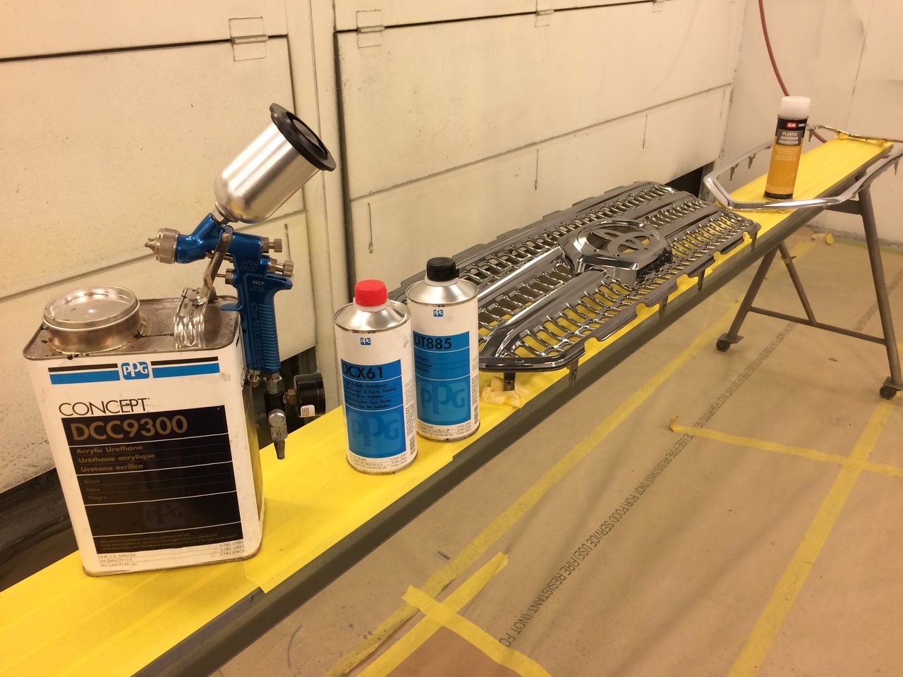

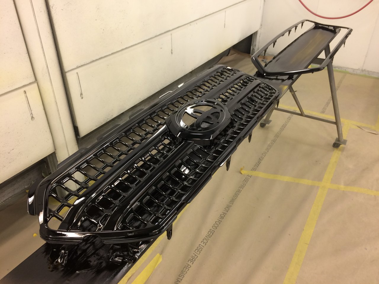

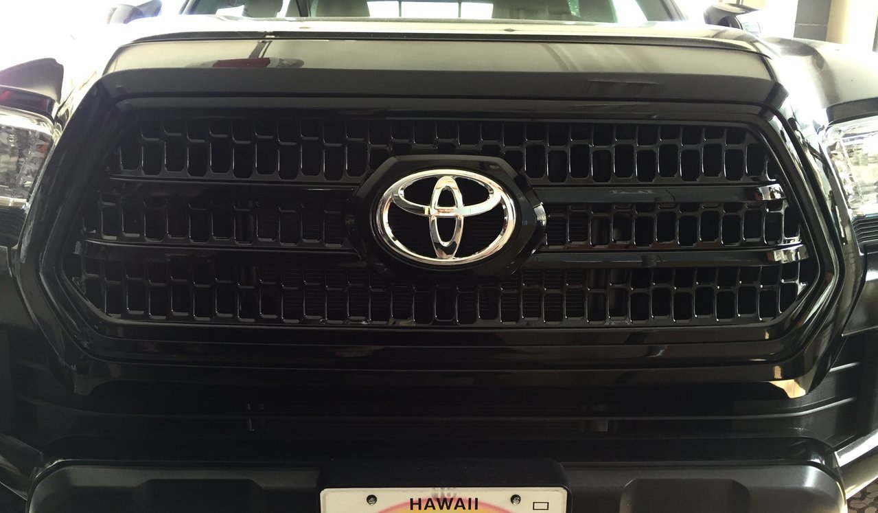

    Just did my son's grill with PPG single stage gloss black. Sprayed an adhesion promoter first and then two coats of black. Looks really good and way better than plasti dip IMO. Aloha

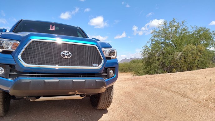

    Does someone need a OEM 2017 Off Road Grill? I have a spare.
    I installed this one about a year ago.

    ho brah - das da one... thanks for the details and great pictures. shoots
