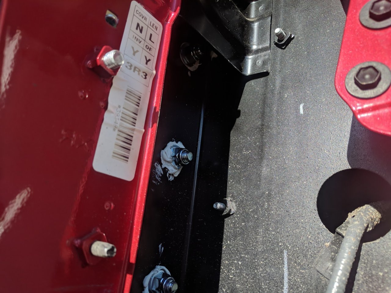

    No problem.
    The silicone is just there to fill any voids. One side should be fine since there will be no relative movement with that many bolts fixing it in place.
    It is totally up to you depending on what kind of exposure you see there. For myself, I found sand behind the taillights from the beach, so that side was most important to me.

    Thank you for all the help!! Got these done a couple of weeks ago, and forgot to update.
    Ended up painting 1 layer primer + 2 coats paint using Q tips and krylon quick dry. Worked well, but realized I scraped a good amount of the paint off putting the hardware in, so I took them off and applied a layer of black silicone as if it was paint (using Q tips also) over the top.
    Made a very durable, sealed layer. Just had to make sure the area was thoroughly dried first.
    Good luck to anyone else trying this!

    Silicone is good "shtuff", but there are a few that will accelerate rust on bare metal vs. preventing it. Do a little research first. Polyurethane caulk or body seam sealer is generally a safer route if unsure.

    For my setup, the holes were painted before I installed the bolts. The hardware seemed to be SS. And also, even the abused areas of the CaliRaised Stiffeners are corrosion free. I remember seeing similar in taillight buckets the last time that I was in there about a year ago.
