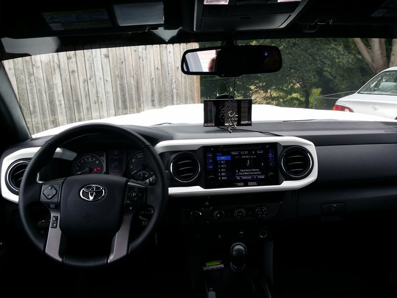

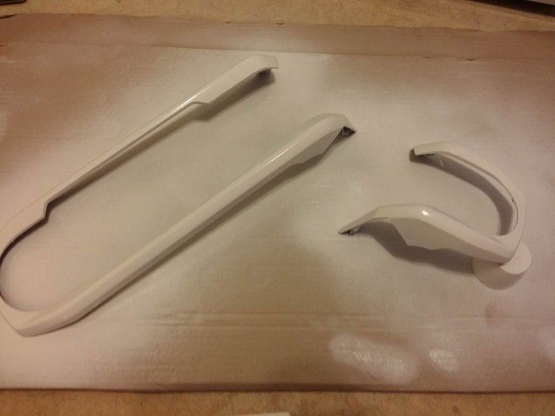

    Got bored today so started to tackle this. Havent seen another 3rd gen with this mod done yet besides the carbon fiber overlay. Should match my white Tacoma real well.trim 2.jpg trim 2.jpg trim.jpg

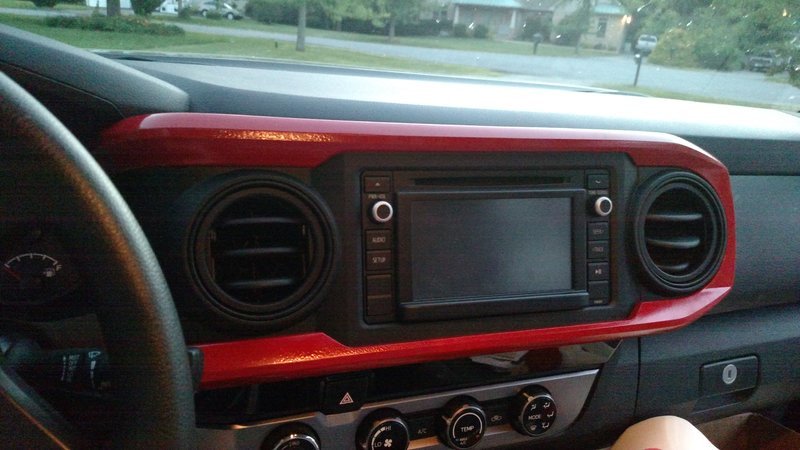

    I sprayed mine red about 2 months ago. Nice contrast to all the black.

    :thumbsup:How are you doing the process(primer,paint,clear etc.)!?Curious to know if cab continue's to linger with paint smell!

    ODNAREM, I just installed them I don't notice huge paint smells, if there is any it'll fade over a day or so. Ive done this on many other rigs. I used Krylon Maxx its a primer and paint combo rattle can then used Krylon clear coat. I wet sanded very lightly with 1000 grit then let the pieces dry. I used ventilation during painting then put a space heater in the spare room and left them at 95 degrees for 6 hours.

    Here is mine with the red. I believe it was Krylon Maxx also.
