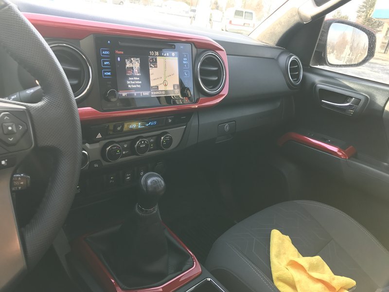

    Following up as I'm done.
    Barcelona red metallic... done at a family members body shop...

    That looks awesome! I didn't think about doing the piece around the gear shift or the door panels. I'm thinking about doing the two pieces on the steering wheel and the part behind the AC/4x4 Controls. But I don't wanna have too much red. Gonna stick with this for a while and see how I like it.

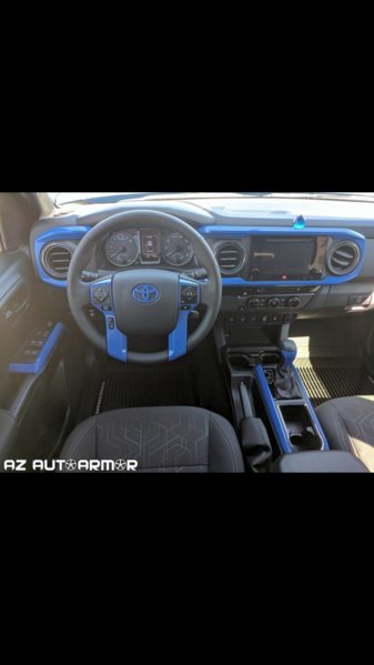

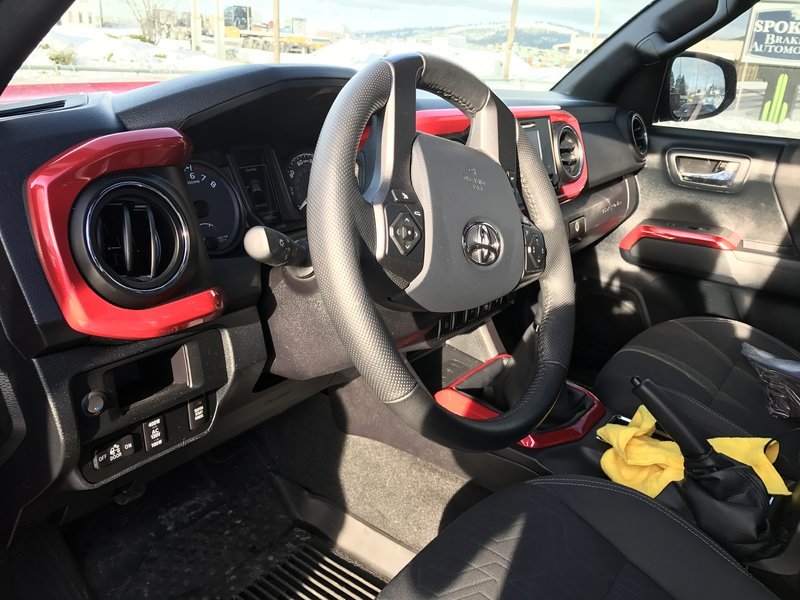

    Here are some pics to give you an idea of what the whole truck could look like.
    Pics are from other members who did this.
