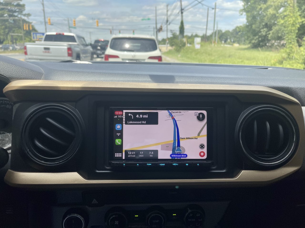

    Just changed mine up with the gold PD .

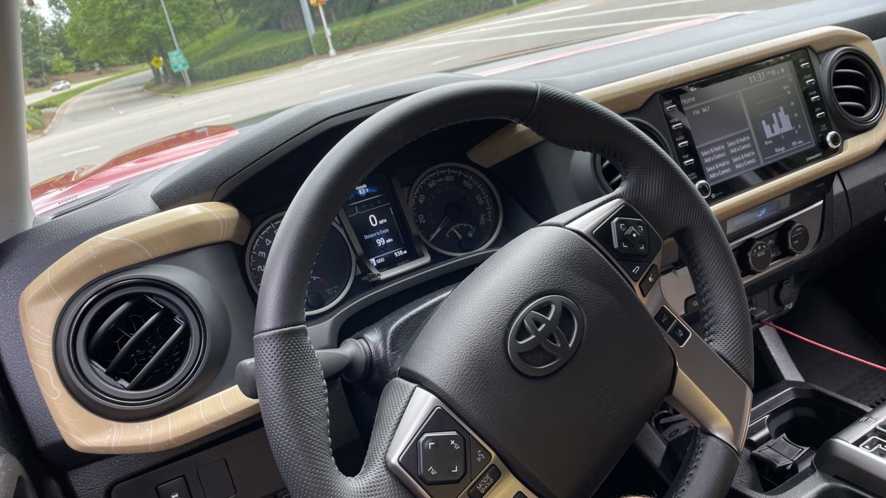

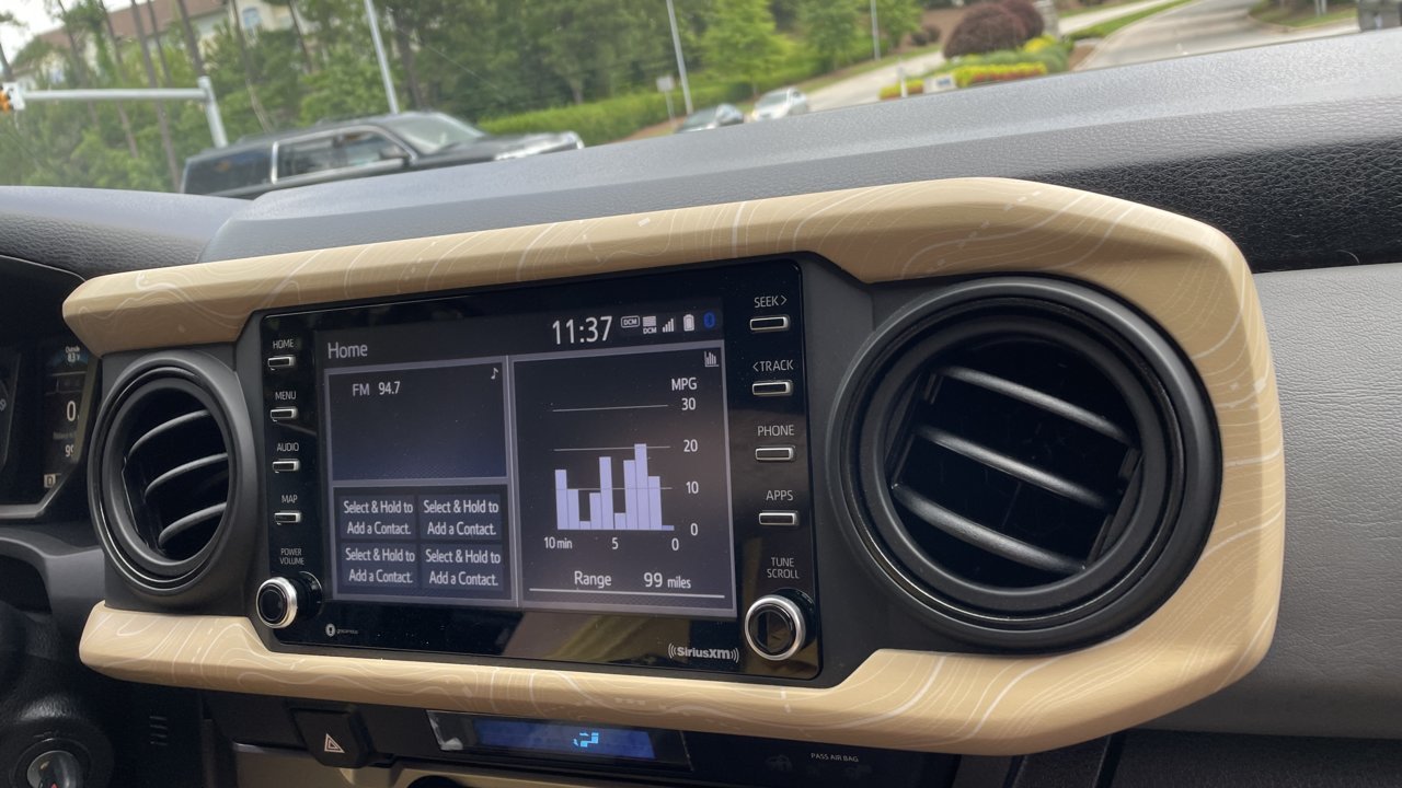

    Did a hydro dip on mine
    Aqualoon and Doogle like this.

    The Hydro dip looks phenomenal. Best I've seen and elevates interior. Looks very high end. Well done.

    I used a krylon fusion base, film from TWN and a 1k clear coat. its pretty easy when you get the right timing for the dip process and i used a cheap plastic storage container as a dip tank.

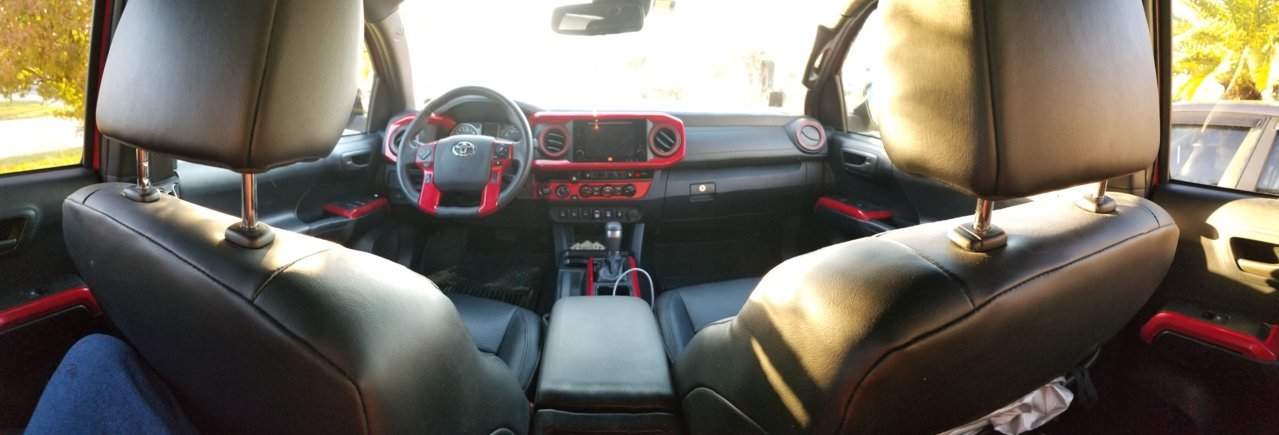

    2018 LIMITED BR DCSB
    Matched my interior trim to the outside
