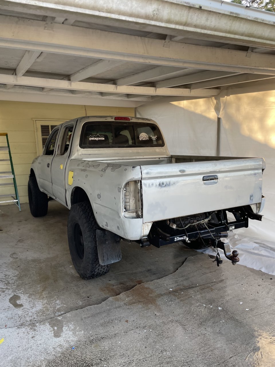

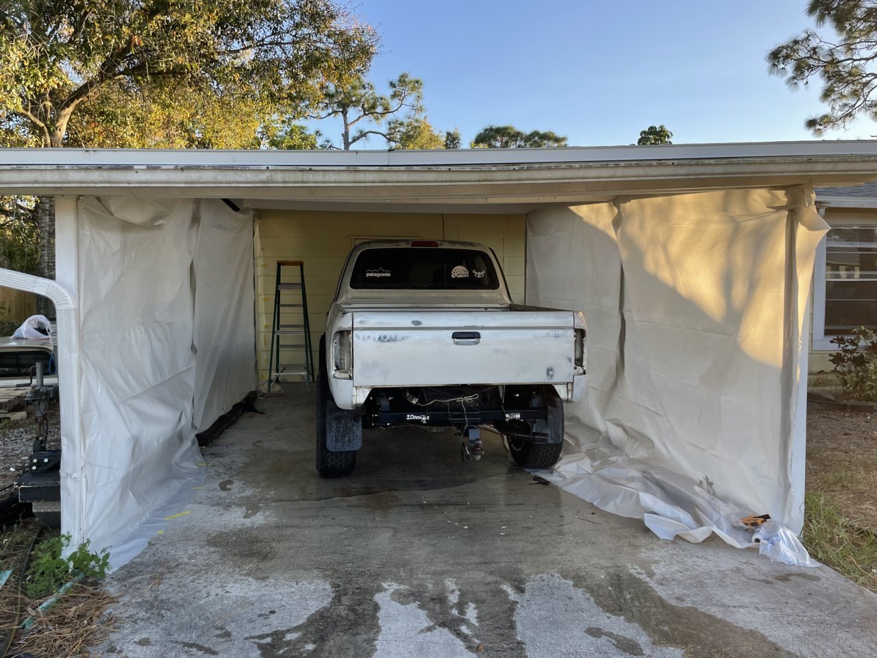

    Long day of prep today, more sanding... never want to touch a sander again. Pulled rear lights, rear bumper, head lights and grill. Don't have a booth so I am tarping up the car port that I have. Far from perfect but better than nothing.
    A little more masking and shell be ready from the gun tomorrow.

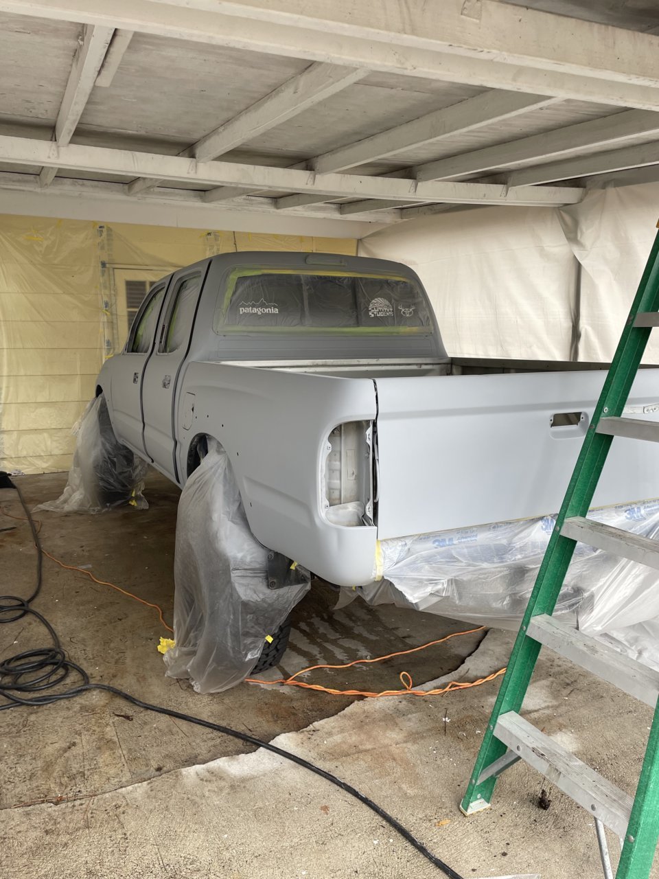

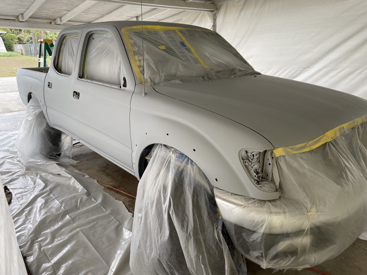

    Finished masking and shot my primer today. Went in pretty nicely. The roof was a pain to reach… thankfully that’s will be the least visible part.
    After primer, I hit it with wet sand 600. I freaking hate sanding lol.
    Hopefully I’ll get color and clear all done tomorrow.

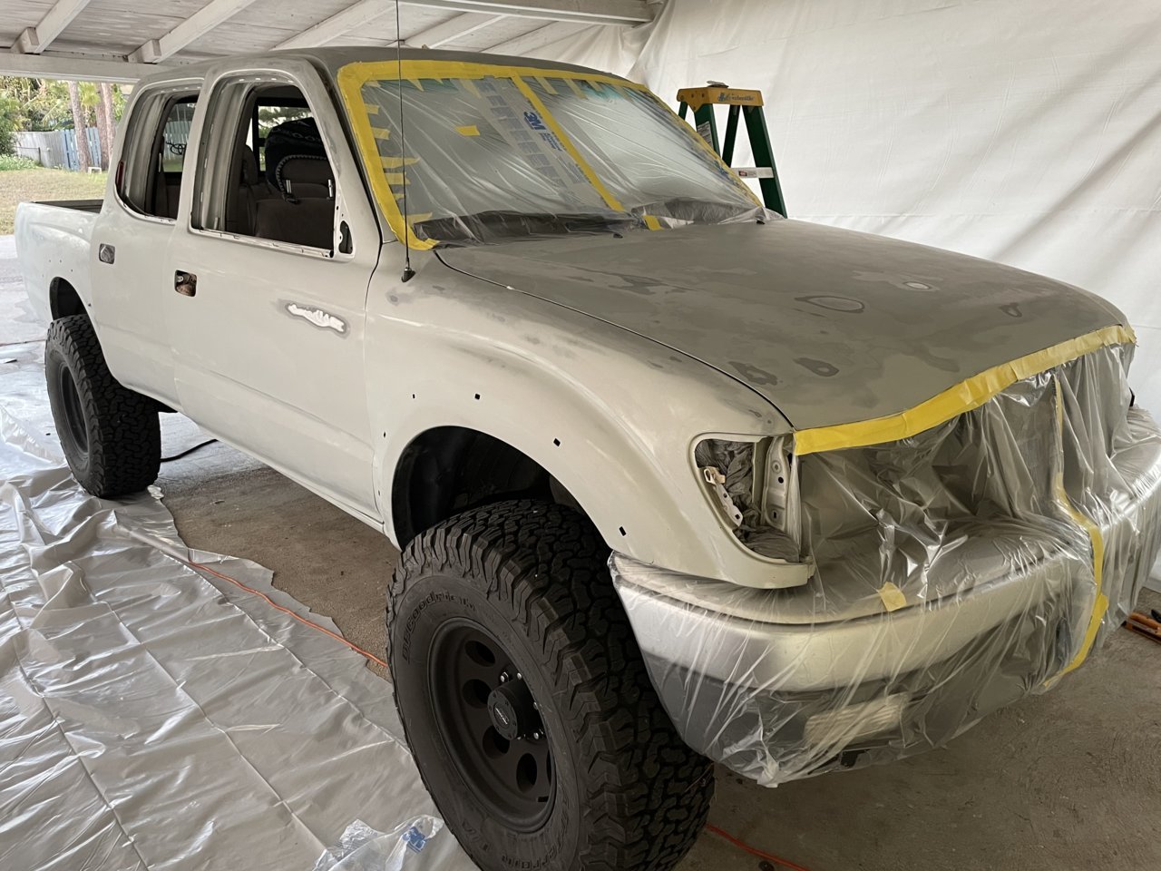

    Sprayed color and clear today. Finished up just as it was getting dark so we will see how she looks in the morning… thinking we are gonna be orange peel city but we will see.
    Here are a few pics I was able to get.
