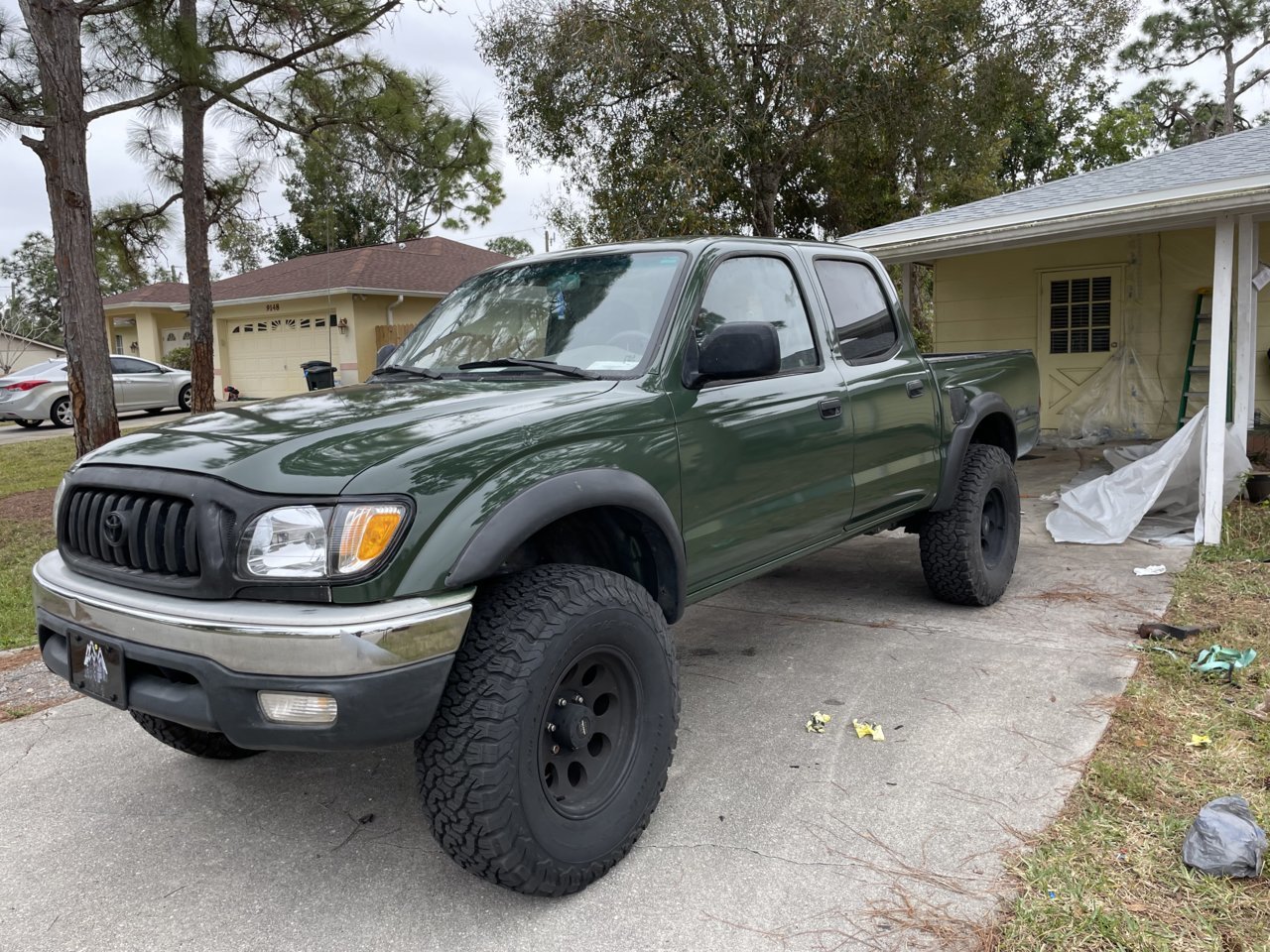

    Man that looks so killer. Giving me inspiration to tackle my trucks wreck of a paint job.

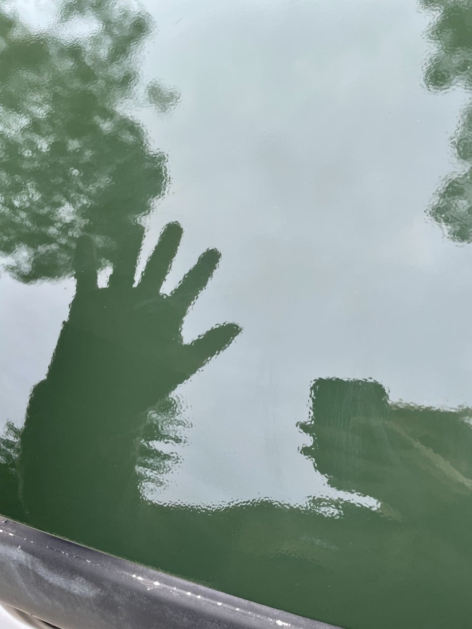

    Good job man! you can wet sand most of that orange peel out. Color looks sweet!

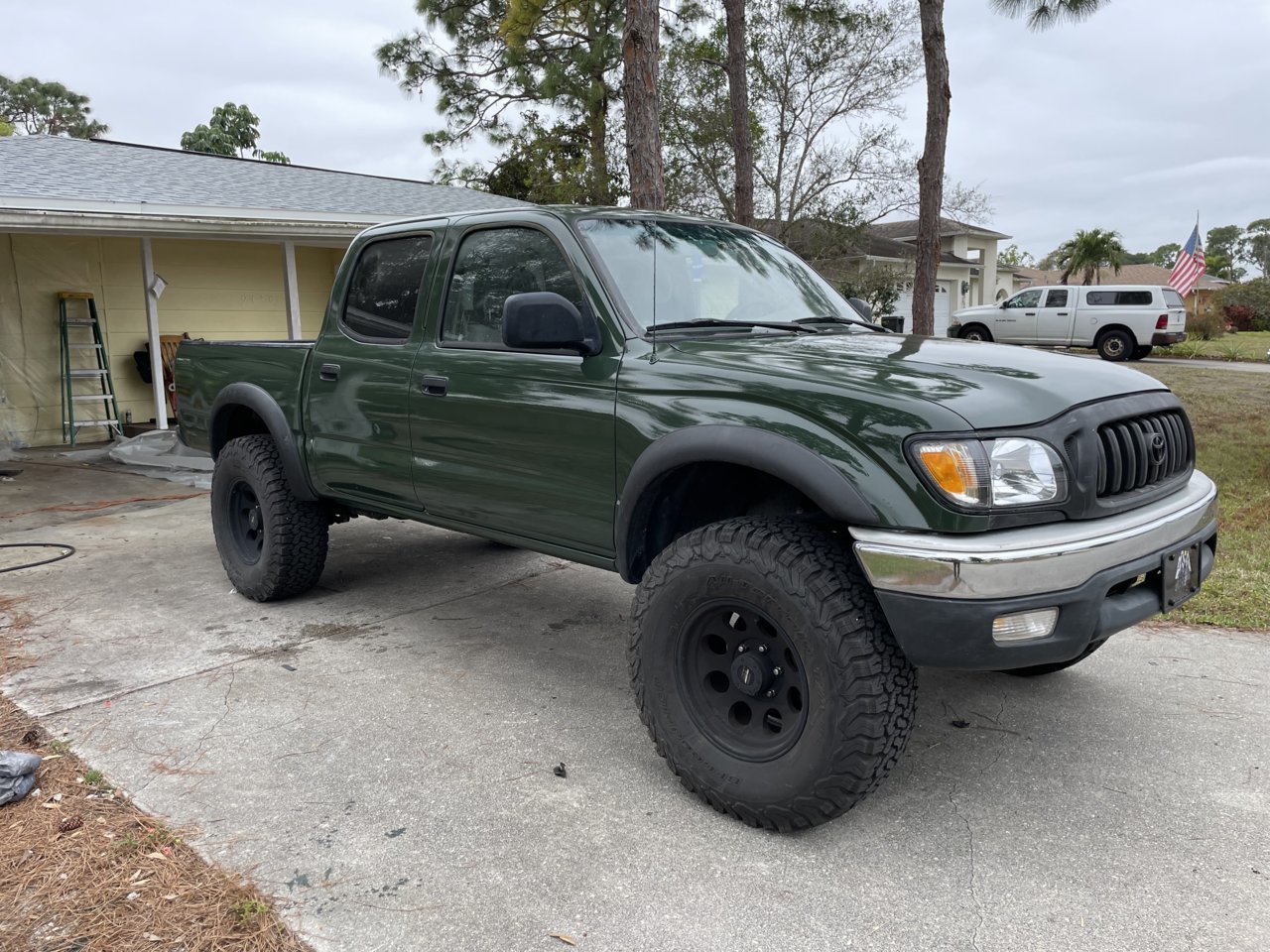

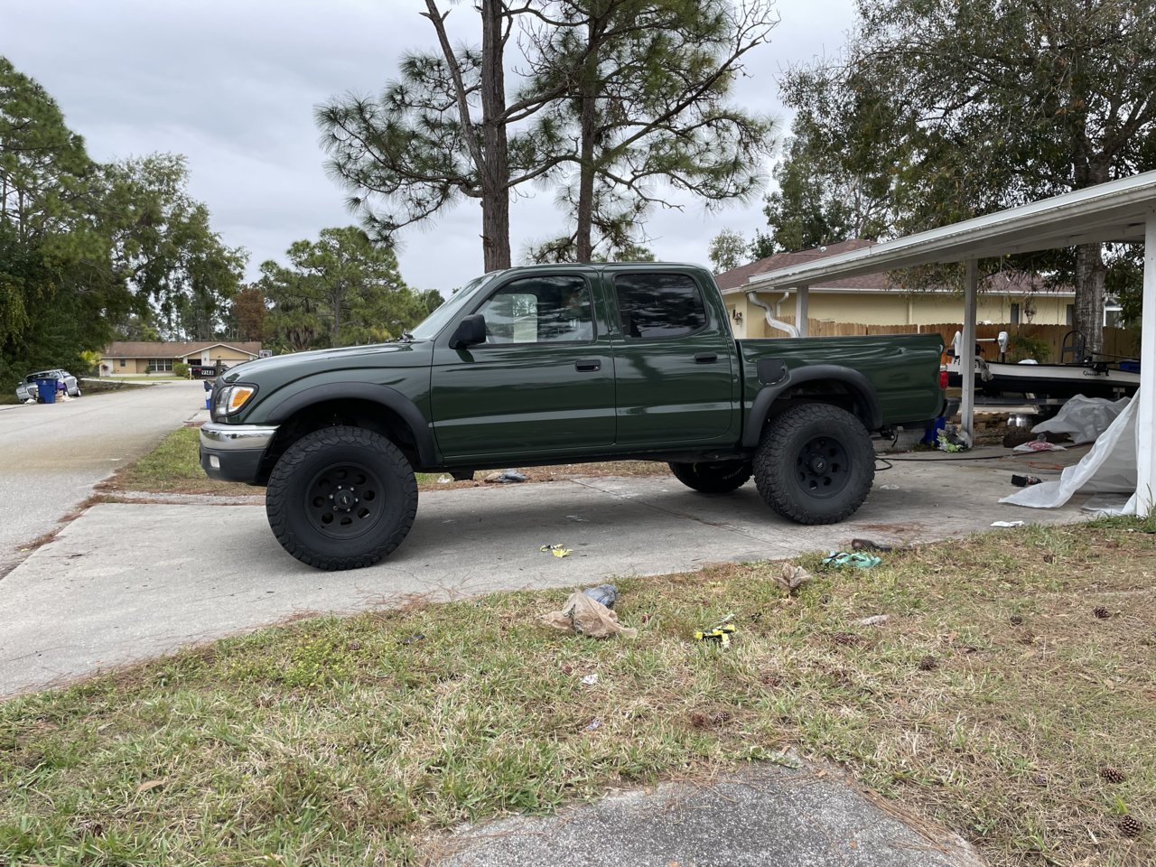

    Got some camber to correct looks like
  8. Feb 9, 2022 at 6:58 PM
    #88
    Runninrutt
    Runninrutt [OP] Active Member
    Nov 17, 2020
    #347019
    39
    Yeah it does look like that in the picture… it’s fine in person. Had an alignment not long ago. Don’t know if that is because of the lens of my camera or something… not sure.

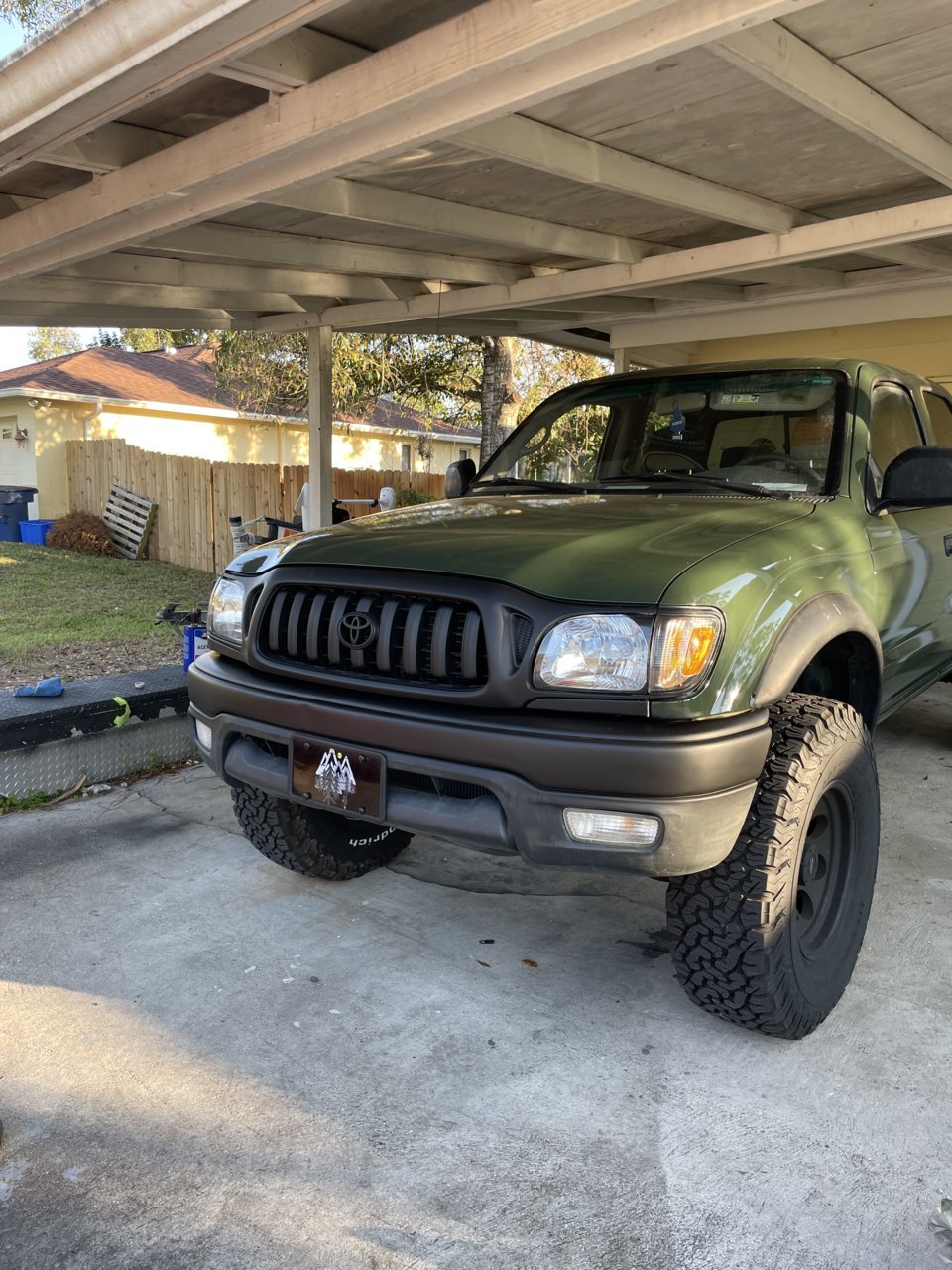

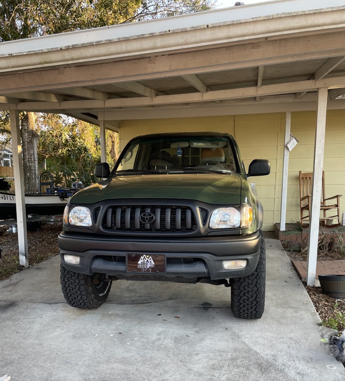

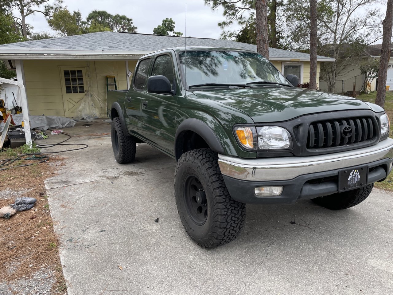

    Finished up the last bit in the front. Officially de-chromed.

    What color are you going with?
  16. Feb 11, 2022 at 8:37 AM
    #96
    ijm01PR
    ijm01PR Well-Known Member
    Aug 10, 2021
    #373703
    332
    Alex
    Indiana
    01 DC Prerunner (4x4 TBD)
    Ome 881s w/ 5100s and jba ucas 2” pro comp AAL with 5100s in the rear
    What did you paint your bumper with? Did you have to sand the chrome off?

    Plastidipped the grill and bumper. I did the grill a long time ago.
