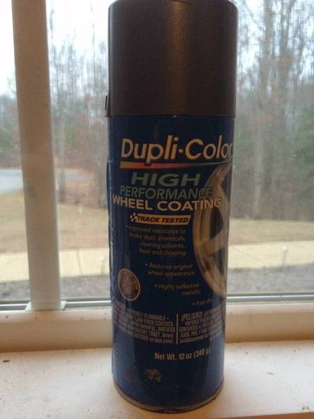

    Same basic shit everybody else had 5 years ago.
    This is how I did mine and its pretty simple to do. If you want to touch them up it is also very quick with this method. I also use the same brand clear coat and it does IMO make it more durable. I have had these painted since 2006 and have only touched them up twice, both times after getting new tires installed.

    Most everybody's methods are good. For black paint, I've recently been using Dupli-Color High Performance Caliper Paint with Ceramic (#BC102)
    Very smooth - powder coat shine and forgiving in prep. Good for suspension, etc. Try a can on something and you'll see.
    also another good black paint (made for aluminum) is the Mercury Outboard Motor touch-up paint. Comes in the rattle can. Tough as nails, not asforgiving in the prep. clean-warm-dry! Has more solids/pigment or something (brain fade). I used to use it for suspension pieces on Mopars. Not as shiny as Caliper Paint.
    I painted my motorcycle wheels and other parts with the Dupli-Color Wheel Coating mentioned above. (Graphite) good stuff. Even worked on a rusted shotgun barrel.
    I like to throw the rattle can in a bucket of warm water for about 15 min. (under 120*) and maybe a little heat gun on the wheel (98.6*)
    The faster the paint sets up, the less time for defects to happen. Follow directions on the can.
