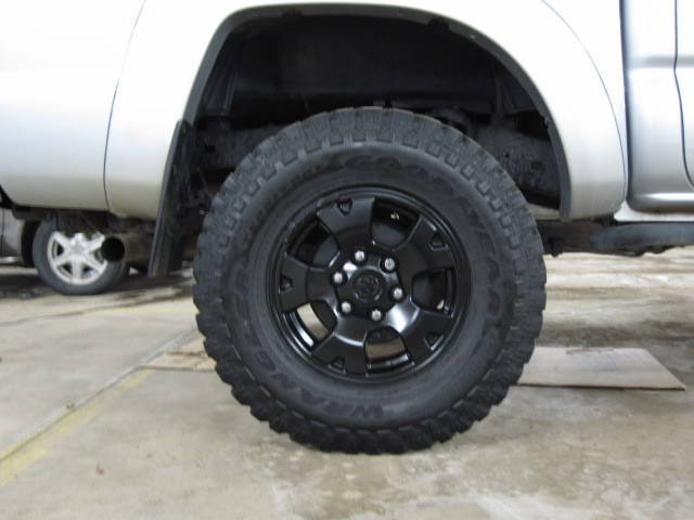

    :)Today I decided I wanted to spray my trd off road rims black. Thanks to all the tips and pics members here have posted here on TW made it really easy. The Q cards make it so simple. I got 2 done today before alot of people started coming home into my parkade, I didnt want to be spray painting with all the cars coming in, so I will do the other 2 tomorrow.
    Used Krylon satin black 1 can did 2 wheels and 2 centre caps.
    Heres a couple pics I will post more when all 4 are finished.:)
    Im pretty happy how they turned out.

    Tsenekos, did you have to sand it down or buff it up or anything (the wheels)? Or did you just clean it and sprayed it right on?
  13. Feb 8, 2010 at 5:14 PM
    Tsenekos
    Tsenekos [OP] Well-Known Member
    Aug 17, 2009
    #21319
    1,045
    Greg
    Edmonton, CANADA
    2005 DC 4WD trd offroad
    Toytec 3" lift w coils,1.5 AAL,5100's all around,diff drop kit, axel shims,N-Fab nerf bars,bestop supertop,fog mod, weathertech mats
    First I scrubbed them down with a 3m green pad and spray nine degreaser, then sanded them with another 3m green pad then sprayed them down with brake cleaner and wiped them down again then 3 light coats of satin black (finish is betwwen flat and semi-gloss):)

    Now I kinda wanna do the chrome grill surround but not sure how the paint bonds to the chrome and do you guys think a black grille will look decent on a silver truck never seen one?????
  16. Feb 10, 2010 at 3:32 PM
    #16
    Tsenekos
    Aug 17, 2009
    #21319
    1,045
    Greg
    Edmonton, CANADA
    here you go not the best pic :eek:

    what size and make are your tires?sweet job on the rims btw...I will be doing this soon
  18. Feb 10, 2010 at 3:58 PM
    #18
    bt08231
    bt08231 Well-Known Member
    Jun 28, 2009
    #19008
    359
    Baltimore, MD
    09 Magnetic Grey SR5
    Stock
    looks flipping AMAZING in satin, slight shine but not to much gloss. Love it, center caps also turned out very nice, i replaced mine with stock black fj center caps but really like the way urs turned out

    ya the satin is a nice sheen its between flat and semi gloss black they look alot less shiney than they do in my pics. Im just doing the toyota logo on the caps in silver streak mica right now hope it looks good
    thanks for the compliments
