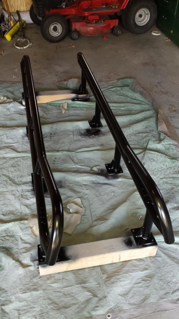

    My AP sliders came in and after debated, I decided to paint them vs. powdercoat. The way I see it, I intend to use get my moneys worth out of them so paint is cheaper and easier to touch up.
    Gratuitous (and crappy) cell phone pics:

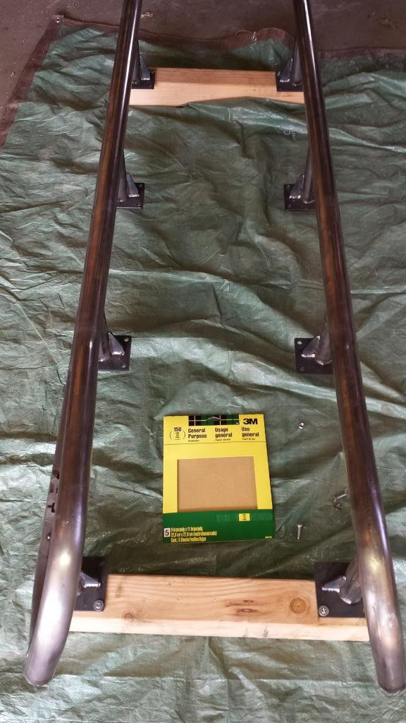

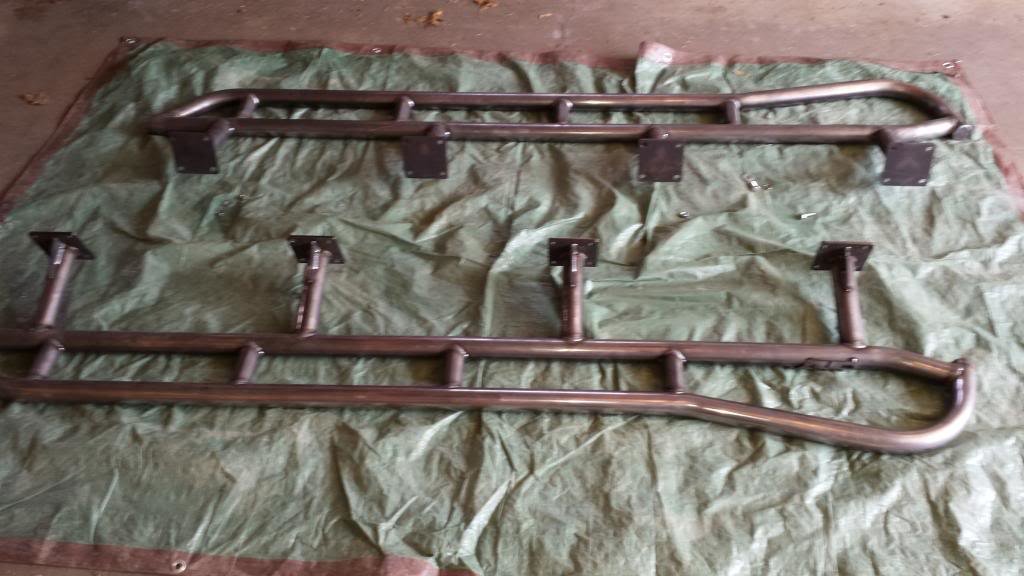

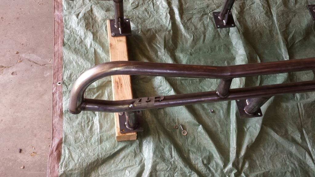

    First thing I did was mount them to 4x4 timbers. While stable sitting on their bases, mounting them to the 4x4's will prevent them from being tipped or knocked over. I then lightly sanded and cleaned everything:
    After another thread discussion, I went with Rustoleum Bare Metal Primer. It dries to the touch in 30 minutes, can be handled in 2-3 hours and fully cures in 48 hours. The instructions are to reapply within 1 hour or after 48 hours so I have my timer set to 30 minutes after each coat:

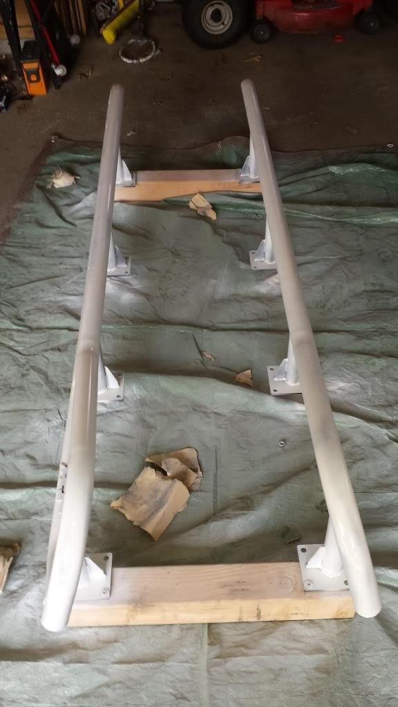

    First coat:
    To be continued...

    Second coat of primer painted.
    One thing to note. If you look at the way I have the sliders attached to the timber, I have the tops pointed inward which was a bad idea. The top is what everyone will see and it is difficult to paint in this configuration. I could have used longer pieces of timber but that would have been a waste of wood.

    Here's the paint that I'm using. I went with a semi-gloss as I didn't want anything too shiny.
    Here is what they look like after one coat. It's still tacky so the shine may go down but they do have the appearance of powdercoating.
    As an unexpected benefit, the white primer stands out against the black paint which helps with ensuring an even coat. The first coat takes the longest to go on. After that, each subsequent coat is just enough to make it look "wet".
    So far, I've used about 1 1/2 cans of primer (2 coats) and just over 1 can of black pant (1 coat). My plan is to get 3 coats of black on it, wait until Wednesday, touch up as needed and maybe add a coat of clear coat.

    I don't have pics as it is too dark but after 3 coats of black, it looks exactly like powdercoat, even has that glossy, slightly dimpled look. So far, I'm really happy in how its turned out.

    Sanding wasn't too bad as there was no rust or oil. I took some 120 grit and lightly sanded everything, just enough to remove the tarnish and lightly scratch the metal. I then took some shop rags and wiped everything clean.

    A few other lessons learned:
    1. The 4x4 timber was cut at 24". If I would have set them on saw horses instead of the ground, it would have been easier to see all sides of the tubing.
    2. Overestimate the amount of paint needed. Even using very light coats, I used just over 1 can of paint per coat.
    3. Dedicate an afternoon and have a stop watch. It took around 15 minutes to paint each coat and I set my timer for 30 minutes between coats so I started painting every 45 minutes.
    4. Plan your week. Once you've waited longer than 1 hour, you need to wait 48 hours before painting again. My timeline is paint today (monday), touch up and paint bases Wednesday and install Saturday.
