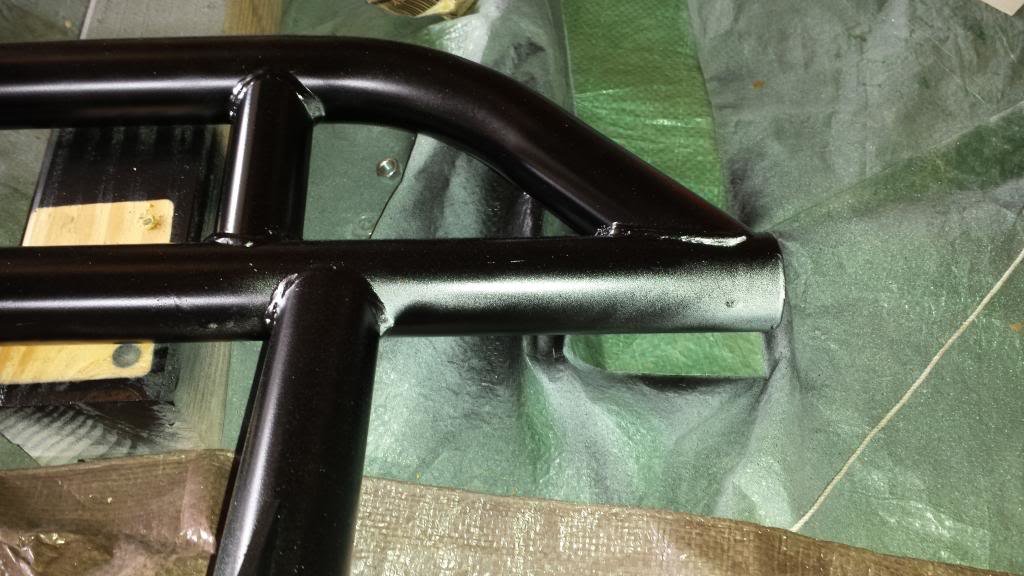

    Paint is dry so I laid them down to paint the underside of the bases. As you can see, there were a few spots that I missed yesterday, largely due to the fact that I couldn't see them. If I were to do it again, I'd use the same jig but have it sitting on saw horses so I could see everything easier.

    Trail report.
    Banged them on rocks and used them to steer me around some tight trees. No surprise, the rocks scraped them down to bare metal where they hit. Where the trees hit the kickouts, some of the black wore off but the white primer is still intact. My kids have also used them as steps and I've kicked them a few times with zero wear or damage.
    Overall, I'm quite pleased with how the paint has held up. As long as you wait a few days to allow the paint to fully cure, they've been every bit as tough as anything else.
