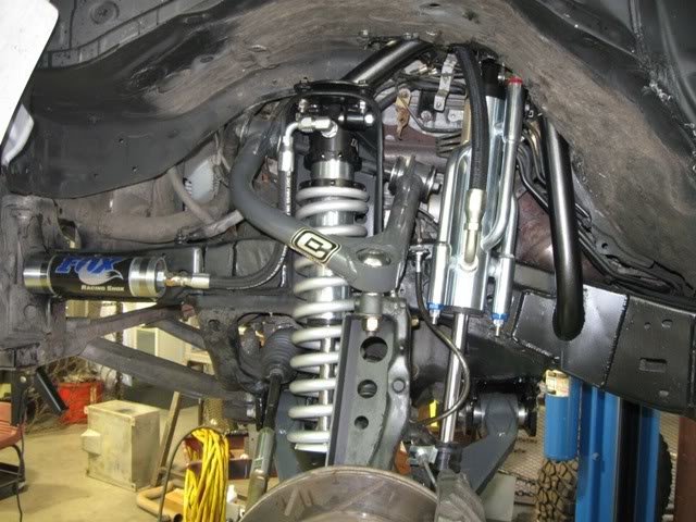

    My junk once looked like this:
    After 6 days commuting in the snow it looked like this:
    I'll get the aluminum cleaned up with some polish, air tools, and plenty of roloc discs but I know it'll just get nasty again once the salt sprayers come back out. Waxing helps but doesn't fix the issue completely.
    Has anyone tried painting their shocks? I know it'll have a negative effect on heat dissipation but I'm hoping it's slight. Also, the same salt that corrodes the metal will chip away at the painted finish, so that's also a concern.
    Anybody have some ideas of what's possible to keep these things looking like anything other than scrap metal?

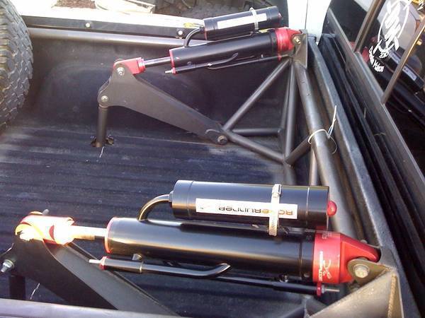

    mike painted his shocks. IDK what paint he used, but i do know his truck still performs just fine with the painted shock bodeis... but his truck doesn't see race conditions like yours...

    Fox shock oil is good up to 450 degrees. Shock temps up to 500 degrees have been seen on really rough courses like San Felipe. Definitely need high temp paint for that.
    Those look damn good! Nice that they're up and away from flying debris kicked up by the wheels.
    At least there might be hope to restore some of the "show" to match the "go" :)
