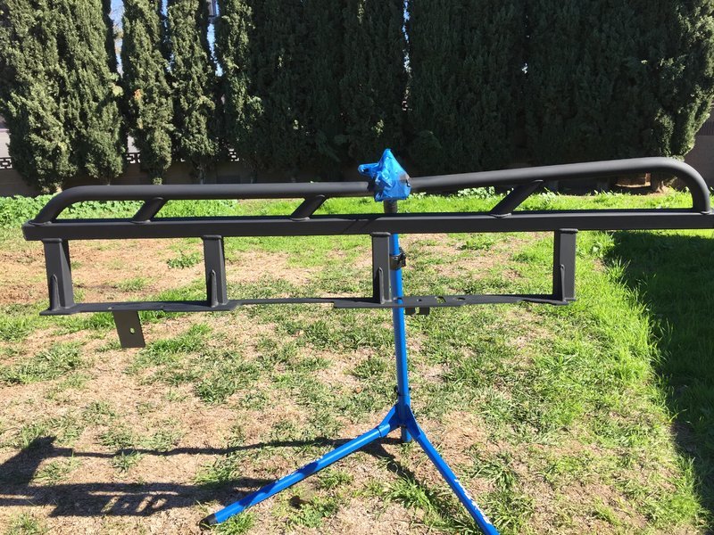

    Paint!:thumbsup:This is step 2(black sandable primer)of the 3 procedure's i'm doing.Step 1 was self etching primer and step 3 will be a lightly textured bedliner.All rattle can Rustoeum products.Easier to touch up overall.image.jpg

    ^^^ Hah! I don't have sliders yet, but wondered how to hang 'em for painting when I do get them. But now I know - I have that same Park stand. Thanks for the inspiration.
