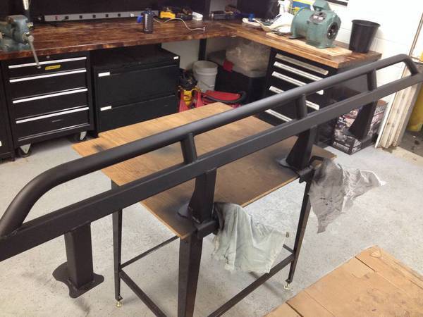

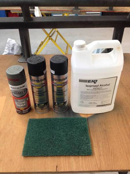

    Well here's what I've decided. Rustoleum self etching primer and Rustoleum Professional flat black.
    I'll do 1 or 2 coats of primer. Wait for it to dry 3-4 hrs at 70 degrees. Then rough up with a scotch pad. Then finish with Rustoleum Professional 3-4 coats. After I've mounted the sliders I'll apply some grip tape and lip seal to the edges ;)
    Parts List
    2-3 cans of Rustoleum Professional flat black Enamel < This paint kicks ass. Perfect finish. Probably the best I've ever used.
    2 cans of Rustoleum Self Etching Primer
    Denaturing Alcohol
    Scotch Pad
    Do not buy Rustoleum Auto Primer. I had to use it to add a little more primer. It kept clogging up.

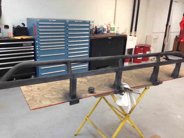

    Primed
    Finished- I used 2 cans of the PRO but i may do 1 can since its only $6 at the Depot
