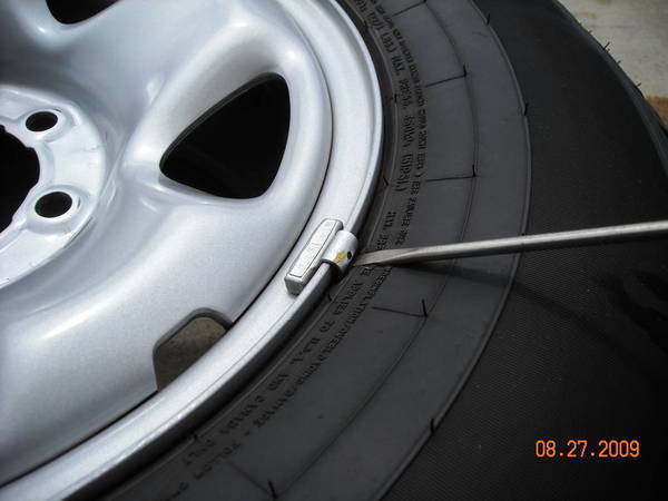

    remove outside weights, mark location with piece of tape, write weight amount on tape if doing more than one at a time

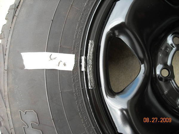

    notice tape for weights

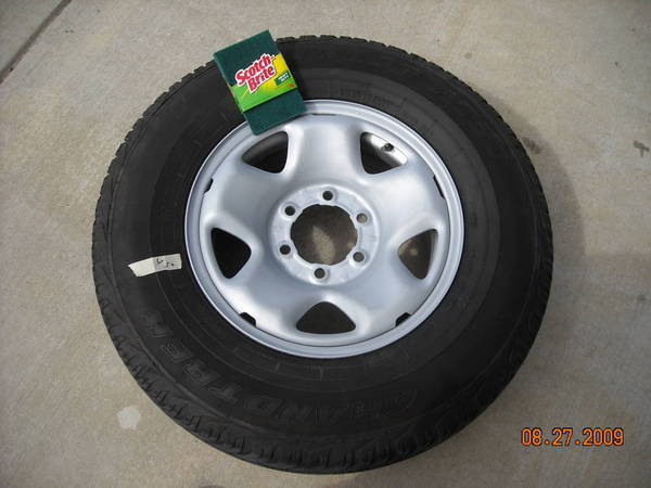

    using scotch brite, scuff sand entire rim, inside and out, pay more attention to the outside. make sure you have a dull surface all around. then lightly do the inside of rim.
    after sanding i used rubbing alcohol and wiped rims inside and out clean, let dry for about 10 mins.

    just before putting back on truck, reattach the weights
  9. Sep 7, 2009 at 10:11 PM
