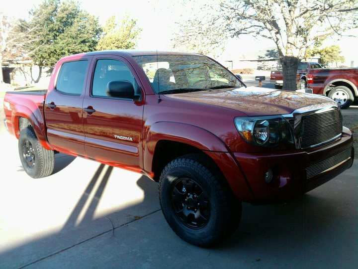

    Can you post a pic?

    2nd on how did you manage to get the inside of the cap red??

    I used masking tape, 400 grit for scuffing, rustoleum graphite wheel paint & sandable primer for center caps.
    Left wheel weights in place.

    I painted the red centers by hand.
    yes it was tedious, but worth it.
