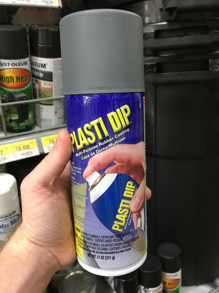

    Saw Grey plasti dip at the local Walmart

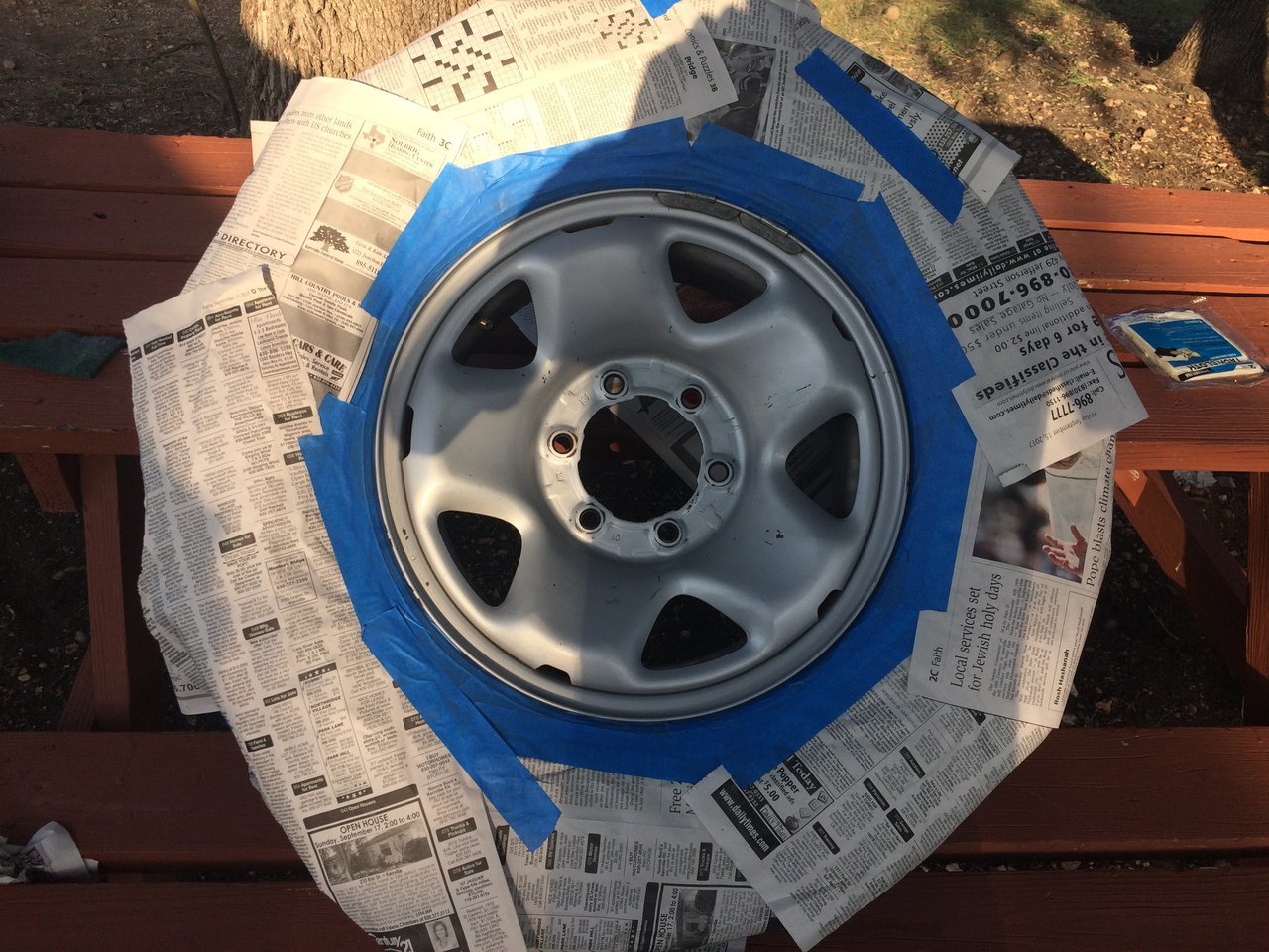

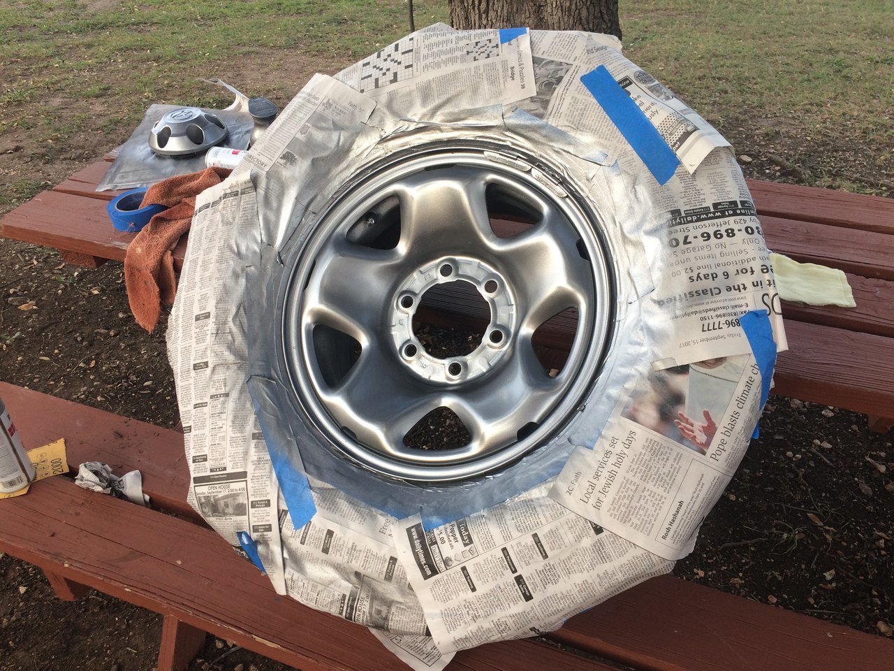

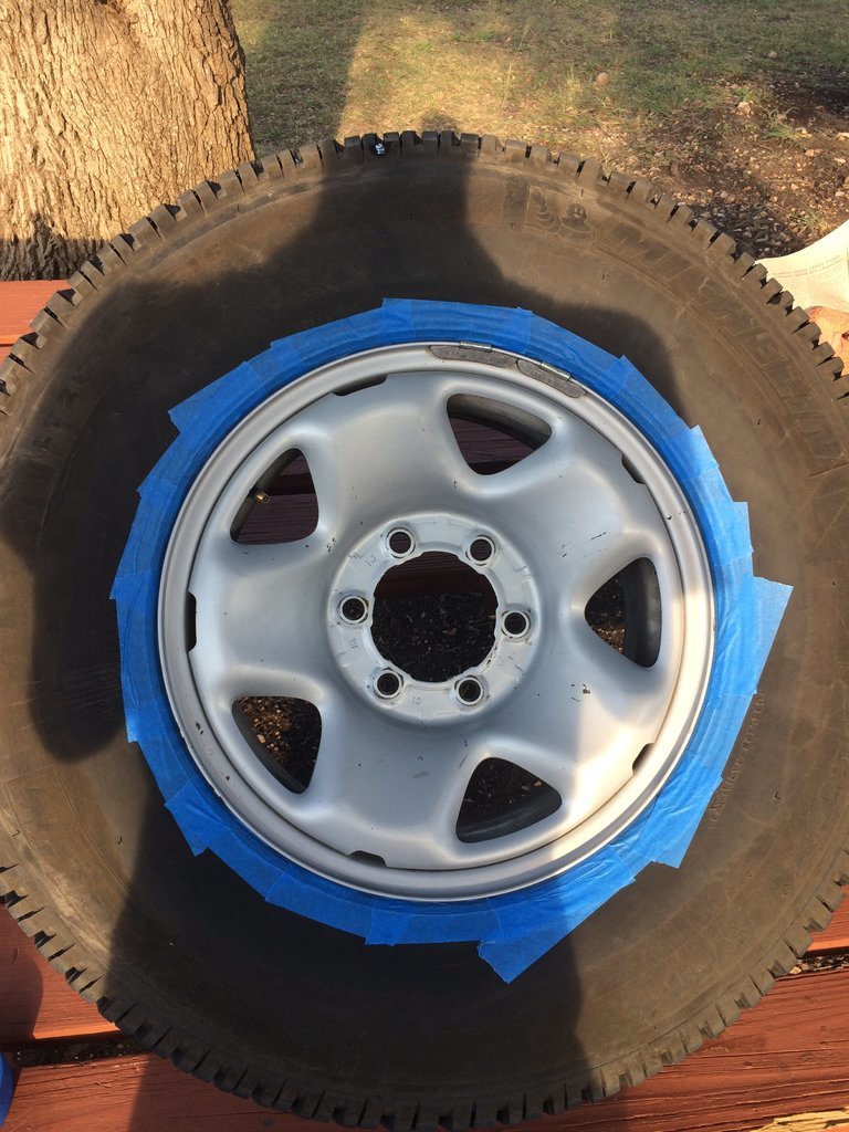

    Finished up the first one today after i got off of work, but ran out of time so ill be doing the rest tomorrow. Im pleased with how its turning out so far!
    My4thTacoma and Hawco636 like this.

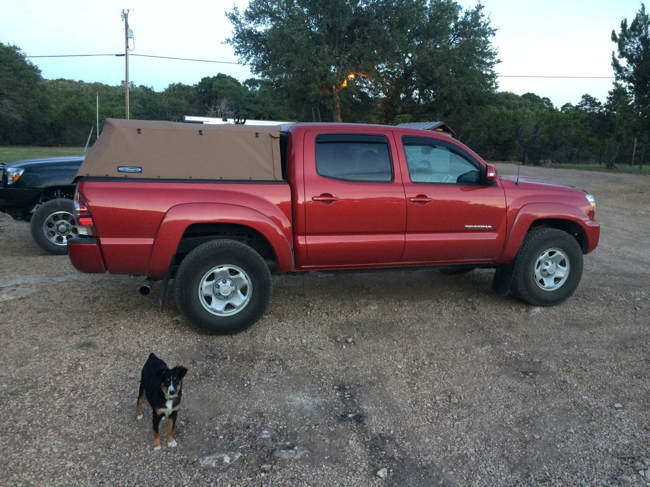

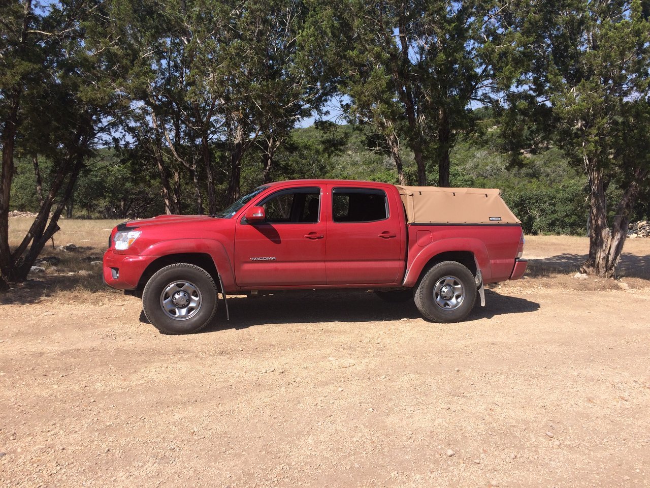

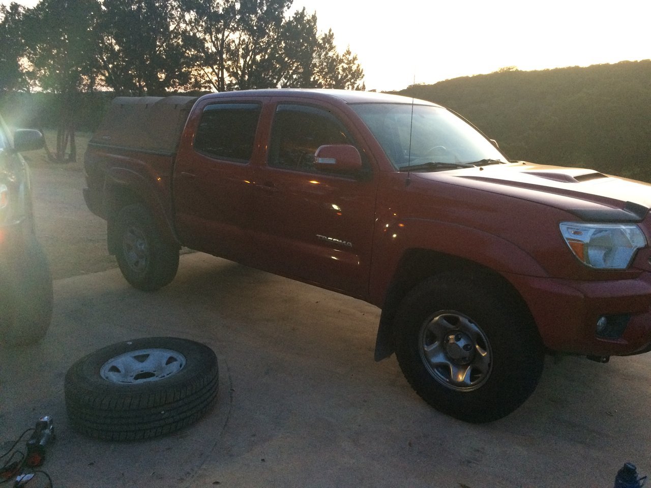

    Before
    After
    Heres the finished product @PA wilds Taco
    Im happy with how it turned out! I ended up with just enough for all four and i might still be able to do my 5th matching spare
    Climberclimb and hemitruk like this.

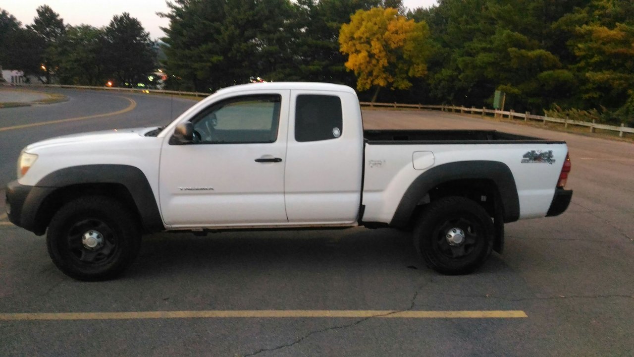

    2 coats Rustoleum midnight black metallic. 3 Coats Rustoleum crystal clear. 70mm emblems from E-bay.
    highriserkaiser and BassAckwards like this.

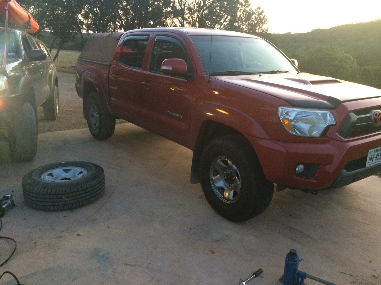

    Looks like you removed the wheels before dipping. How long did it take you start to finish? Trying to figure out timing with this project. Most likely with wheels still on.
  13. Sep 18, 2017 at 10:38 AM
    #33
    WebberLander
    WebberLander Well-Known Member
    Apr 1, 2014
    #126706
    1,877
    Mark
    Colorado
    2011 SR5 4x4
    Overlanding Rig
    I actually left them on while I did this. There was over spray onto the tires, but I waited until the very last coat to peel it off and maintain the lip over the edge of the wheel's rim. Once you get a peel line started and take your time it will come off without messing up your finish on the wheel itself. This was a very tedious process but if you take your time you can do them while on the truck. What'd you can also do is attempt to run blue tape around the edge of the tire. Keep in mind you'll have to scrub your tires really good with de-greaser to get any oils (like tire shine) off of them for the tape to stick. I chose not to do this though after having tape fall off before even beginning to spray.

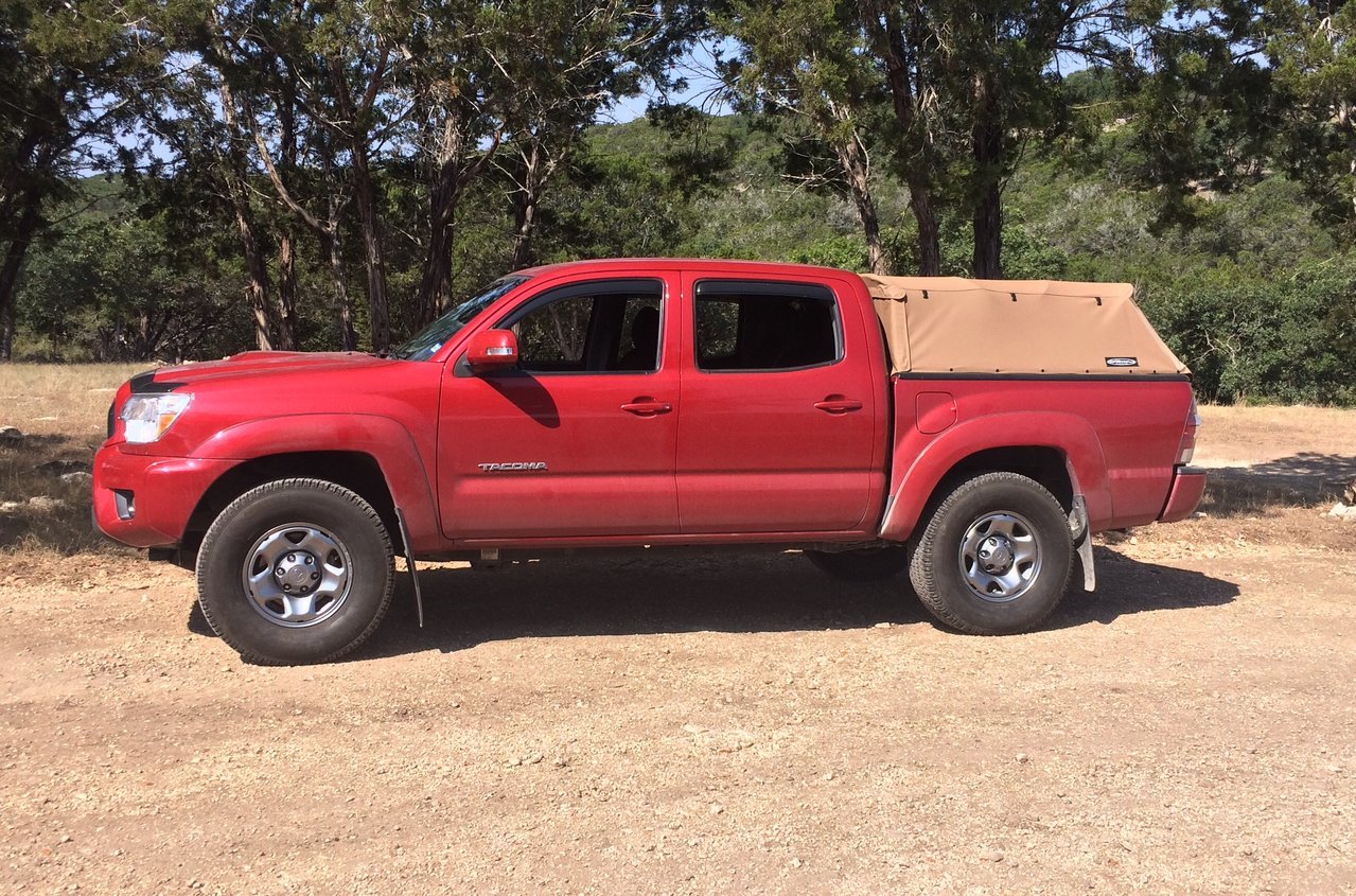

    Can I get a clear pic of that tan on red? I'm really debating a softopper after seeing some cool things done with cross bars that fit underneath.
  17. Sep 18, 2017 at 1:50 PM
    #37
    BassAckwards
    BassAckwards Well-Known Member
    May 3, 2016
    #186002
    27,954
    2009 Tacoma AWD Turbo 2TR-FE
    Full-time AWD & BorgWarner EFR 6258
    This is the best one ive got on my phone right now, but i already posted it above. I can get another when i get off work if youd like, just let me know
    Also mine is barcelona red, where as based on your year model, i think you have a radiant red
  18. Sep 18, 2017 at 1:52 PM
    #38
    highriserkaiser
    highriserkaiser Estoy Grifo
    Jul 21, 2017
    #224673
    259
    Gunnison National Forest
    2007 DCSB TRD Offroad 4x4
    More than quality. The other was just washed out. Definitely food for thought. That's the Softopper, not the Best, right? Windows are pointless to me if I can roll the front corner for the pups. How is yours holding up?
  19. Sep 18, 2017 at 1:56 PM
    #39
    BassAckwards
    May 3, 2016
    #186002
    27,954
    Yep, thats a softopper. Ive only had it for a month or so but i drive on dirt roads everyday and its holding up great. Love mine so far, i highly recommend it. From what ive read, the build quality is a little better on the softoppers and the windows seem to hold up for longer. I guess only time will tell, but its great if you ever need to use the bed for something. I put mine down in a matter of about 5 minutes by myself this past weekend. That would be impossible with a fiberglass cap. So far the only downfall ive noticed is less visibility out of the back when changing lanes, but its not bad with a short bed, i imagine its a little harder to adapt to if you had a long bed.

    Did you take your tires off to paint them? I don't have the capability to take off then put tires back on. If so, did you just tape off the rubber?
