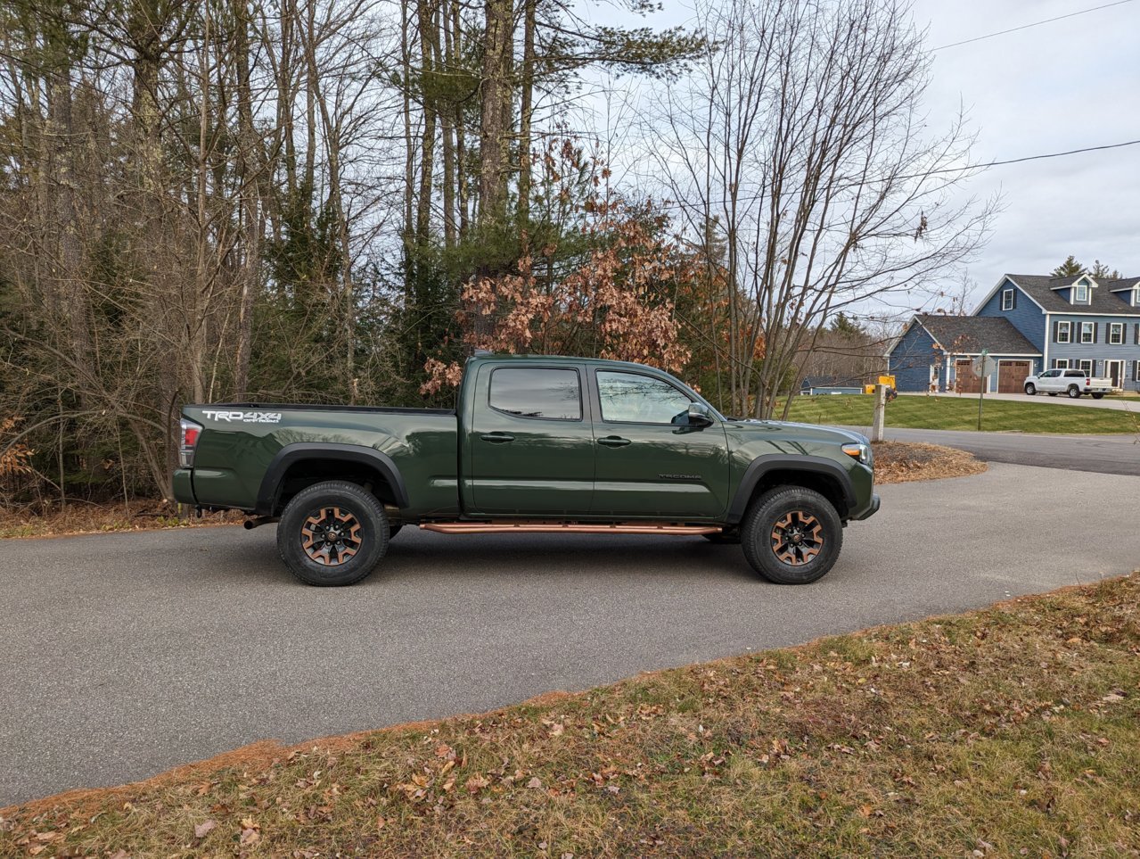

    Bronze on that color always looks dope. :thumbsup:

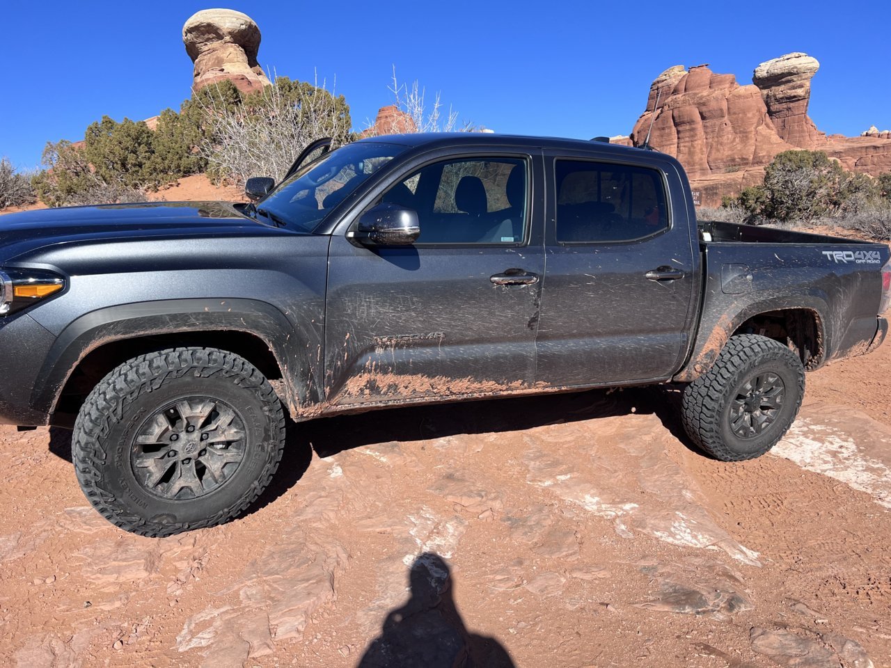

    Gun metal grey rattle can20220828_171230.jpg 20220828_170023.jpg for the win...

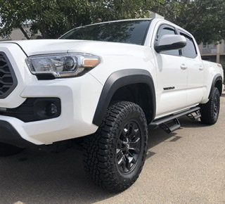

    X3 for vinyl blackout stickers. You MIGHT be ready to open your wallet in a few years OR replace the stickers. I’m 27 months in on mines. 63D402DA-E7B2-4DD4-BCDD-E386FEB66409.jpg

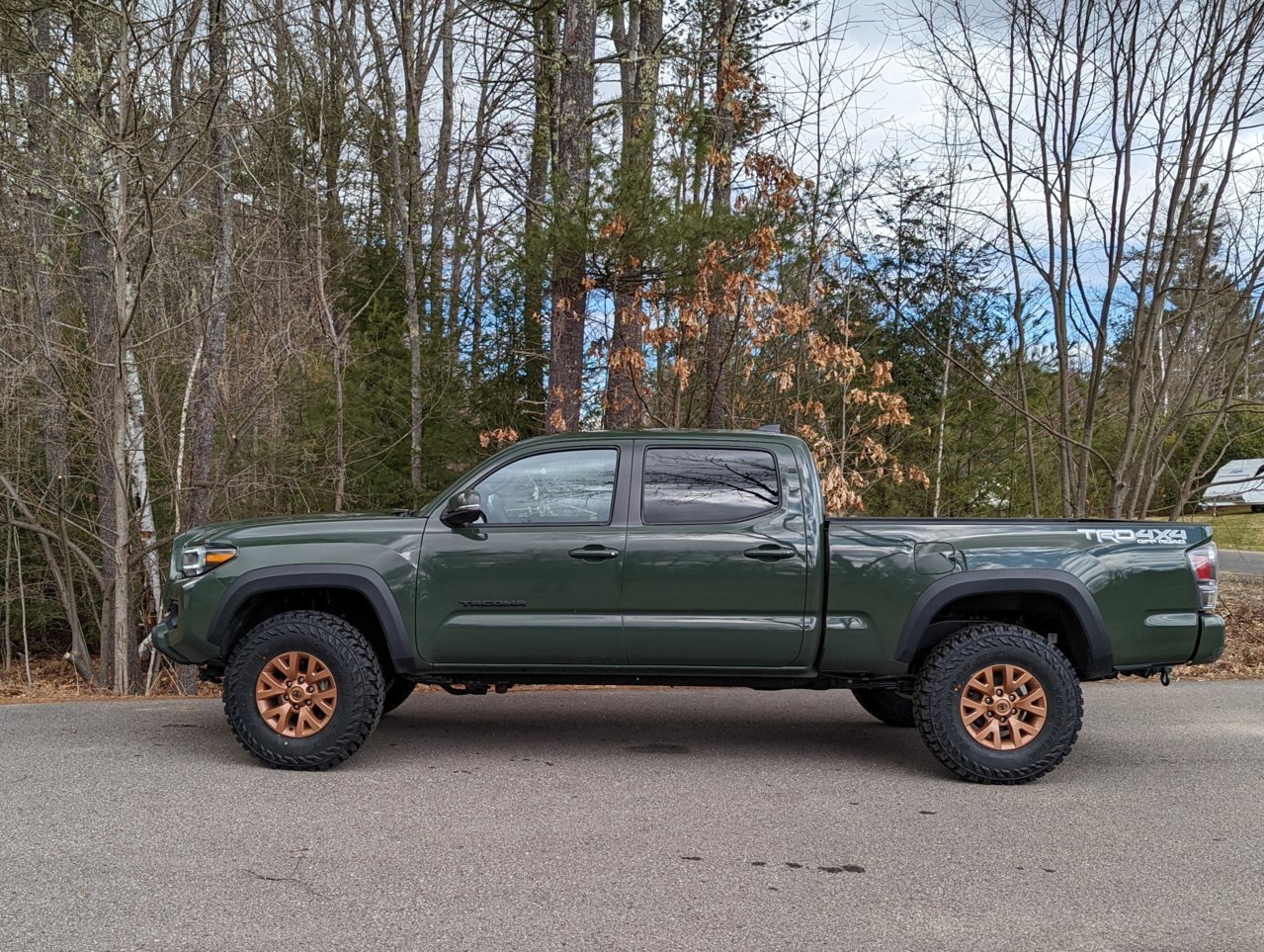

    I forgot to post after painting mine.

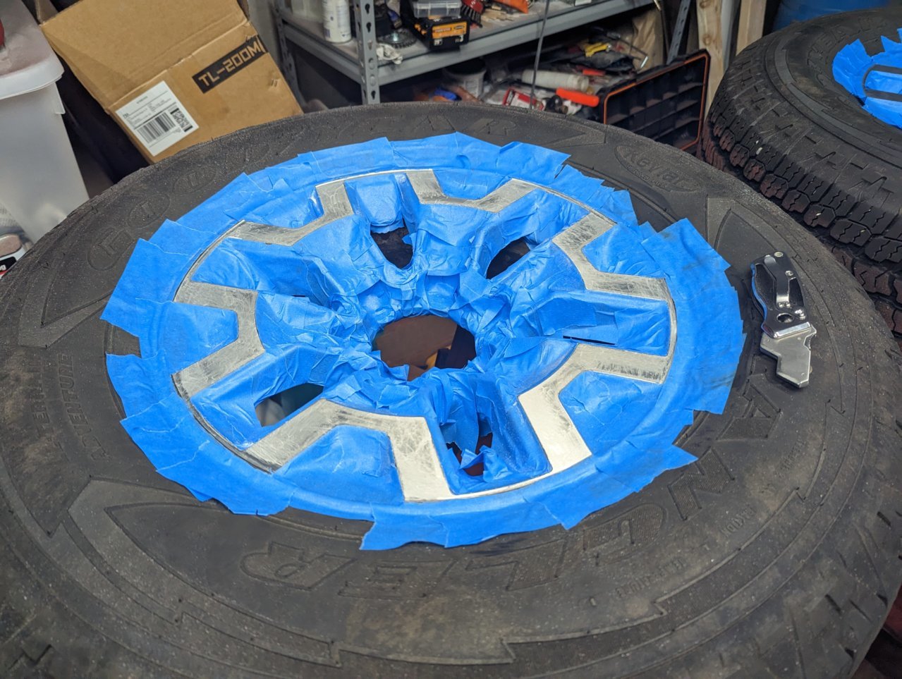

    They are dirty but mine are black spray paint. I’ve used bed liner in the past on my Jeep and it didn’t hold up as well as the krylon fusion is. I just used playing cards to cover the tires and then put shop towels in the wheel opening 28027AEB-29B1-48DE-AED8-4685D1152CF2.jpg

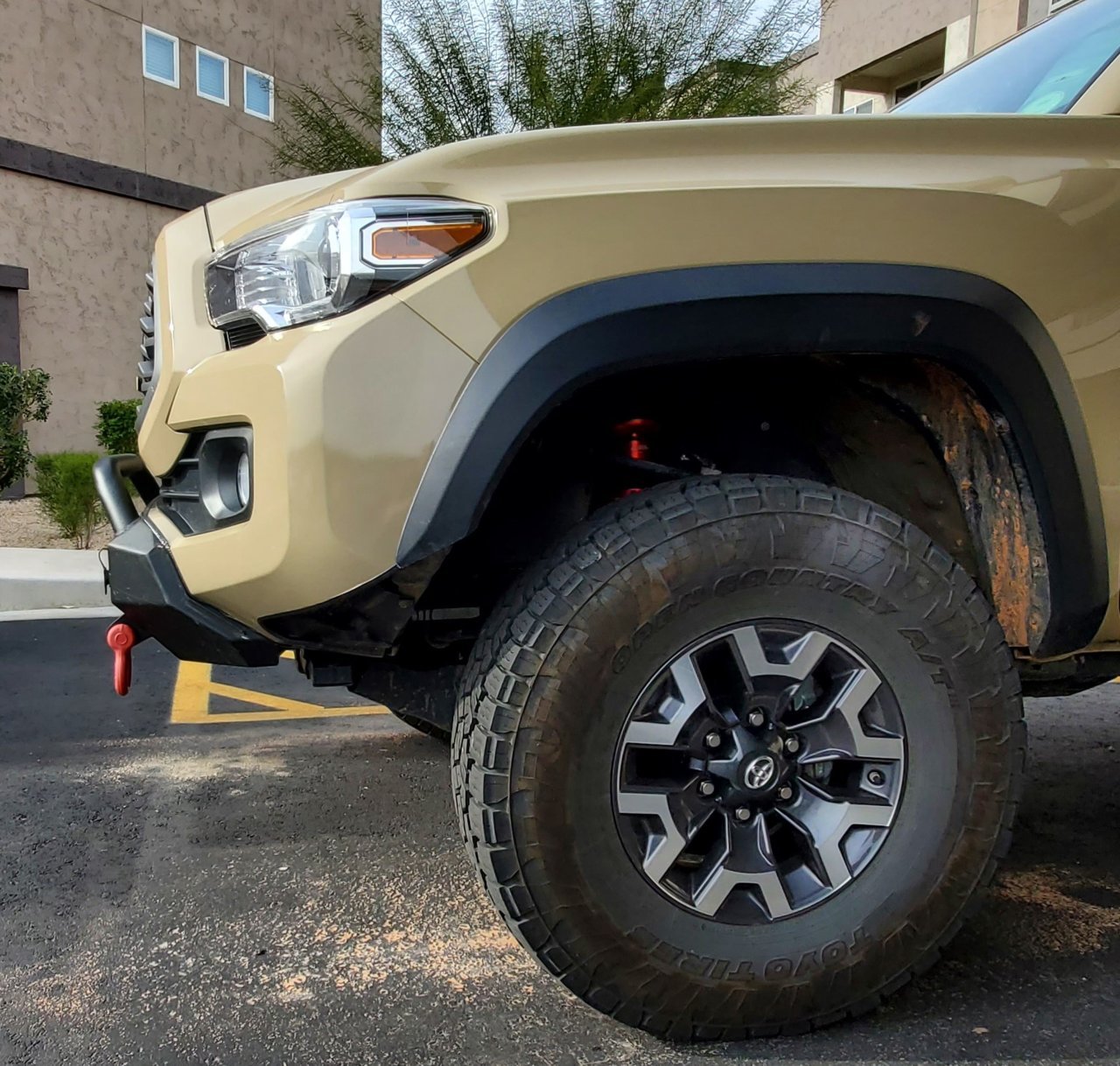

    I felt same as OP here, my truck was relatively new and I was spending money on lift, winch and bumper, camper shell, etc. It was a big stream of money all at once :spending:
    But, I was making mine what I wanted it to be: an attractive but functional off-road weekend warrior. Did I need new rims...no. I was able to fit 33" tires on my OEM rims with a basic lift from Toytec. It is THE RIGHT size tire for me, lots of traction and clearance and the cost and difficulty curve rises sharply to install anything larger. Essentially, I spent my money on things I needed, not things I wanted.
    I actually thought about having the rims painted but, by the time you pay for dismounting, remounting and the cost of painting, you could just buy new rims. So, I left the tires on, stuck cards around the rim to mask the tire, scuffed the wheels real well, wiped with acetone and a tack cloth. Prep is everything in paint. Then, I spray painted them. I added the OEM TRD center caps (also painted) and black lug nuts. Been on for about a year now. :thumbsup: Good luck on your choice!:cheers:

    That bronze belongs on the army green, looks awesome.

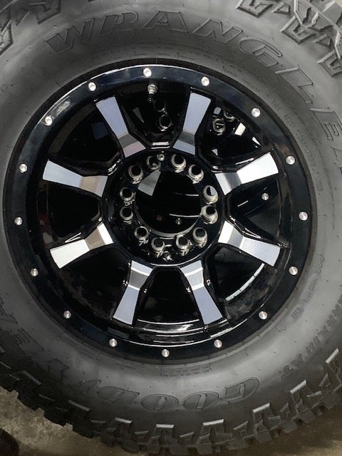

    These were purchased gloss black, I used a brushed metallic (self adhesive) film and made the spokes appear anodized/machined. The film is an actual metallic type, not vinyl so they're super durable. The film is available in different colors.
    You can get pretty creative with wheels and make something unique. They make an anodized gold, red and blue film.
