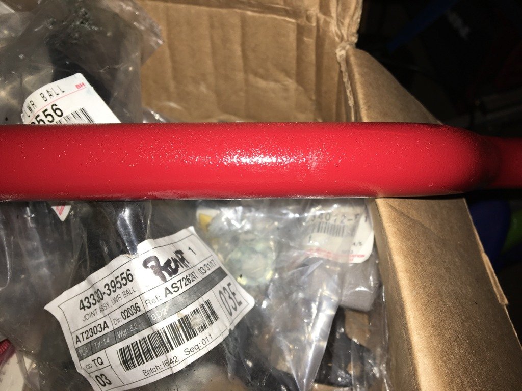

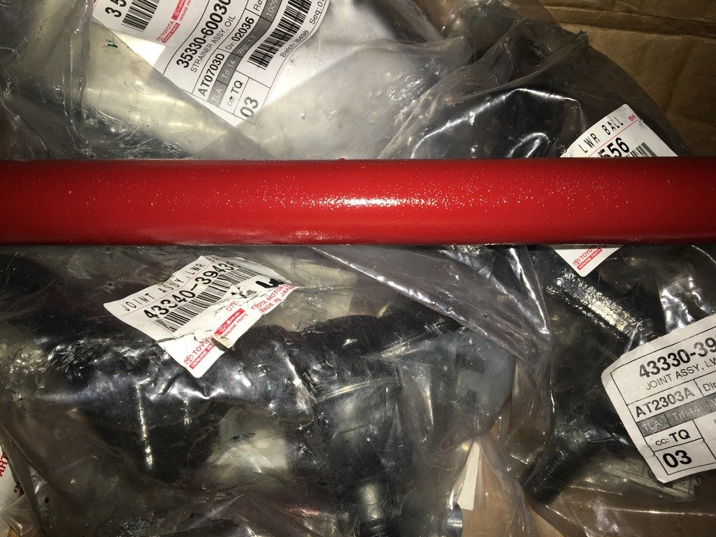

    Here are some pics of the painted sway bar. Under the red paint is truck bed liner. It still has a little bit of the texture. I took a "close up" so you could see it, but the parts where the bushings and end links go on the sway bar are smooth. It took 2 light coats before the black of the truck bed liner stopped showing through, then I finished it with a thicker coat to give it a little shine and glossy look. It took paint really well.

    That's a great finish over the bed liner
    I wonder what red would look like on the pinch weld haha.....probably end up sticking with black.
