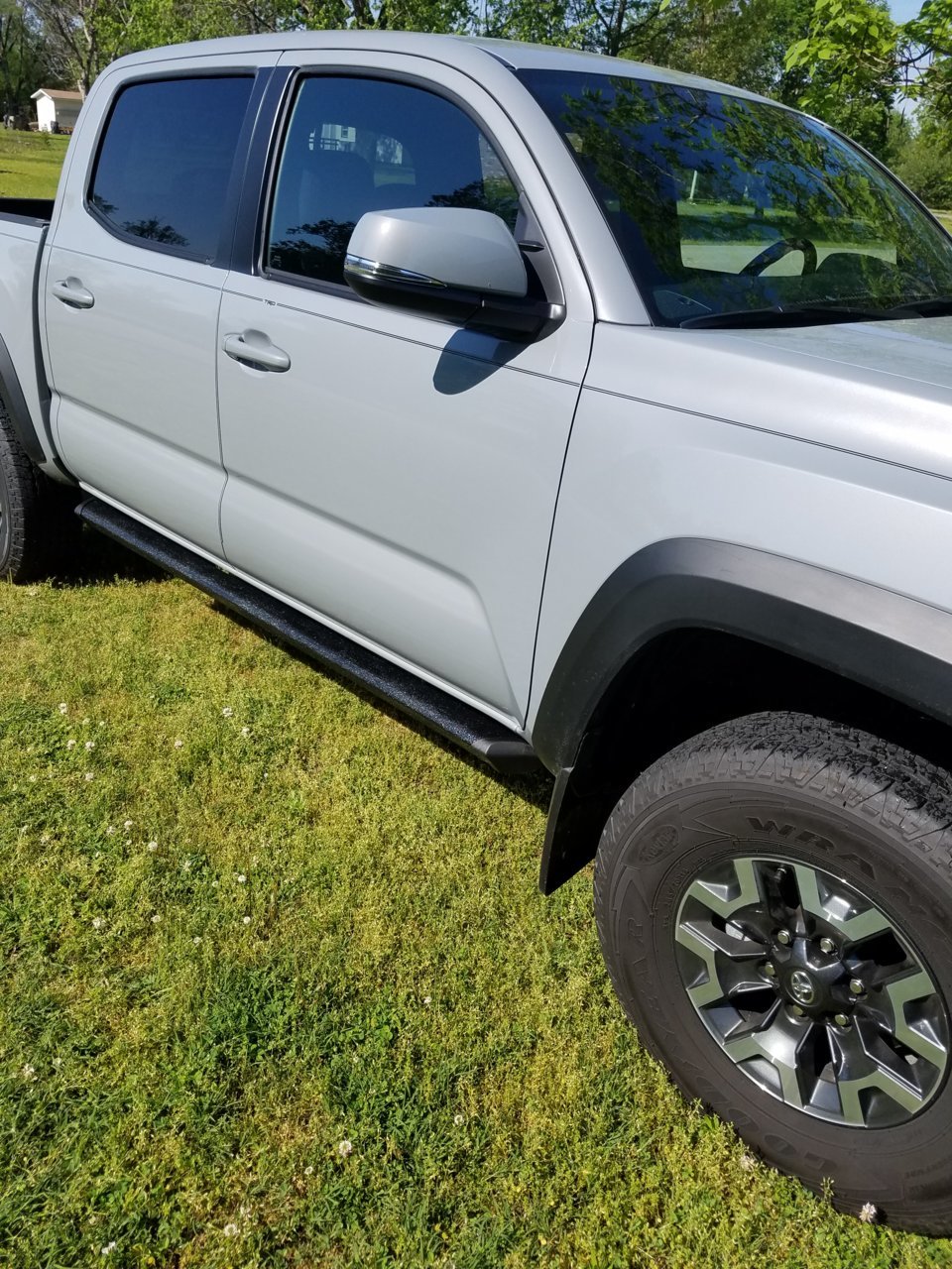

    It ain't much but I cut the steps off of my predator steps then applied Herculiner with a brush.
    shakerhood, 71tattooguy and Hobbs like this.

    I like it!! Looks awesome without steps
    StayinStock[QUOTED] likes this.
