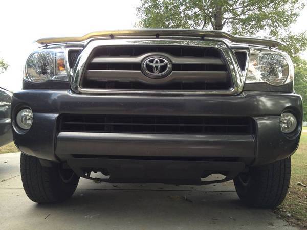

    I used satin black on mine, came out fine. While you have it off you can mod it to fit a little tighter to the bumper, looks a lot better than that huge gap.

    The TRD plate goes over the factor plate. It's really just a cosmetic piece, it's just thin aluminum. Yes, the rear plate is on also for a total of three. I got mine to fit up to the bumper with a bit of modding. First is to lose those aluminum spacers. Then had to cut some metal from the brackets like this:
    Then trim of the tabs on the factory plate:
    It's a tight fit around the tow hook and you need to bend it a little to it's new home but it works.

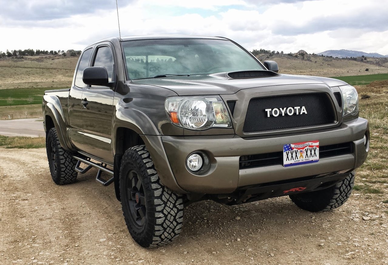

    Plastidip is your friend. It's easy to apply (just spray it on) and doesn't chip the way regular paint can. Plus, if you decide you don't like it, simply grab a corner and peal it all off in a single sheet and your finish underneath is exactly how it was before you painted. It's a rubberized coating so it's durable too. I dipped mine along with a lot of chrome trim pieces on other vehicles in the past and they've lasted for years. Here's mine that I sprayed with Plastidip w/o any prep or extra work. Just spray a few coats on and call it a day.

    LUSETACO, your install looks great! I see so many of those hanging down and I always thought that they look like heck, especially fitting poorly and being light colored. Your mod makes it look more like it belongs on there.
