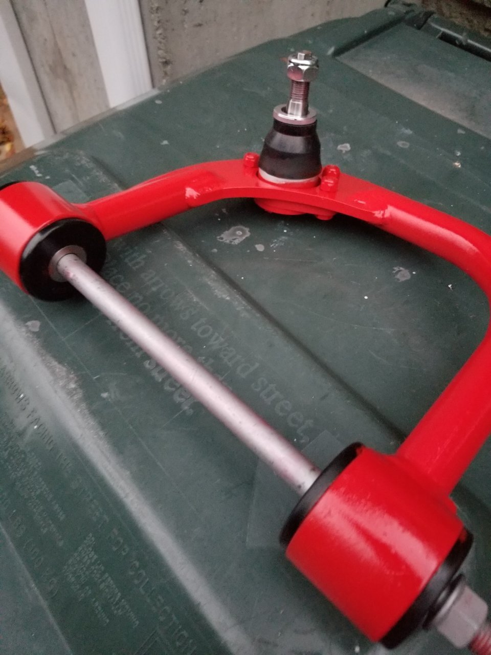

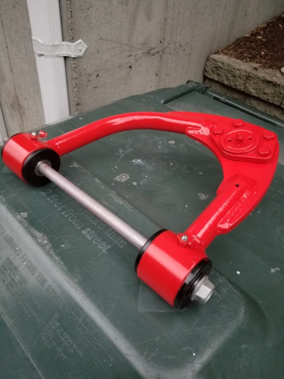

    I lightly sanded my new set of JBA's and painted them in Rust-Oleum Professional Red, the used Clear Epoxy and they came out the bomb. I sold them to @SR-71A and even through the Maine Winter they still look new. I'm going to do another set in Blue to match my Kings. The picture with the Kings in it is his truck.

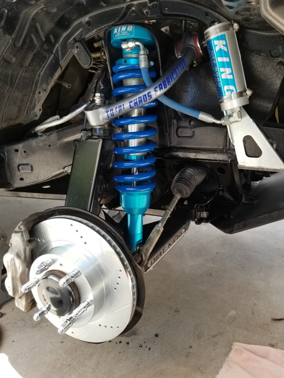

    I refurbished a pair of SPC I just cleaned them up with degreaser, lightly sanded them and then a couple coats with Black Enamel spray paint. The sort of glossy stuff for tool boxes and wheel barrows, etc. it supposed to be a little tougher than regular rattle can paint.

    Those look great! what grit sand paper did you use?

    Red scotchbrite pad only.

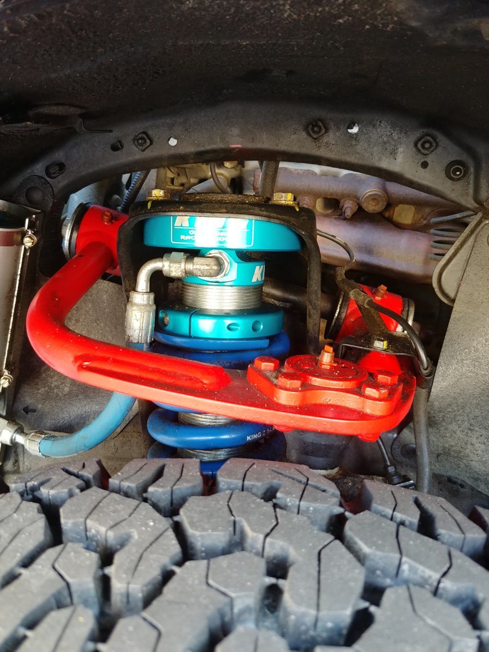

    Fluid Film helps a ton too! (everything was just pressure washed right before that pic was taken)

    And they still look new
