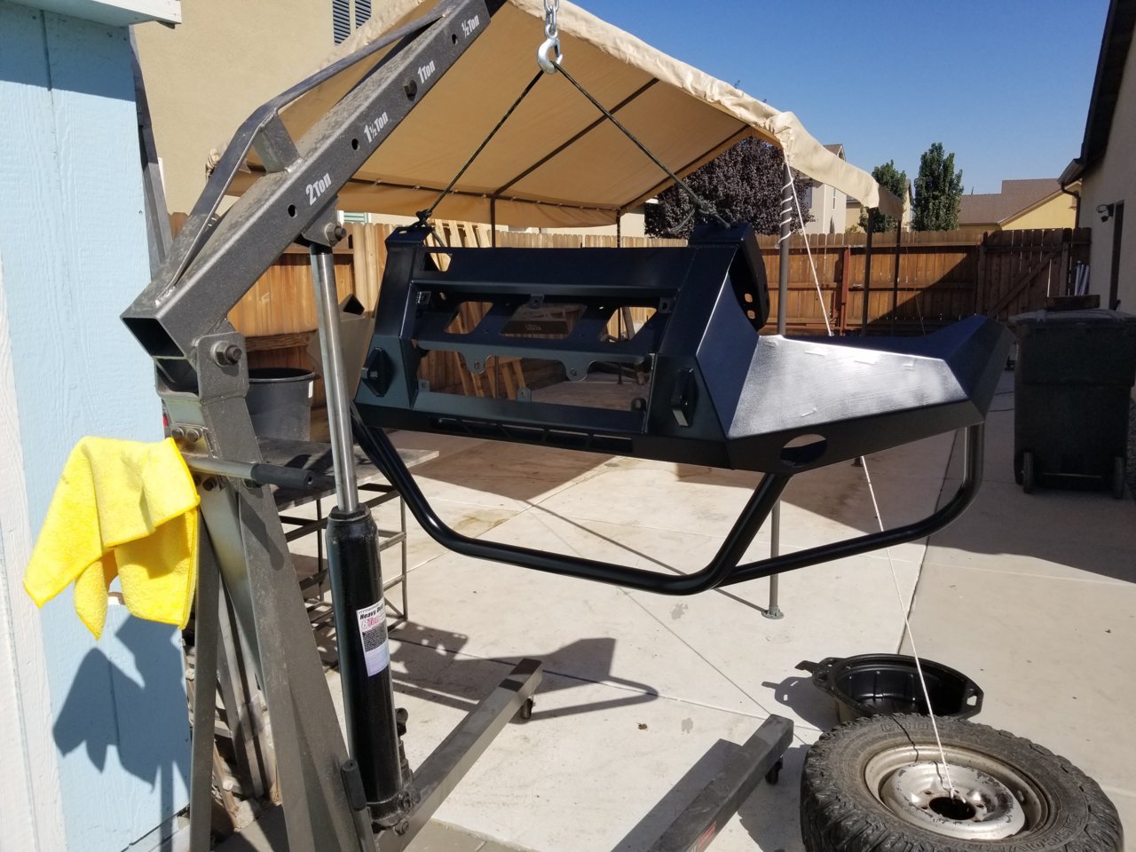

    I just primed mine and used some rustoleum semi gloss paint. I usually use the pro stuff but this time I just went for some regular spray paint. Time will tell how it holds up.
