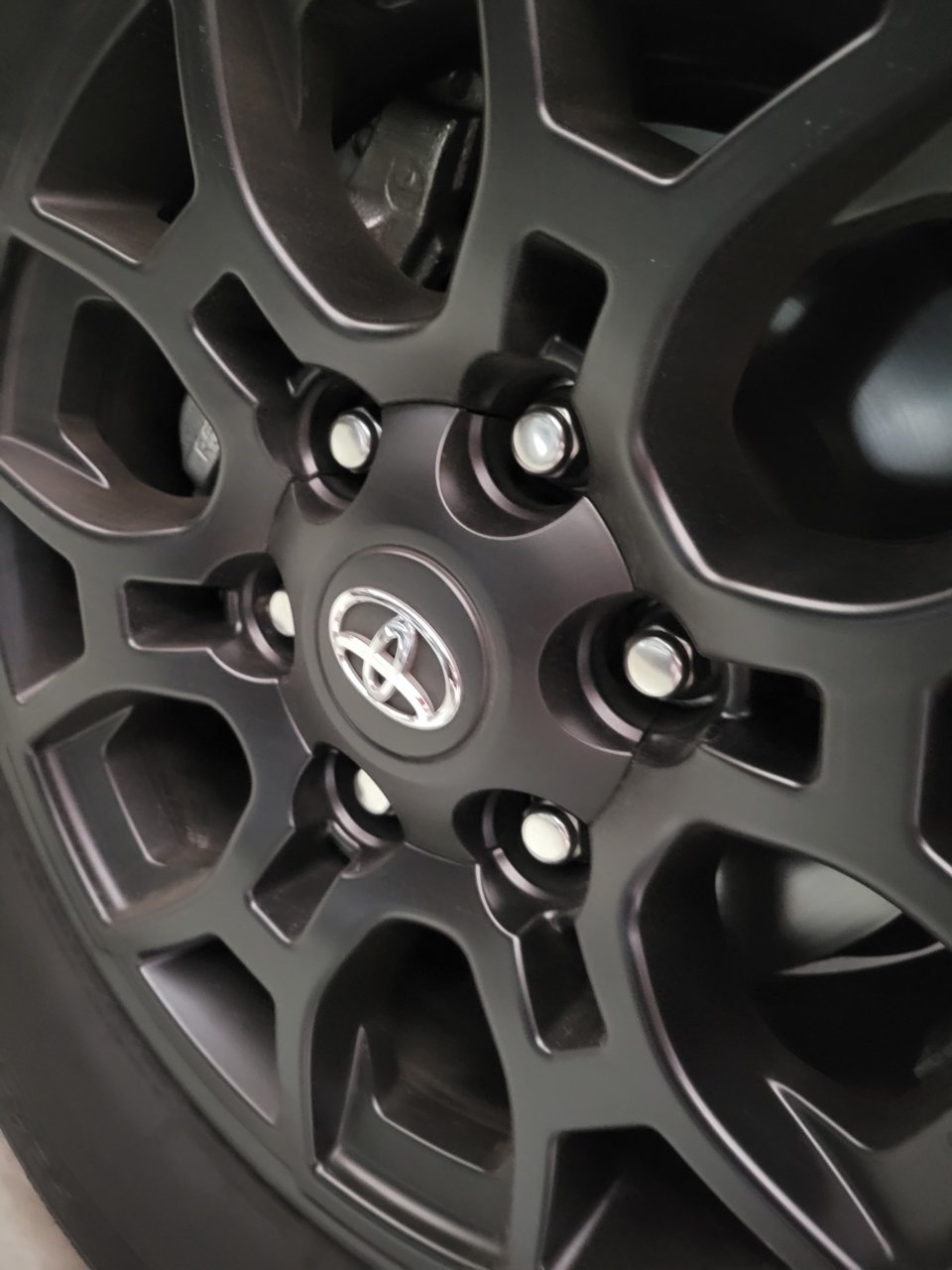

    So I tried the bleach method first. 3 days later with changing the bleach twice a day, no changes, just a little black residue floating. Sorry, I was impatient with these. Took them out, cleaned them off and sanded with 400grit paper. Not a perfect sanding, just enough to scuff up the chrome. First put some primer on, then some satin black, then topped it with satin clear coat. Very pleased with the result!

    Looks great! I’m glad I did mine, made me not want to get rid of the OEM wheels like I initially wanted too.
