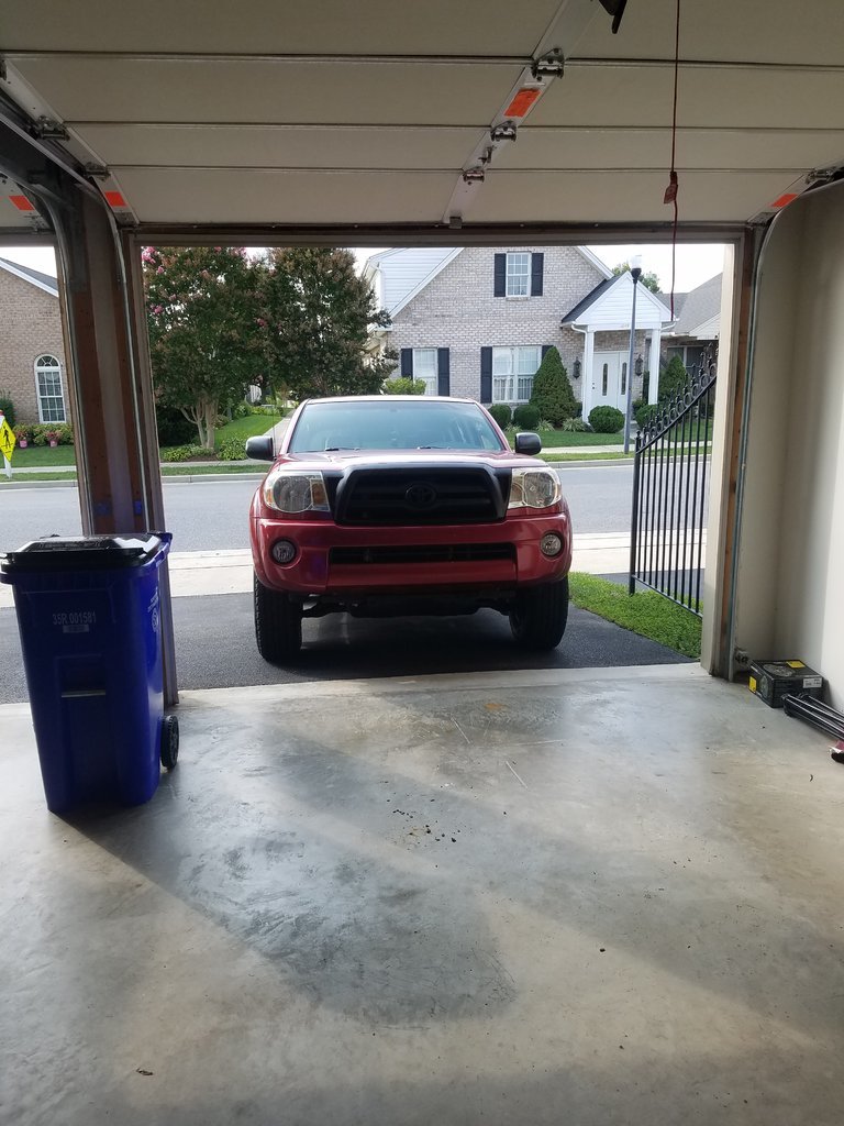

    DON'T USE UNDERCOAT!!! I bought a can of Rustoleum Black and a can of Rustoleum undercoat. The undercoat not only gives it a rough finish, but it does NOT react well with the paint. only a few minutes after I sprayed on the finish, The undercoat began to peel, but still under the paint. Let's just say it looks... well, Rough.

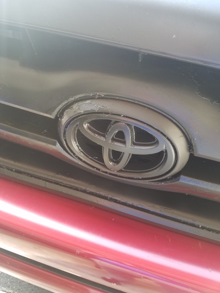

    But when you get close you can see the peeling and it's not just on the badge.
    I was thinking paint stripper and starting over, this time without undercoat, but if anyone has a better idea I am open to suggestions.

    You seem to be a good candidate for......Plastidip :thumbsup:

    Don't use paint stripper it will melt the plastic :thumbsup:

    :facepalm:ummm no. You still need to sand the shit out of it and make it smooth.
    But since you had such major issues spraying the bedliner....then I would just use plastidip that way the next fuck up can be easily removed :rolleyes:

    Why would you use undercoat on a plastic grille?
    Its a rust preventer not a primer.
    You must use a plastic safe paint stripper.
    Also did you let the top coat dry for several hours before painting over?? Paints and primers will chemically react sometimes if not COMPLETELY dry.

    Yup idk why I did, it just happened. I left it dry for almost 2 hours, but obvi that wasnt enough.
