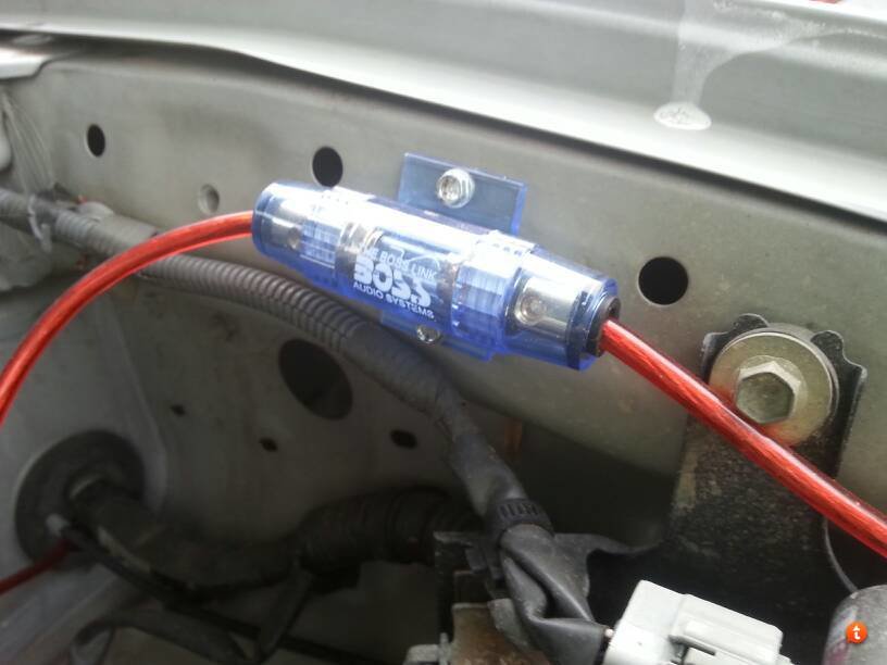

    I have a fuse already hooked up to the battery that sits in the side wall under the hood... are you saying i need a different size fuse ?

    You might. It all depends on the size of it currently. I just read through the manual online, and it looks like the Alpine takes a 40Amp fuse on the battery lead closest to the battery. Not sure what size fuse it is, ANL or MiniANL, a pic would be good, and I can point you in the direction of a shop to pick one up, or you could ask at the shop you buy the Alpine Amp.

    This is the fuse I know of haha.... vyqamuby_55deb3ca5402f484f897c2aa540fcaa1fa182ba6.jpg

    Hard to tell from that pic, but it's probably a 60Amp fuse. You'll be okay with it in there, as the Alpine has it's own 40Amp fuse too. If you want to be fussy, you could change out that fuse for a 40Amp as well, just to be safer, but it's not necessary. You should be fine with the Alpine amp.
    *edit* I just looked up the Kenwood amp manual, and in there, it's two 30Amp, or at the fuse you took a pic of, a 60Amp fuse. You'll be fine, but like I said, if you want to be fussy, get a 40Amp fuse. And that looks like a AGU glass fuse, fyi.
