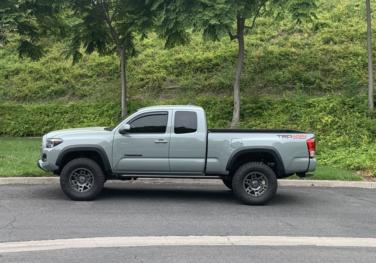

    I bought Deaver’s stage one, but from the research that I did, it seemed like they were less prone to problems, and they performed the way expected over the long term. I think the thing that drove me to buy them was that I didn’t want to be replacing leaf springs or messing with add-a- leafs once I got my topper set up.
    I’m sure there are other great companies and products out there, but everywhere I went, Deaver’s were considered top of the line.
    BTW I have 5160s in the rear as well and my stage ones were rated to take me up to about 300 pounds of constant load, which is still in the works. I’m not sure what my overall lift was after everything settled, but a pic for reference.
