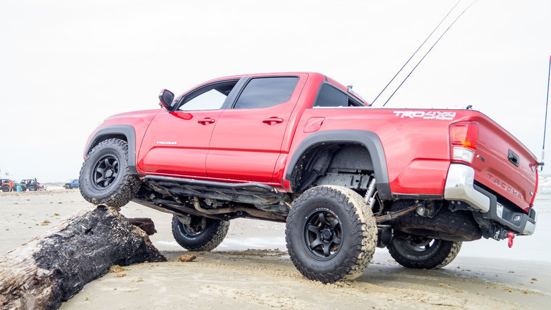

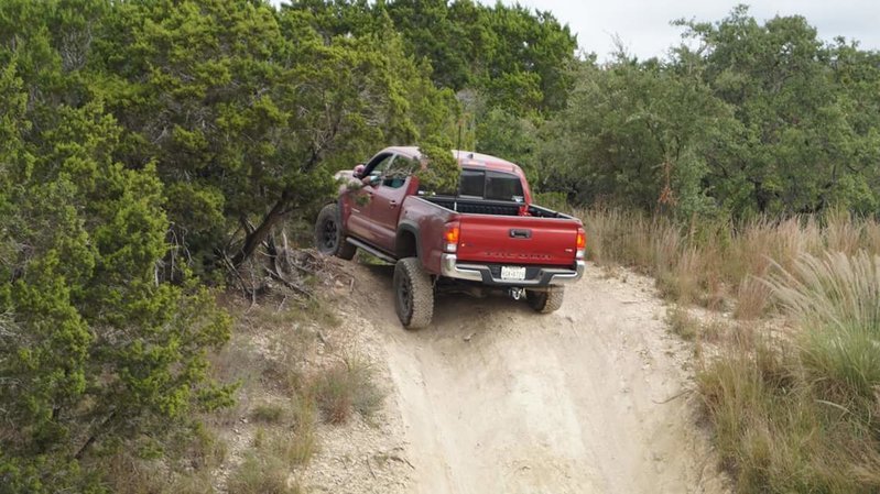

    Fox 2.5 RR C/O Fox 2.0 RR Rear Dakar leaf Pack Headstong Brakeline Extension Bracket 16"Konig Countersteer wheels BFG's KO2 285/75r16 All-Pro UCA 1.25" All-Pro APEX Slidders Unided CB w/ Firestick II Lamin-X fog Lens 1" Diff Drop OME 1/2" CB Drip OME Mobtown 3/16" Skid plates: Front, Trans and Transfer case Relentless Hood Brackets AuxBeam Ditch Lights DBCustons Grill "Recolored" Matt Black Relentless High Lift Mount Softopper Diff Breather Mod Tail Gate Inserts HondoGarage Tablet Vent Mount Weather Tech Floor Liner
    If you plan on running a shell and RTT than go with Dakar leaf packs. The standard leaf pack will be a little stiffer but it will sit at 2.75" in the rear unloaded. Depending on what size lift you go with 0-2" or 0-3" fox 2.5 coil over I would tell you to keep the standard dakar leaf (2" front lift) or add a leaf with the standard dakar leaf (3" lift). You can add an additional leaf pack that's rate for carrying ~300 # regularly. The options are on the link provided below. I run Fox 2.5 w/ RR 3" lift in the front and 2.0 w/RR extended travel for 3-5" of lift with a standard dakar leaf pack running at 2.75" lift in the rear. I have extended travel shocks in the rear to achieve the greater droop. Right now the shock is still the limiting factor with roughly 1.5" more droop available from the leaf pack.
