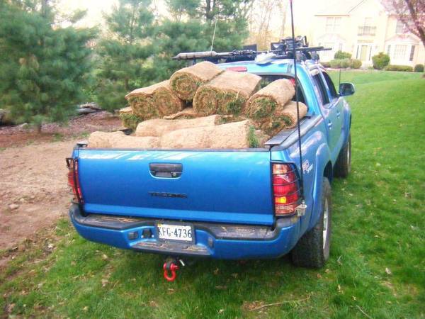

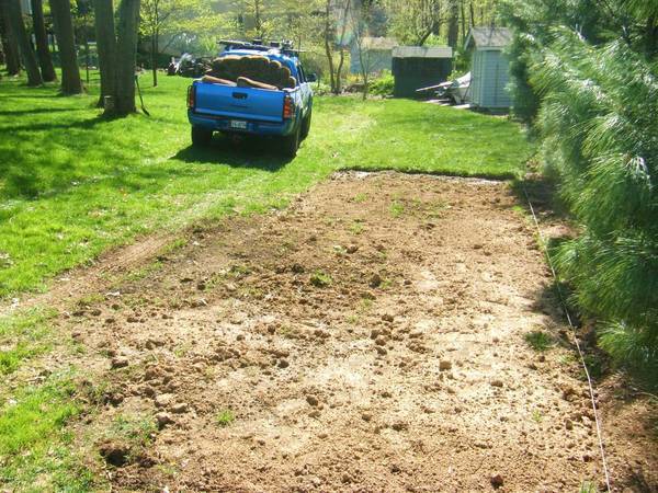

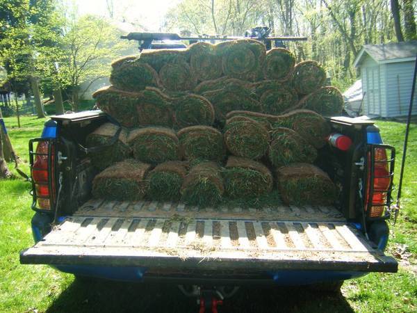

    i did some sod work about a month ago. i had to make 3 trips to the sod place, each time i got as much as i could. the max (safe amount) was 35 rolls (2' x 5' rolls) or freshly cut (wet) sod. eash roll weighed about 45 lbs (1575 lbs total load).
    the truck handeled it well, but anymore would have been unsafe, and bad for the truck.
    here are some pictures of it...
