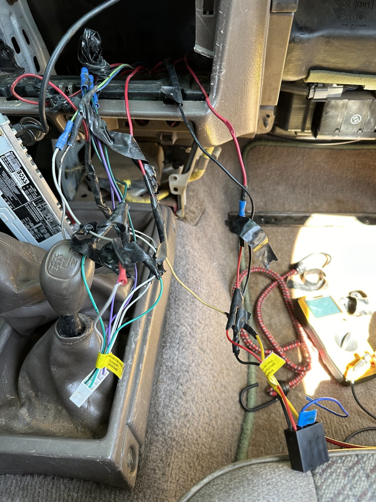

    Here is what I am dealing with

    The red wire on the right of the picture has been pinched from the looks of it . You might wanna start looking into those butt splices. Some weren’t properly crimped and they taped up the exposed wire.

    The crimped one looks like it would be the Accessory power wire. The accessory power seems to have to no issue. I removed all of the electrical tape and the crimp connections look okay, no exposed wires
    It does not blow the fuse until the headlights are turned on. But if the stereo is disconnected, the fuse does not blow when the lights are turned on. It does have aftermarket headlights
