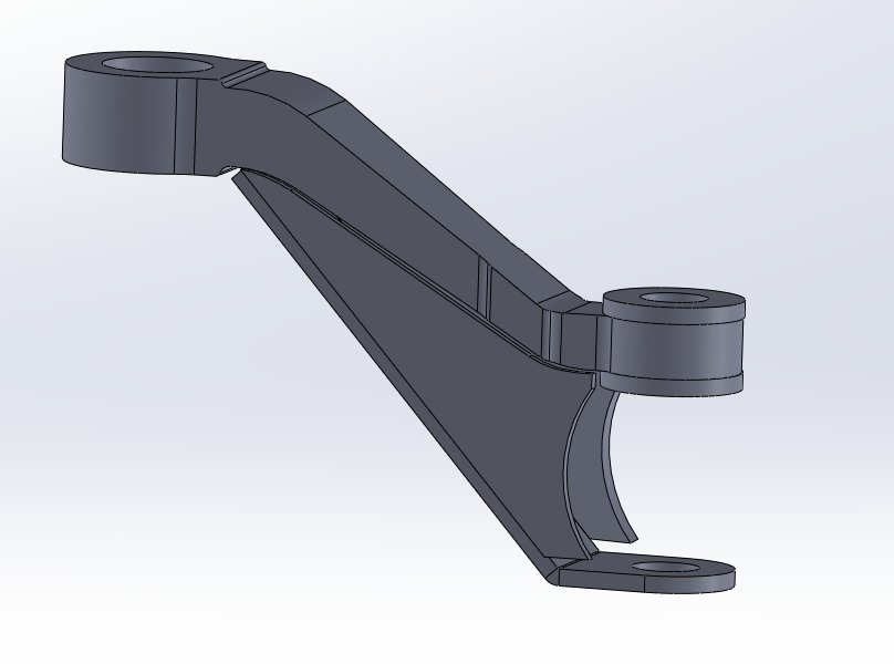

    I also have plans to double sheer the OEM Toyota pitman arm. I'm still working on this one but it'll look something like this:

    Mine's done with Cardboard Assisted Designed :rofl:

    Hey all my ComputerAD starts with CardboardAD!
    How has that been holding up? My buddies coworkers at Solo Motorsports all say I'm wasting my time doing it this way.
  5. Jan 13, 2023 at 2:59 PM
    #25
    02hilux
    02hilux What do you mean there’s no road, I’m here
    Sep 14, 2016
    #197244
    6,310
    Planet: EARTH
    What's a waste of time? CAD or a double shear?

    Yes but I think they mostly meant the double sheer idea in general.

    Would you mount your CO on a single tab? Same concept.

    My buddy got lazy and did his pitman arm without a double shear. After 2 year, there's significant play in his steering while driving. Took the 3/4" bolt off and noticed his pitman arm hole is enlarged.

    Exactly! I guess they do make double sheer pitman arms but they cut the factory pitman arm off, only keeping the splined ring, then build off of that. IMO seems less strong than plating the factory one but who knows...

    I went with a chromoly pitman and still add the double shear

    I'd love a chromoly pitman arm but I need the long droop from the factory one
