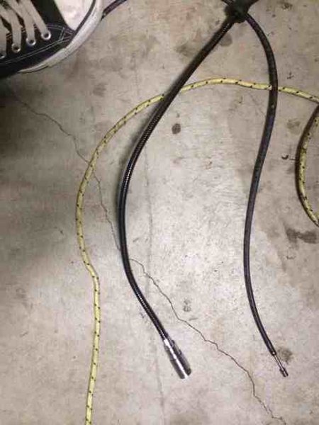

    Pfff I'll tell you the outcome, I'm gonna man up and pull that **** out!! Haha. Jk, thanks for subbing . I'll keep y'all in the loop. Here's a pic of magnet tools I tried - totally worthless. One is vaccum tubing with a trimmed magnet tool for extra flex.ImageUploadedByTapatalk1388197040.353383.jpg
