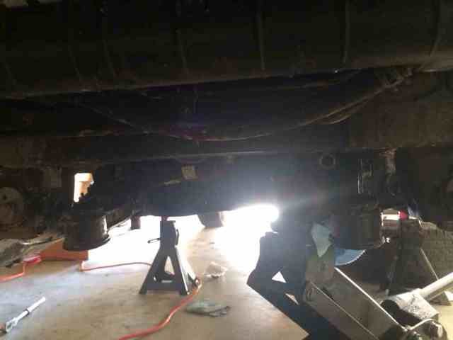

    Ready to drop - waitin on extra hands. This was EASY with electric impact.

    This is where we are now.
