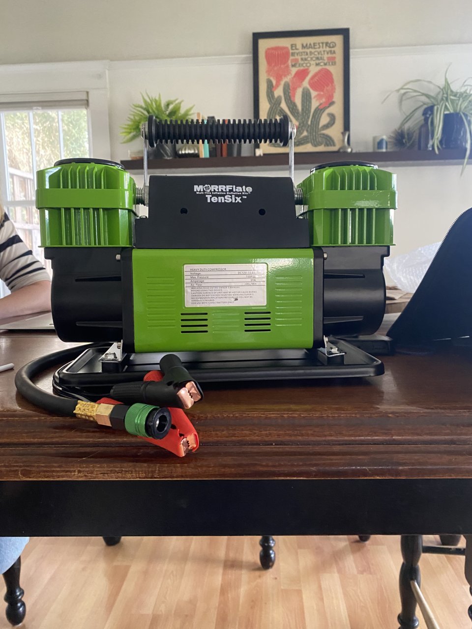

    This is your captain speaking… we have onboard air. Shout out to @Morrflate

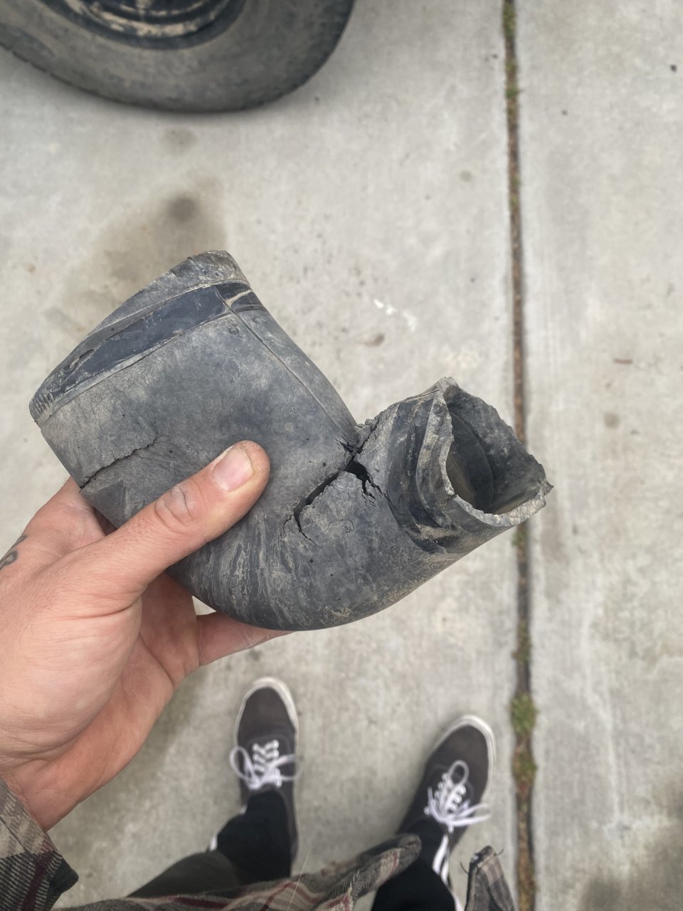

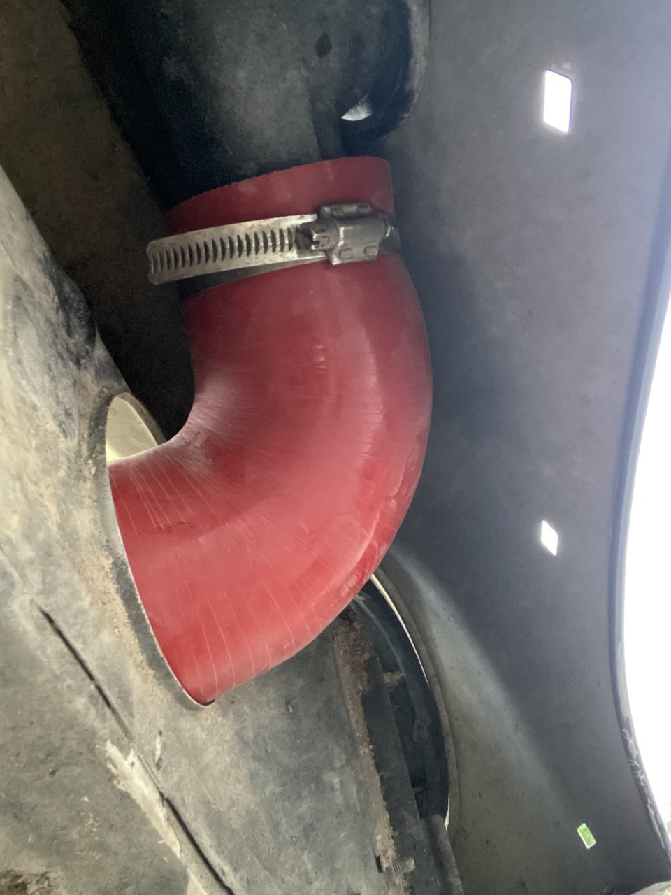

    Check your rubbers kids…. Been trying to figure out this one for a while. Turns out a simple 90* 3”x3” silicone hose from Amazon for $16 was the answer. Hopefully the snorkel is air dry now.

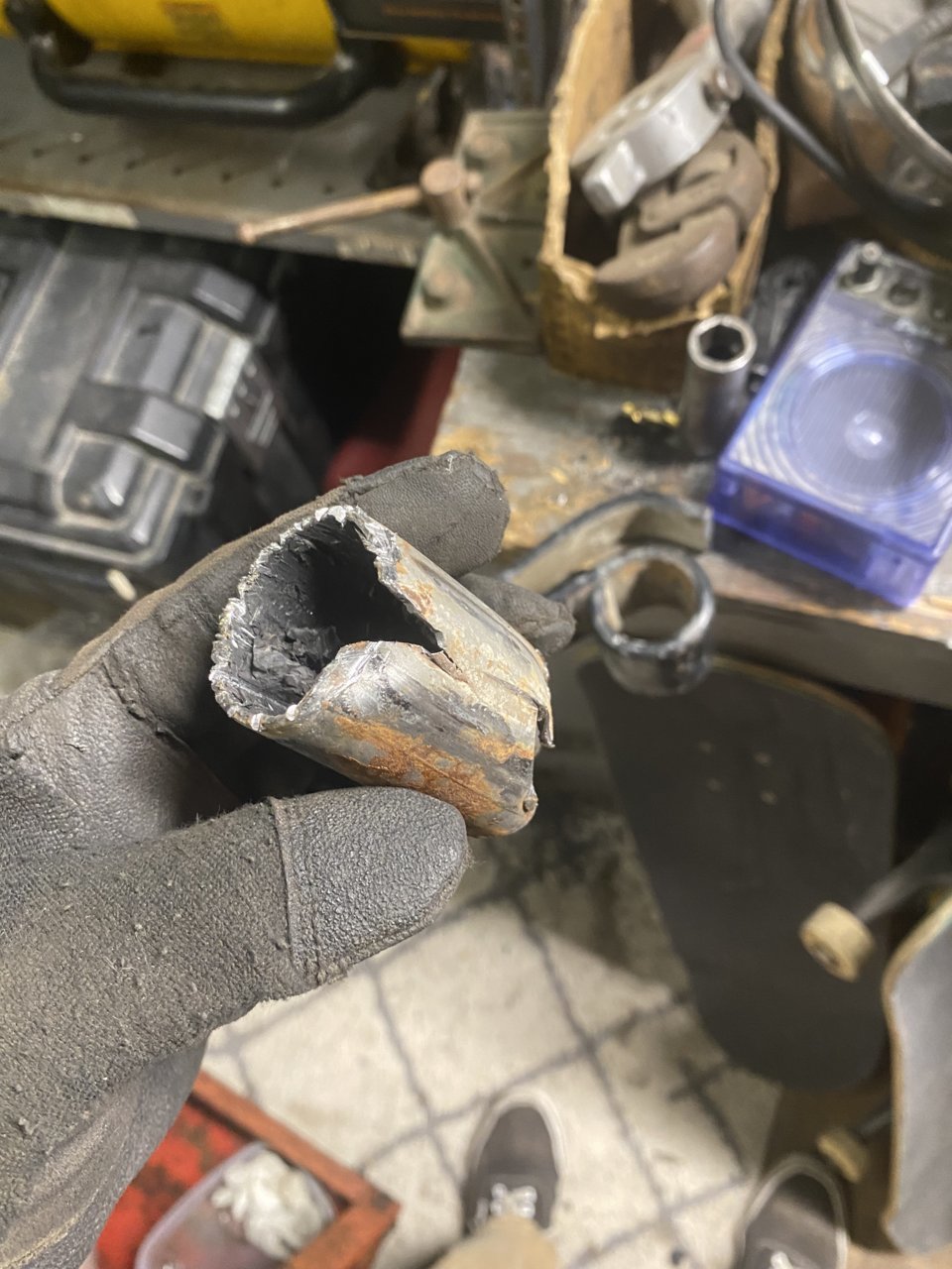

  12. May 5, 2023 at 10:23 PM
    #1332
    Papa Taco
    Papa Taco [OP] HARD CAAAAAAARRRRRRRL
    Feb 20, 2013
    #98004
    8,874
    Jared
    Socal
    2011 Access Cab 4x4 6 Speed
    Follow the yellow brick road
    Truck boy shit continues….

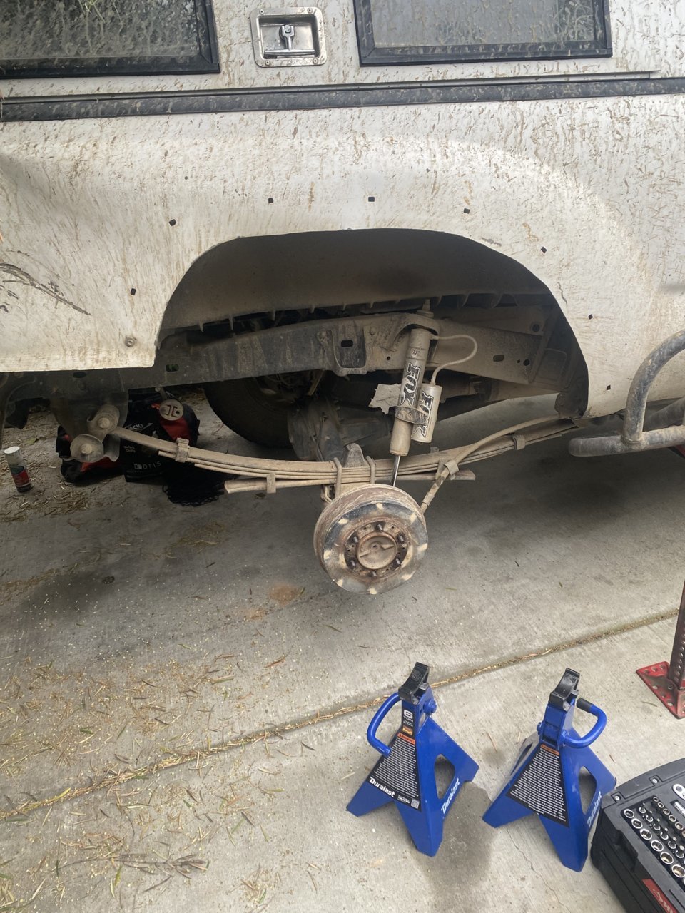

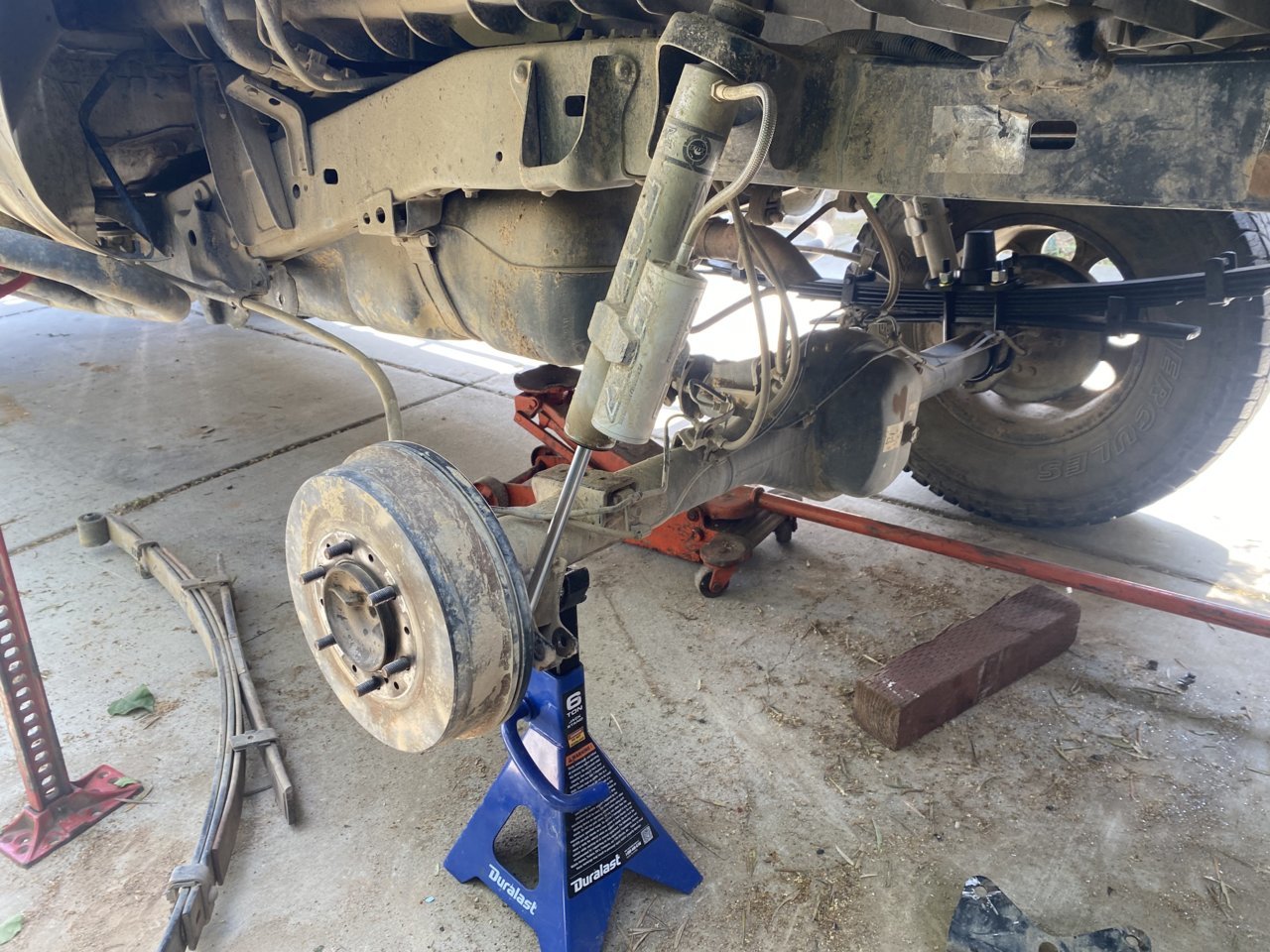

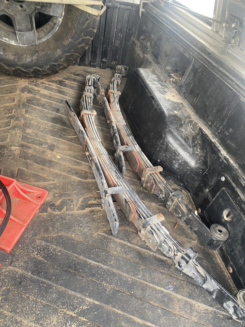

    Old n busty meet new hotness
    Up till 1:30 am, got both leafs ready. Hopefully rear end will be back together tomorrow.

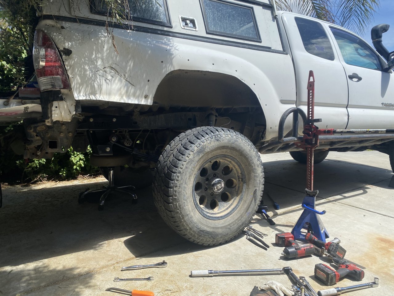

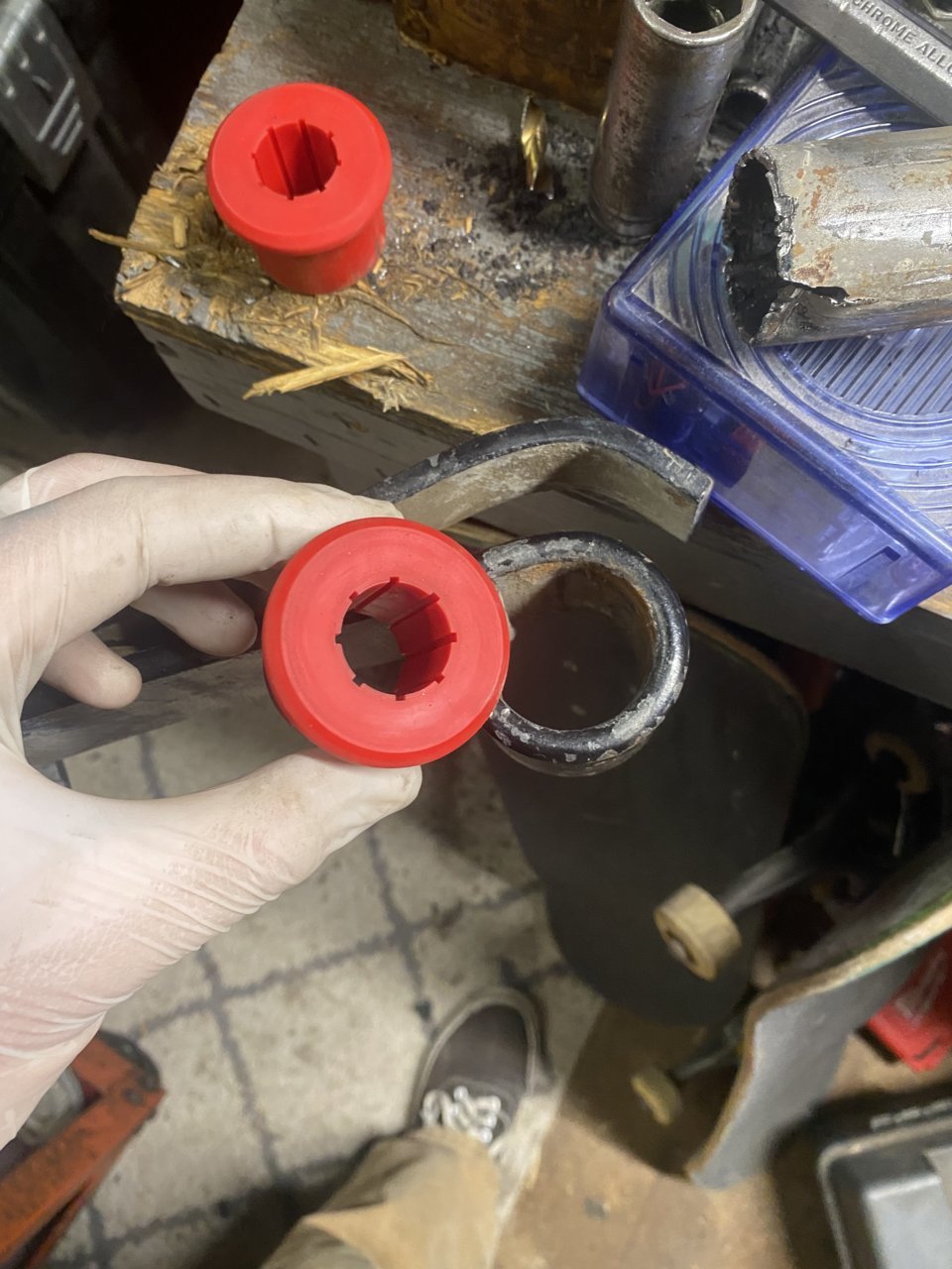

  15. May 6, 2023 at 5:23 PM
    #1335
    Papa Taco
    Feb 20, 2013
    #98004
    8,874
    Jared
    Socal

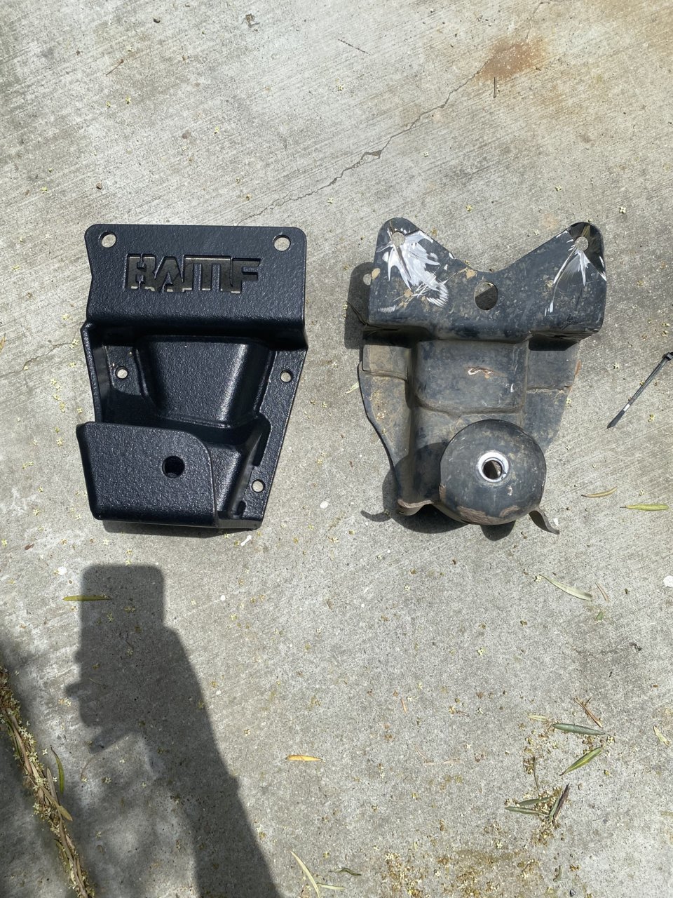

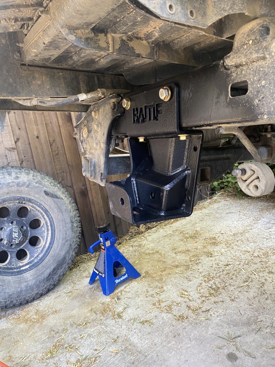

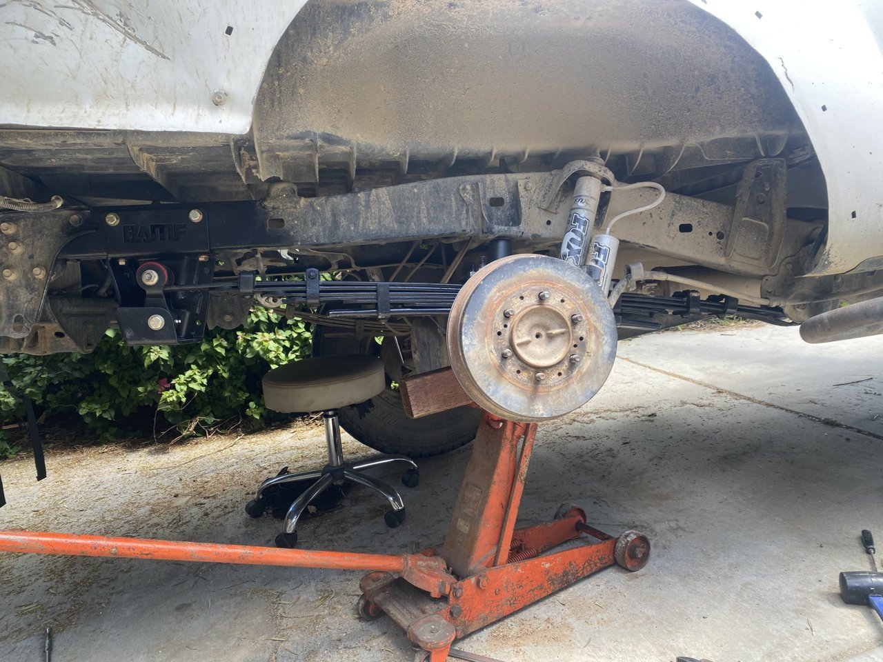

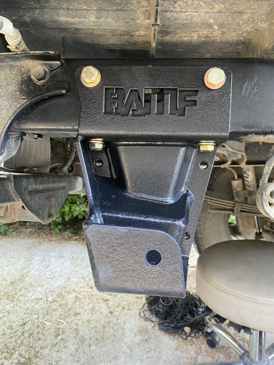

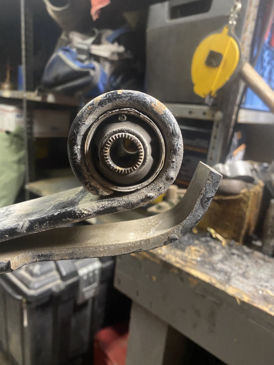

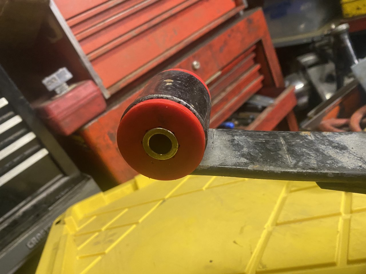

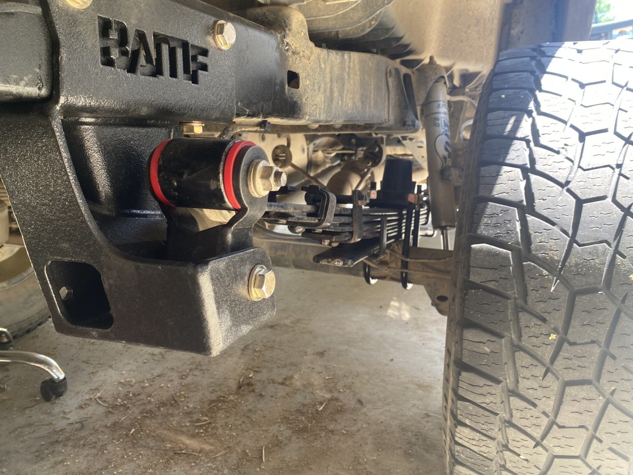

    New bushings in. New hangers in. Just need to drill this bushing out to 9/16” for the new shackle bolt then should be able to start bolting it all together.

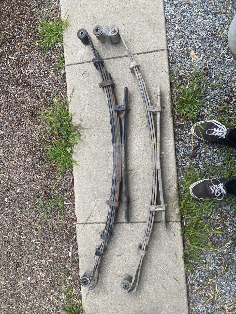

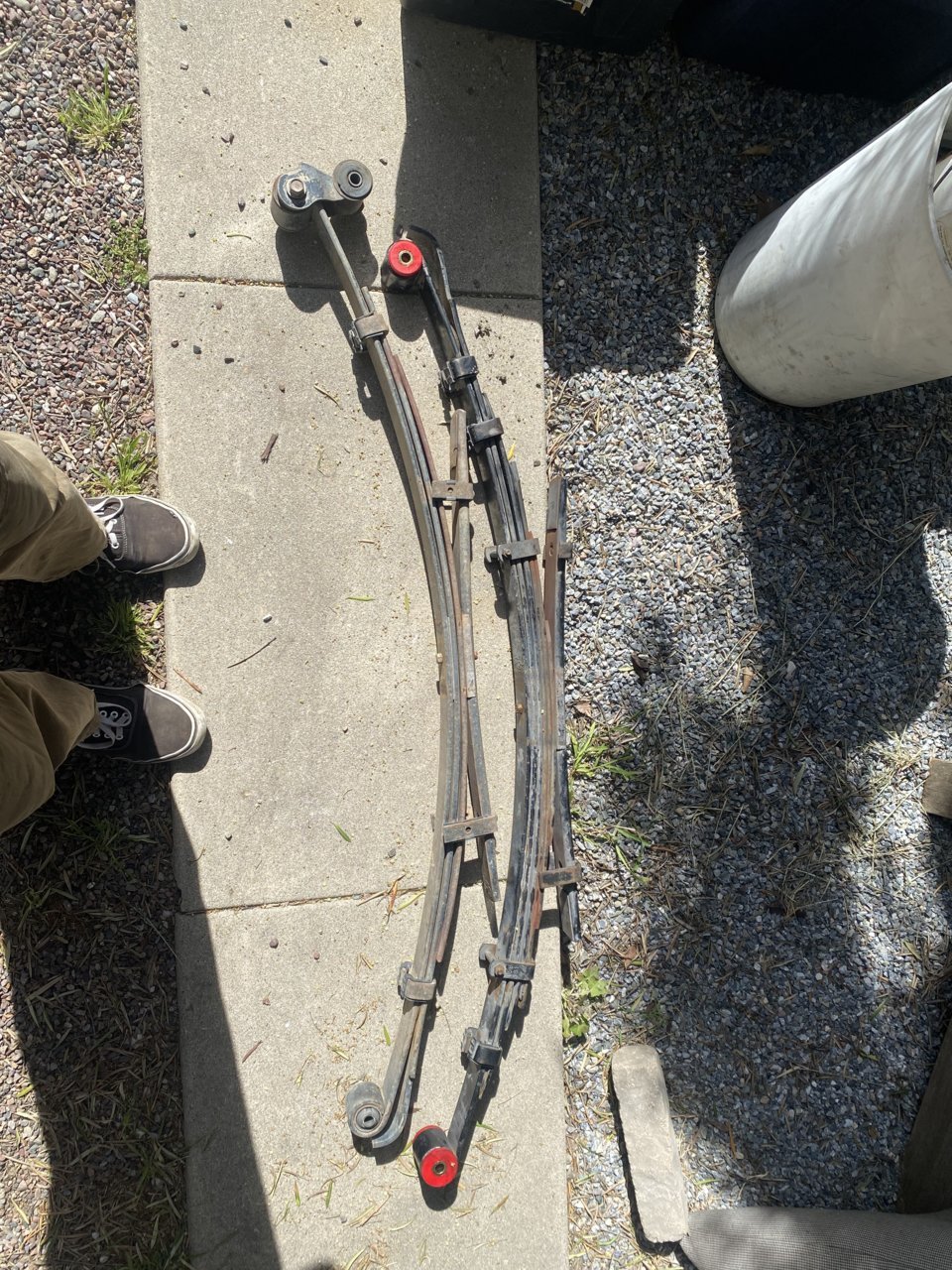

    Old to new.

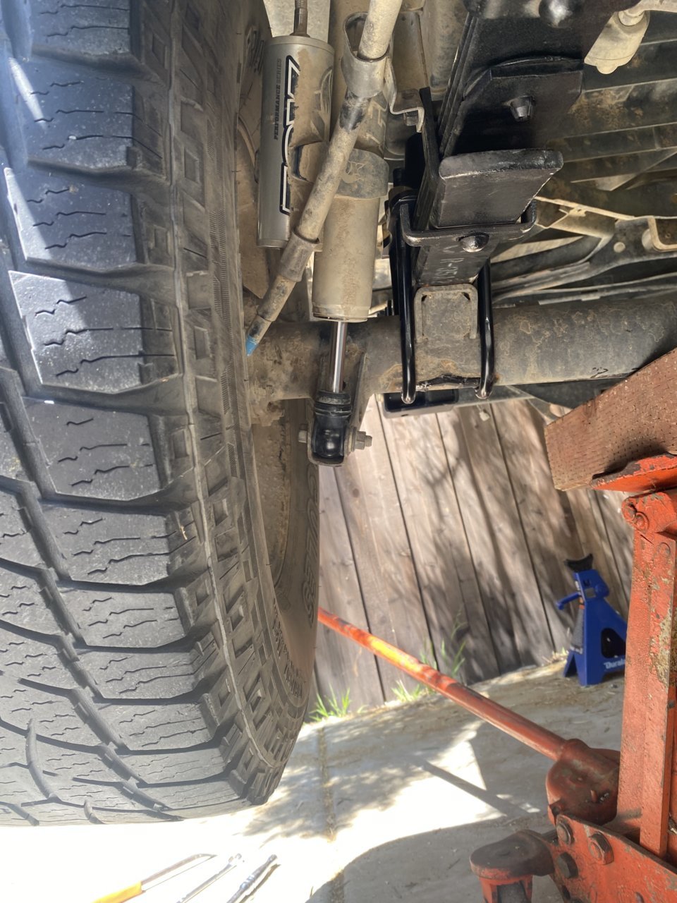

  17. May 7, 2023 at 12:00 PM
    #1337
    Papa Taco
    Feb 20, 2013
    #98004
    8,874
    Jared
    Socal
    One side down.
    full compression
  18. May 7, 2023 at 12:07 PM
    #1338
    Papa Taco
    Feb 20, 2013
    #98004
    8,874
    Jared
    Socal
    Flexing in the driveway.

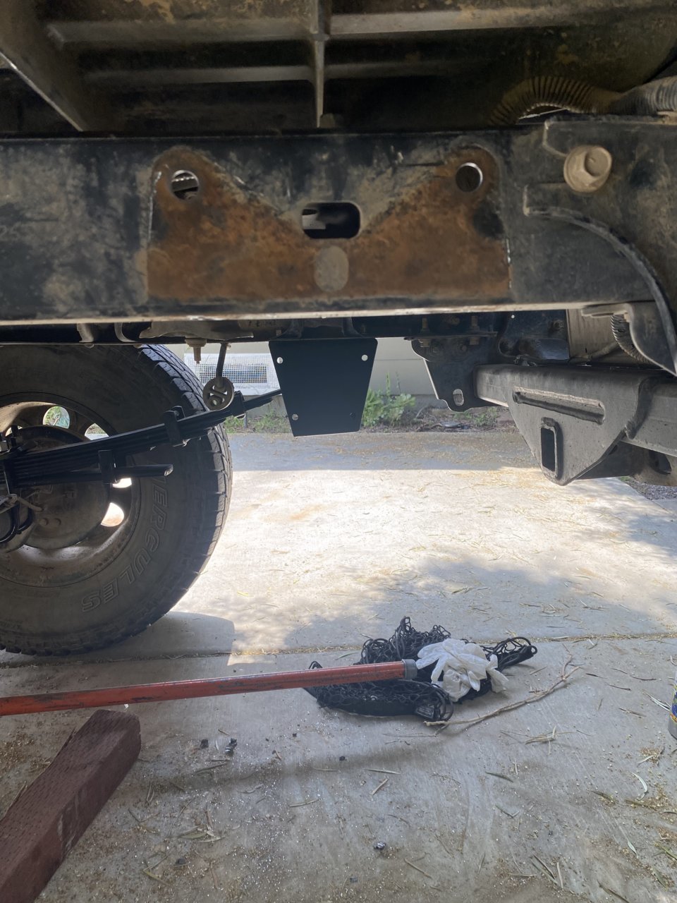

    Side two halfway there
