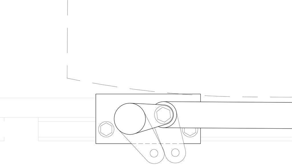

    Everything is Great! The side project is coming along. You've seen the design already but here it is for everyone else to see:
    Colin helped out with some of the details. Thanks Colin!

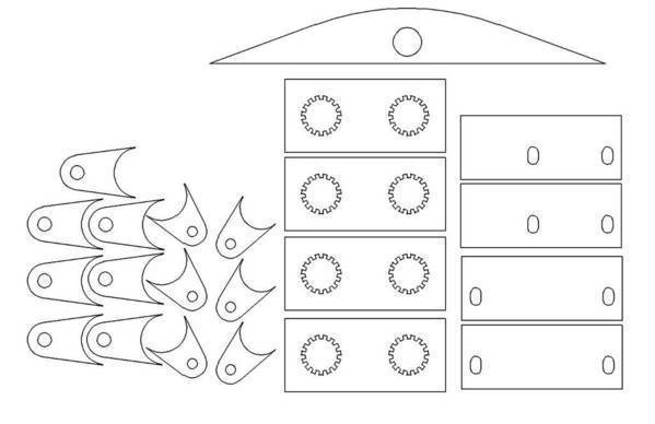

    Got the Energy suspension pivot bushings and turn down yesterday. I will be picking up the tubing today. My buddy works in a machine shop so, he will be cutting sheet metal pieces con a water jet.
    [​IMG]Hopefully get them the beginning of next week. I will cut all the tube pieces this weekend and practice a few tube welds. Been practicing all types of sheet metal welds over the past week.

    Looks good, I'm running a similar tire carrier. May I suggest making a plate with 1 or 2 studs (can just be rod) spaced in the orientation of the lugs on the Tacoma, and have the center drilled out that way the tire is centered on the A-Arm mount :cool:
