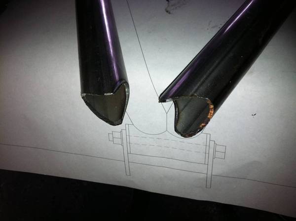

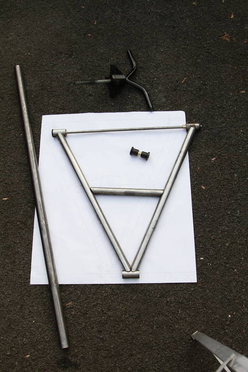

    Getting there! Fish mouthed al the tube ends to size, made the bushing carriers and tacked some of the pieces together.

    I am getting a feel for it. The toughest part is welding those fish mouths. Been practicing on them a bunch. The first few I didn't have the gas coming through the tip... I then realized the hose wasn't plugged in all the way at the box. lol Im a dumbass.

    the points to the notches can be a little tricky sometimes since you're dealing with less material there. just gotta ease off the bedal a little more

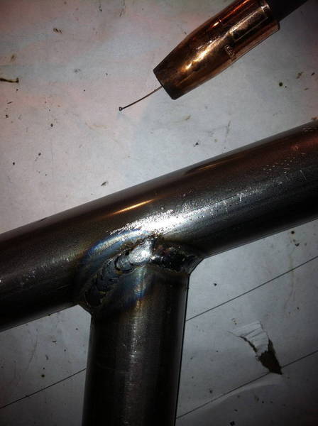

    Here are some welds I made on the tire carrier. Of course I am showing my better ones. The three pipe y connect came out a little funky. I should have done that one last as it was the hardest to do.
