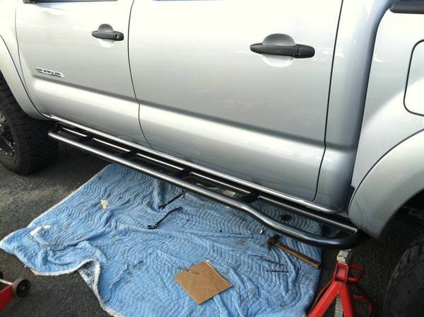

    I got my sliders from 4x innovations yesturday. These things are beefy.
    I got all the welding pops off with a file, cleaned the metal with marine clean, etched it with prep and ready, put two coats of POR15 and two coats automotive single stage paint.
    Here is how I installed it
    -take out the bottom cross member bolt
    -get the slider into place and put a tapered head bolt into the hole of the cross member bolt.
    -put a side bolt in near the most rear side bolt hole that needs to be drilled
    -mark the rear side plate hole with a center punch
    -unbolt everything and take the slider down to drill the rear hole
    -put the slider back into place the same way as earlier
    -put all the side bolts in tight to snug the plates to the frame.
    -mark the bottom tapered bolt holes with a center punch
    -drill all the holes
    -I painted the holes I just drilled with por15 so they don't rust
    -loosen all the side bolts and bolt the bottom bolts nice and tight
    -go ahead and tighten all the side bolts
    The only bolt (on each slider) I wasn't able to do was the tapered bottom bolt in the front. It's in the boxed out section of the frame and there is no way to get your arm back there and get a nut on that tapered head bolt. I suspect that holes need to be drilled and tapped. there really needs to be a bolt in this position. I hope to hear from Adam tomorrow.
    The plates matted perfectly to all the holes and bolts on the frame. No modification required at all!

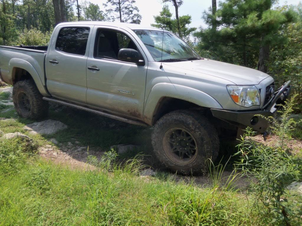

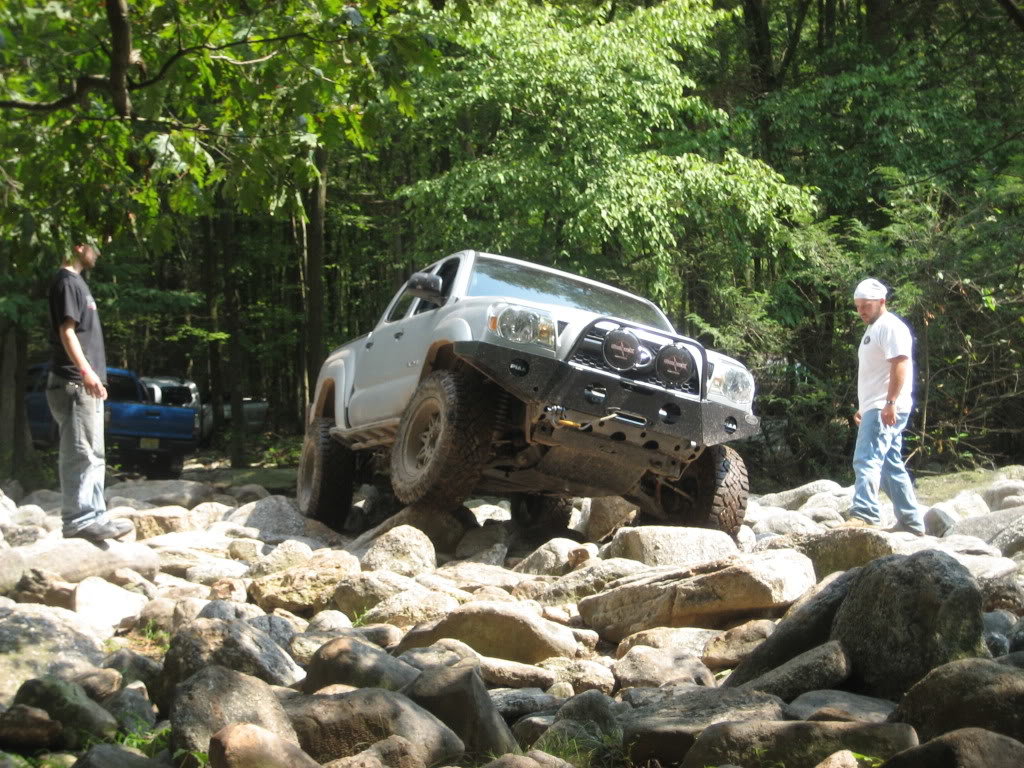

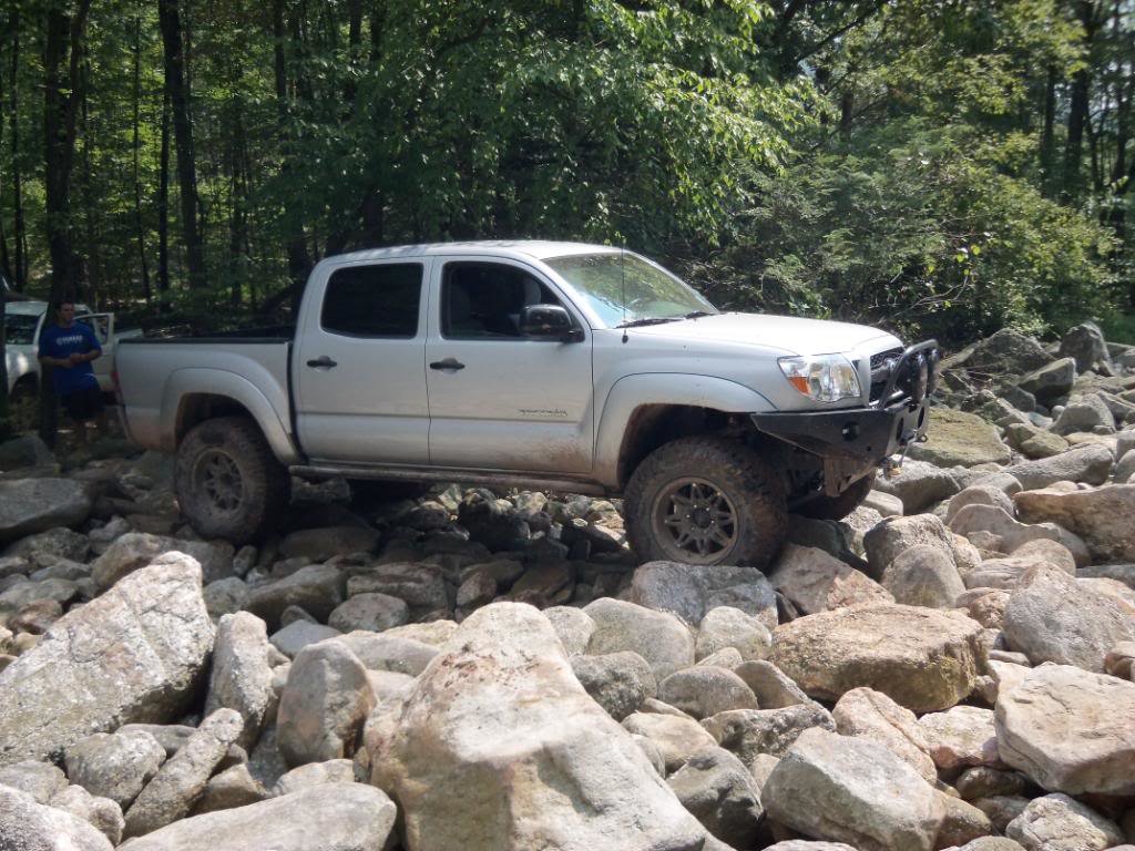

    Had an amazing time at RC this past weekend with the new truck. High centers are limited and very rare k-turns required with the shorter wheel base.
    Here are some pics. More to come.

    that first pic is awesome with the front pass tire up on that rock...

    That is a good one. Need to dig up more pics of that trip. I still have to get a pic of me on top of that big rock in the comp course... That's the bugger that got to me with the long bed. :sad:
